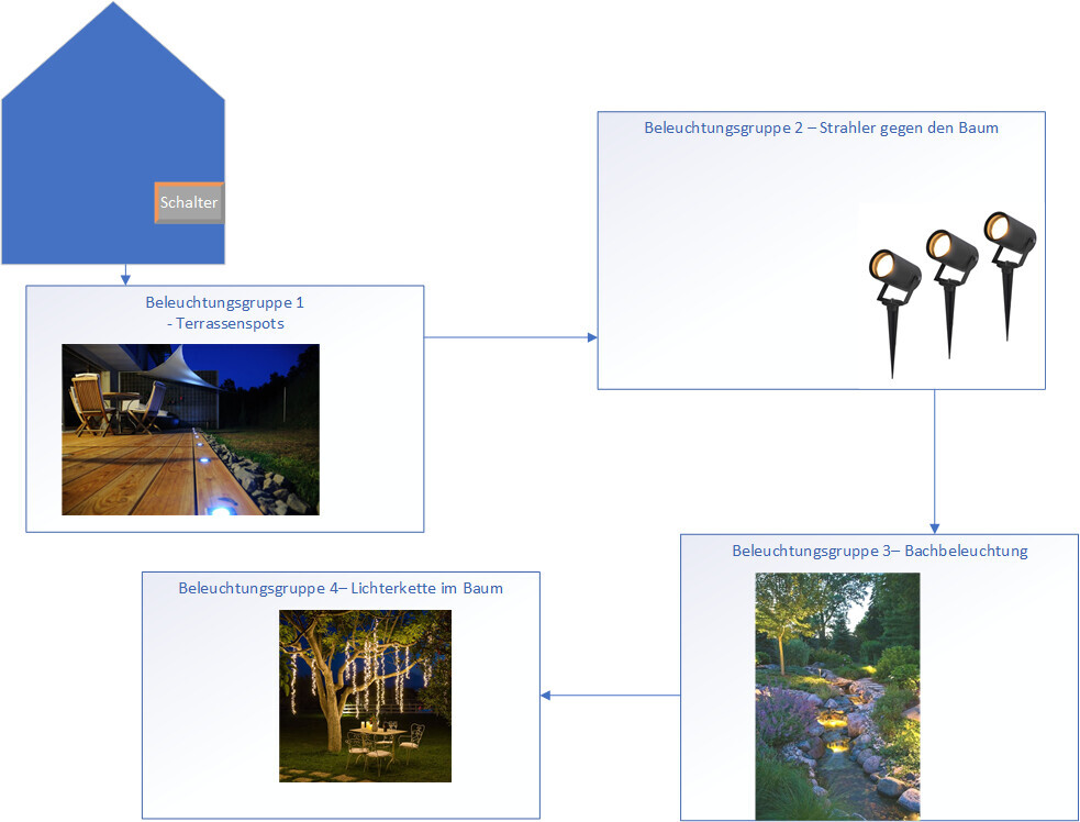

I am looking for ideas and suggestions regarding garden lighting in terms of electrical engineering and the possibilities that (smart) devices now offer.
Here is the situation:
According to the schematic shown in the image, we have a switch inside the house that controls a cable running outside to the garden. We already have some standard outdoor lighting in the form of several lamps around the house – however, this switch with the “flexible” cable is not yet in use and is specifically intended to provide additional lighting for the garden and/or the terrace. In this context, some empty conduits have been laid in the garden to bring power to various points (as shown in the image). Behind this cable, there are now (for example) 4 lighting groups. The type of lamps (LED strips, fairy lights, etc.) is still variable and should be considered only as examples.
In the simplest case, a cable is run through the empty conduit and the end devices are connected directly – consequently, the entire garden lights up at once when the switch is turned on.
Since it might be desired to switch only lighting group 3 at time A, and lighting group 2 (or corresponding combinations of 1, 2, 3, and 4) at time B, I am looking for ways to implement this accordingly. Control via smartphone and/or a separate remote control would be acceptable.
I would greatly appreciate your help! Of course, I am happy to answer any questions you may have.

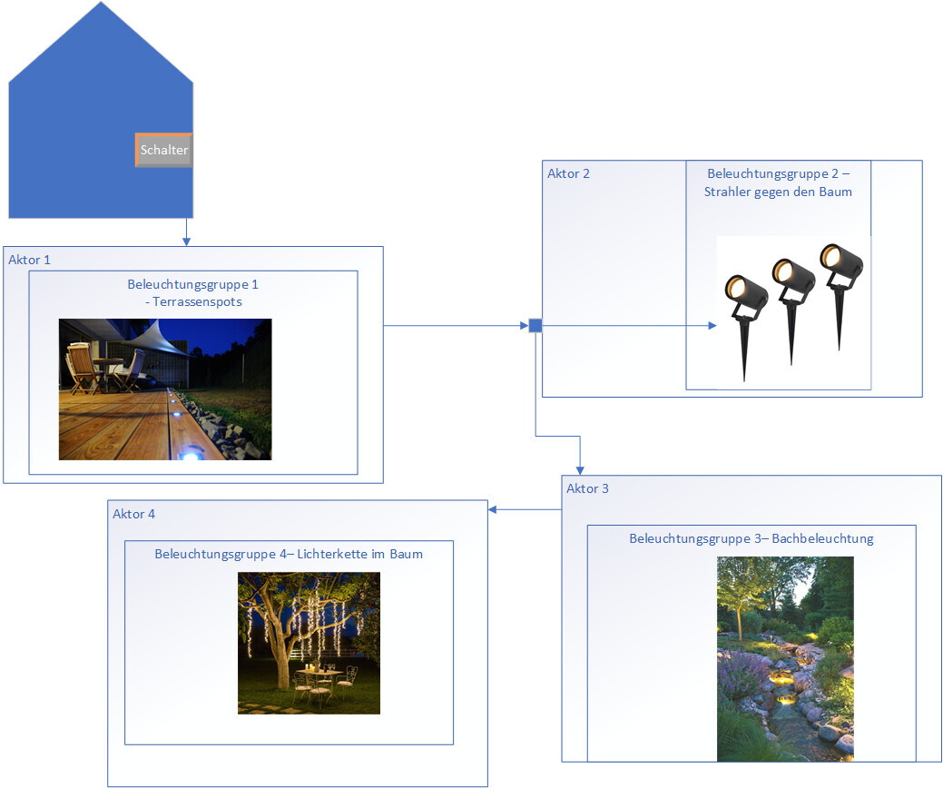

- I assume that when I press the switch inside the house, current flows through the entire circuit, and depending on the on/off state of each actuator, the corresponding lighting group is turned on or off. I revised the diagram accordingly – I hope my understanding is correct.

I assume that I press the switch in the house, so that electricity flows through the entire line accordingly depending on the on/off state of each That could work. Alternatively, you could install a bypass so that the garden has power permanently. Then place a Shelly device under the switch. Depending on how you program it, you can create a main switch that turns everything off, while still being able to turn everything back on via your smartphone.
