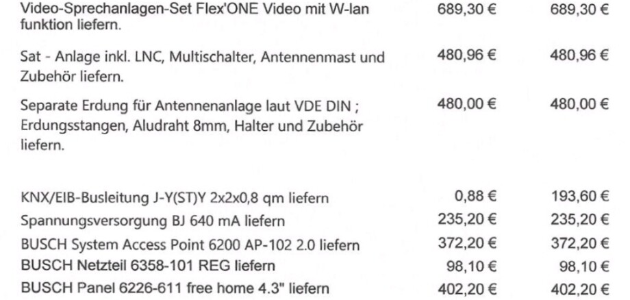

Which exact version are you getting?According to the offer, the following (see attachment).
I find the mentioned Jäger Busch welcome interesting, or the Balter EVO SILVER Video Door Intercom System 2x7" Touchscreen 2-Wire BUS interesting.
K1300S schrieb:
If you are already using free@home, it makes sense to also choose the BJ door station. Although it is still a two-wire system, it at least includes a wired IP gateway. However, I would still recommend planning for a network connection at the door.What exactly is the network connection at the door intended for?
