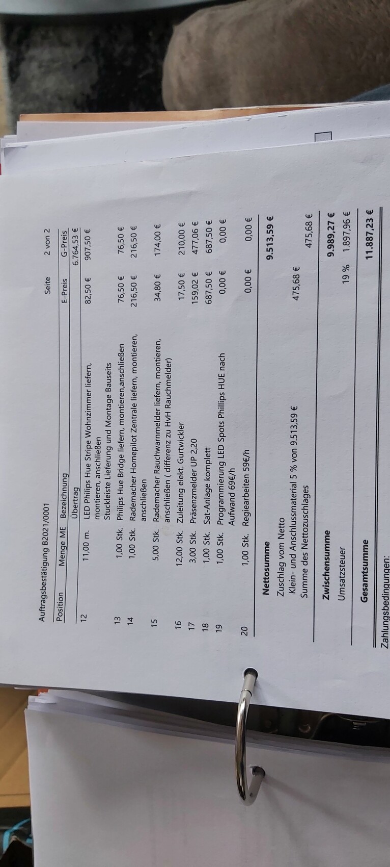

Home automation in our house is completely managed through Homepilot3.
What is smart?
- Roller shutters operate automatically in the mornings and evenings.
- If a window door is open, the roller shutters do not close thanks to the window contacts.
- A weather station detects solar radiation and adjusts the roller shutters as needed, and the heating is lowered. When it gets colder outside, the heating turns up.
- When the smoke detectors activate, the roller shutters automatically open.
- The system displays open and closed doors.
- Roller shutters can be controlled manually and also with Alexa voice commands.
- Hue lighting is integrated with the motion sensors; those familiar with Hue know what’s possible. Lighting scenes, among other features.
- The house can be controlled remotely via smartphone.
The total cost was somewhat higher, 11,887€ (approximately), see attachment.
For us, this was the most cost-effective solution compared to KNX.
