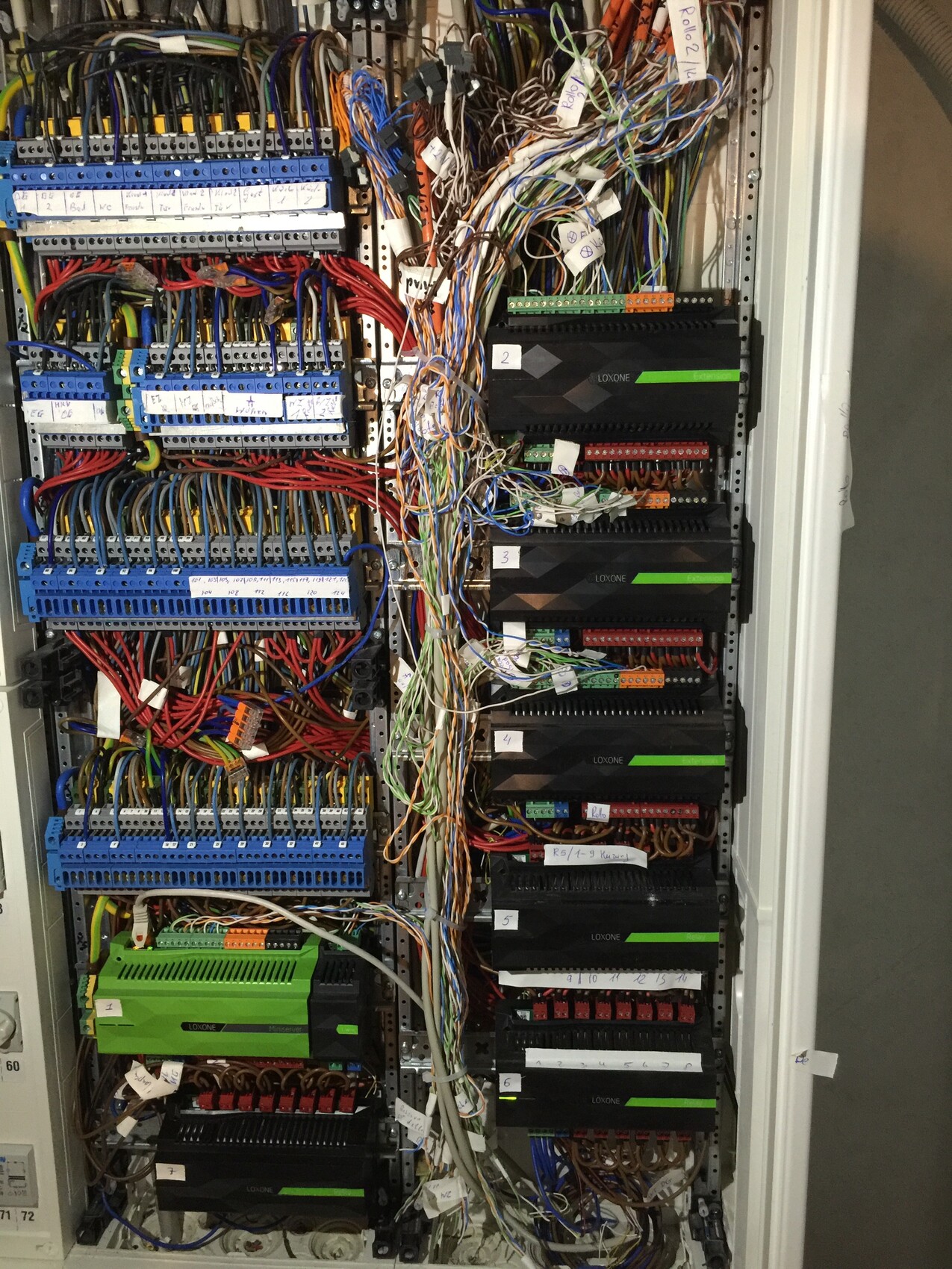

I have a Hager with 288te; unfortunately, I no longer have the exact model number of the cabinet.
I installed the following:
1 x Loxone power supply 24V/4.2A
1 x Loxone Mini Server
3 x Loxone Extensions
3 x Loxone Relay Extensions
1 x Loxone 1-Wire Extension
10 x Loxone 1-Wire temperature sensors
Altogether, this cost just over €3000 (about $3200) only for the Loxone components. However, this price already includes installation and wiring.
