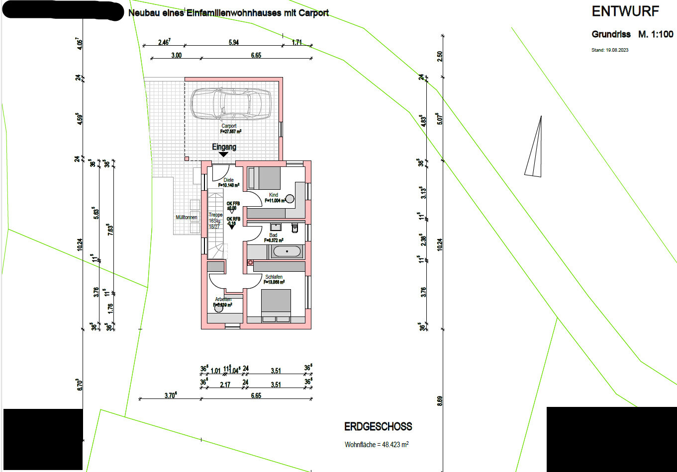

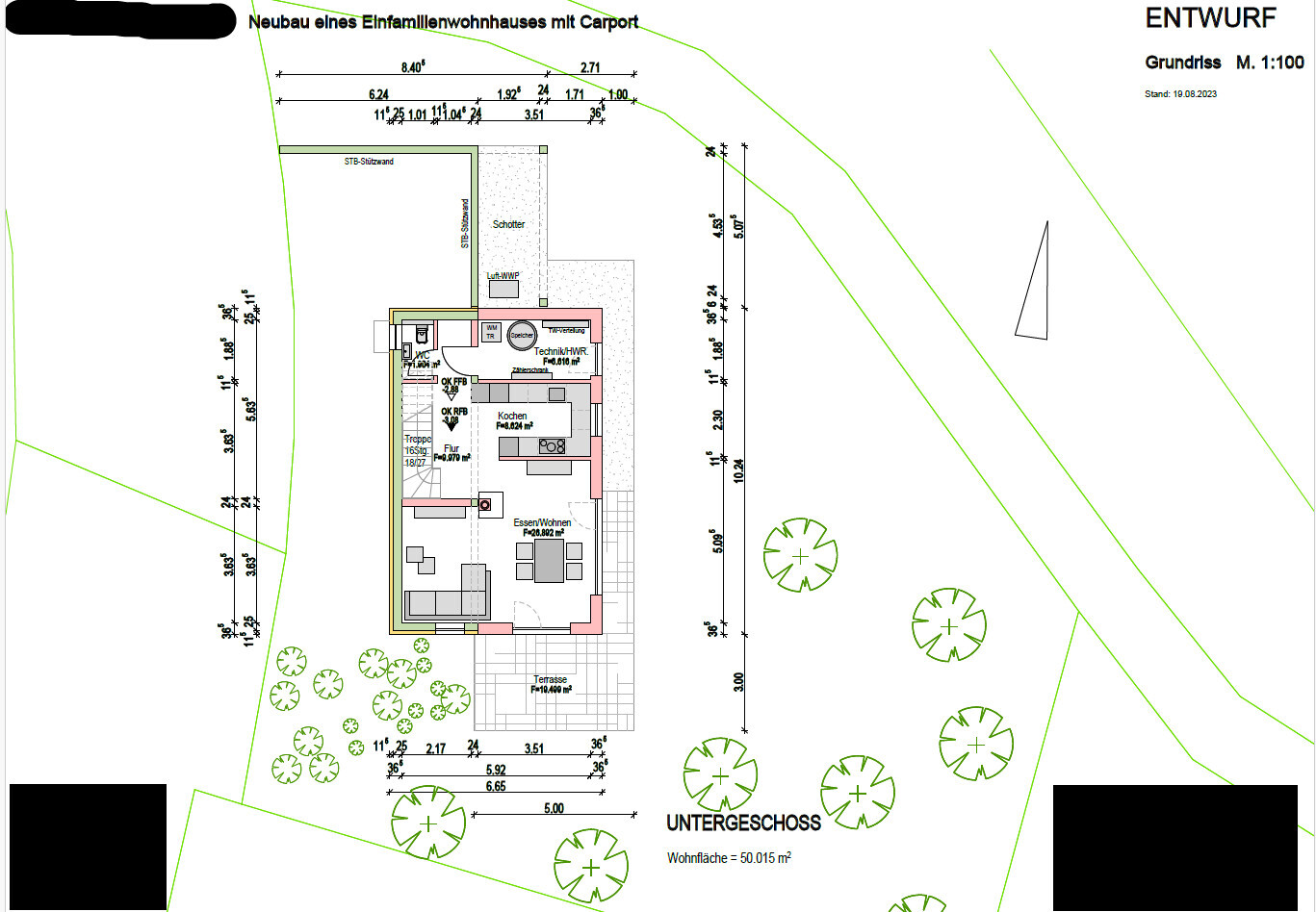

JuliaOne schrieb:
Hello Kati, I just admired your house. Mine will be only half as big. I also thought about squeezing the washer and dryer into the bathroom. I’ve thought about that too, but I wouldn’t know where to put them. The bathroom is already at its limit if you don’t want to give anything up. There’s no space left for a shelf for towels. Although, if necessary, you could mount something like that on the wall or similar.
It’s simply a matter of size, but for one person it’s certainly enough. Probably the laundry isn’t such a big deal then. I’m currently washing for four people, and one of them is 4 years old, so it feels like I’m washing for ten. 😉
I would really think twice about having a smoking room. Let’s say you want or have to sell the house someday — that could be a huge disadvantage. Smoke can’t be confined to just one room, even if that’s the only place you smoke.
Nowadays, most people are nonsmokers, and when they enter a house or room where smoking takes place, they notice it much more strongly than a smoker would. Even if you renovate before viewings, it’s not that easy to undo. The smell lingers very stubbornly.
My sister has been a smoker for years too. She’s actually been very strict about it in her own home so far. She goes outside to smoke but made her car the smoking zone. (I don’t want to go into the health implications of smoking in a car… better not 😉 )
Have you already talked to an architect or energy consultant about the cat flap? Are there cat flaps that meet current energy standards?
I am a fan of open-plan living and would remove the kitchen wall. Do you need the wall as a partition? If necessary, it could be a drywall partition, as it is not load-bearing. In that case, I wouldn’t plan a tall cabinet there. Space under the stairs could still be used for a refrigerator or sideboard.

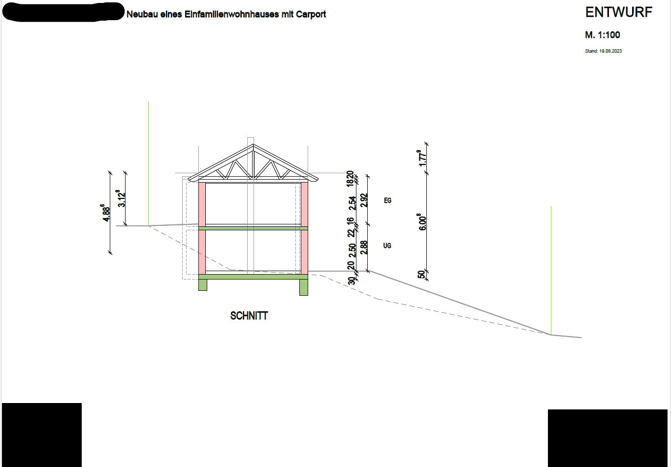

hanghaus202316 Sep 2023 09:57Did your planner start working without surveying the property first? There should be elevation levels on the site.
JuliaOne schrieb:
In the utility room, I want the door to allow for a cat flap and easy access outside for hanging laundry. If you want a proper passageway and space for the equipment, the room needs to be larger. If you omit the door leading outside, then the size would be somewhat sufficient, although careful planning is required and it’s best to check it daily yourself.
The issue of the cat flap should be discussed with an energy consultant regarding the building energy regulations.
kati1337 schrieb:
Washing machine/dryer stackedThis conflicts with the stairlift setup. If a stairlift is needed, the washing machine should stand on a pedestal, which cannot also serve as a pedestal for the dryer, as that would make it too high.Besides, a visitor already parks blocking the front door, so the carport would need to be wider.
I mentioned the topic of the cat flap; it was brought up by the architect, who is also an energy expert—no ifs or buts.
I want to use the wall between the kitchen and living area for a cabinet, as I don’t have much storage space. Under the stairs, there will be a built-in closet.
The plot has been surveyed, but I can’t attach that here yet—I need my tech-savvy child to process it first.
The washing machine and dryer setup needs to be reconsidered; I currently appreciate having a platform beneath both.
I’m the only one who parks in my carport; my child or visitors have to park on the street.
