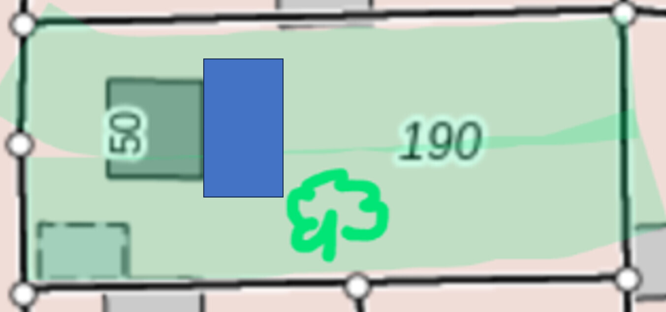

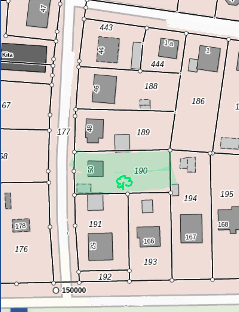

Attached is an oriented image of the parcel— the garage at the front has already been demolished, and the green figure is meant to represent a protected tree.
What would be your approach to this? What additional information would you need?

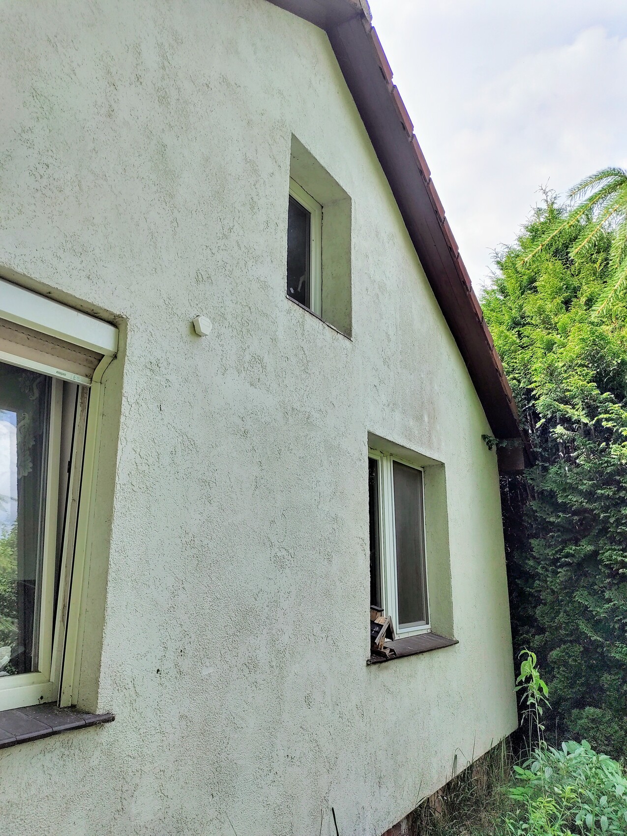

Maybe you could upload a picture to clarify whether it is a house or a cabin. After the 34er, you could still build larger. However, you don’t just demolish a house from 1996 without good reason. In the end, without an architect who can design an extension of a house onto or around a cabin, it will at least not be feasible from a planning perspective.

Hello ypg, the sunlight is currently unfavorable, so only part of the exterior wall is visible in the photo, but it is about a house. It was originally built for a single person, which is why it is so small.
