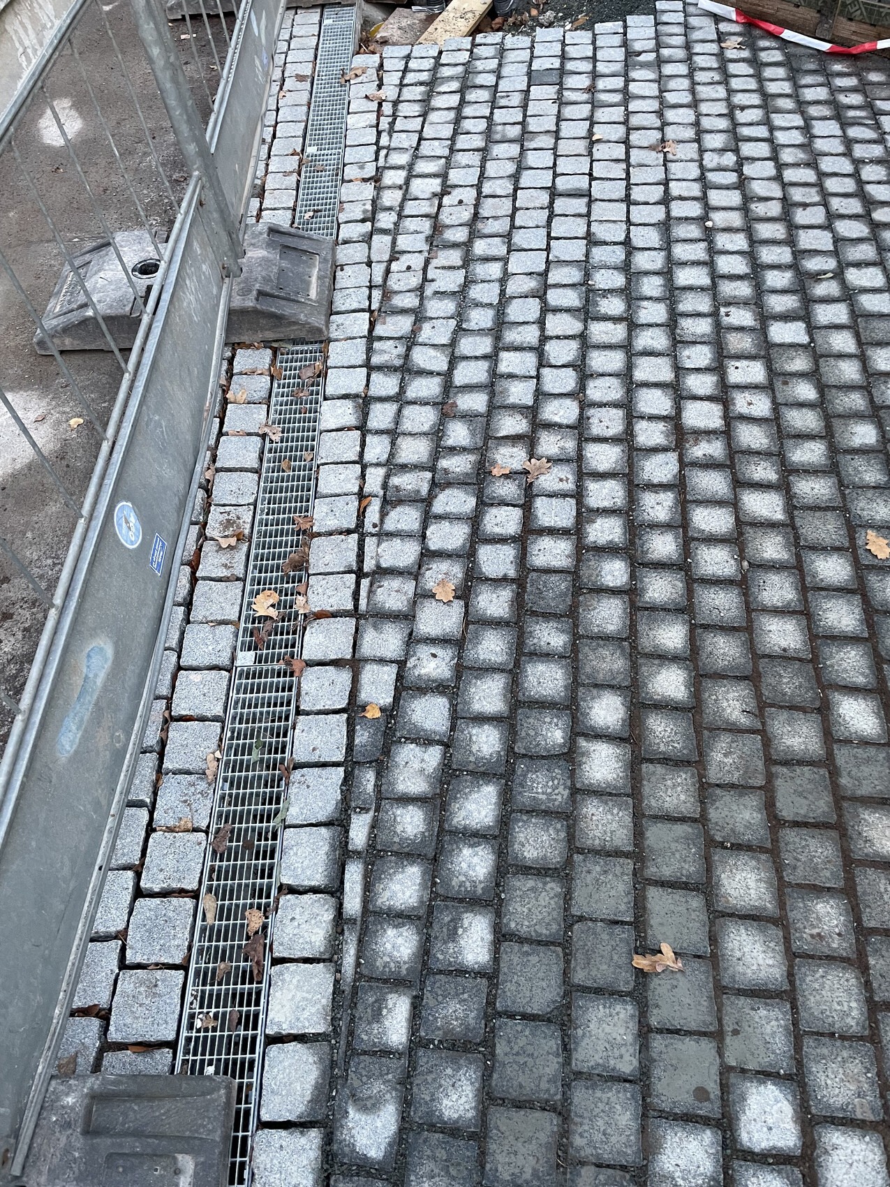

ThiasundLina17 Jan 2025 19:12Hello,
we recently had our driveway paved with granite stones measuring 10 x 10 cm (4 x 4 inches) in a running bond pattern by a landscaping contractor. The base layer consists of a gravel subbase, and the joints are to be filled with crusher sand. The entire surface will then be compacted using a plate compactor. At the connection to the street, there is a slope, so the stones need to be cut. In our opinion, this transition looks too irregular. Is there a better solution for this?
We are also wondering whether the drainage channel is really necessary. Since the small stone paving with joints should actually be sufficient to drain the area.
Looking forward to your opinions.
Best regards, Thias

nordanney18 Jan 2025 14:01ThiasundLina schrieb:
For our taste, the connection looks too busy. For your taste.
Is there a better way to do this? Yes, start straight at the street and then have the slope at the house or garage (wherever the paver started).
Also, we wonder if the drainage channel is really necessary. Since the small cobblestone paving with the joints should actually be enough to drain the area. When it rains heavily, you’ll see that the channel is needed. Water can’t disappear through the joints as fast as it comes down from the sky.
I think the work is fine. The look is achieved by using the small stones. It would look different with larger formats. And yes, the channel is necessary.
Nutshell schrieb:
It really looks ugly, but that’s just how it is now… deal with it, have a beer. I don’t think so. Honestly, who stands at the entrance of a property and stares at the stones? Let it dry and then take another look.
I also occasionally get bothered by so-called minor details, especially inside the house. We also have some granite paving, and if I looked at it that critically, I’m sure I’d have some concerns too, since our paver didn’t really know what he was doing. He only admitted that afterward, or when certain mistakes became noticeable later on.
The channel drain is certainly effective; if you want, I can send you pictures of heavy rain without a drain. Meanwhile, we’ve actually changed exactly for that reason.
I wouldn’t point it out everywhere, but THIS will fade from view faster than you think; save yourself the trouble if you can.

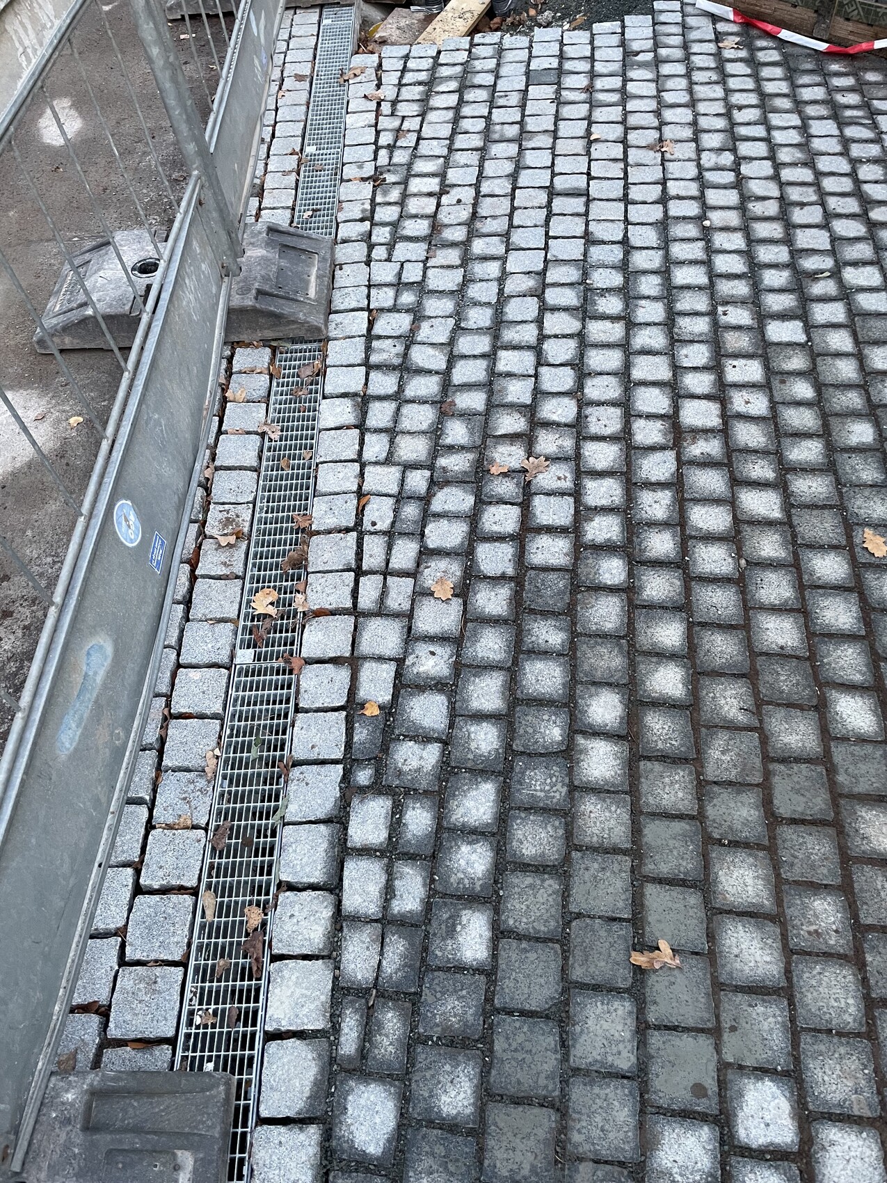

Steffi33 schrieb:
With just a few simple adjustments, the edge could be paved more attractively. I quickly made a rough modification in Photoshop. Maybe the contractor can take another look at it. In reality, it could probably be done even better.. It definitely looks better, but in my opinion, it’s not technically correct as shown. The paver avoided such thin strips as drawn in the image by the way he laid the pavement.
He will probably fix it for you (but you will have to pay), though that would be at your own risk. Or you could do it yourself in about two hours with a large angle grinder.
