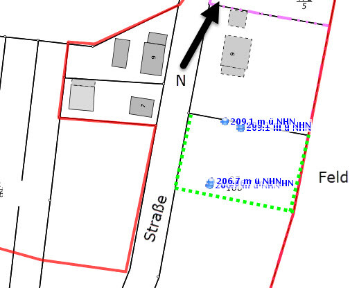

I have quickly made a small sketch. The plot is 1,100 sqm (11,840 sq ft) in size and slopes approximately 3 m (10 ft) over 25 m (82 ft) in a north-south direction.
The house is planned without a basement (to save costs), a modern villa about 10 x 10 m (33 x 33 ft). I still need to work on a site plan including the house and garage, but I wanted to check in advance what would make sense.
Thanks
Thanks
