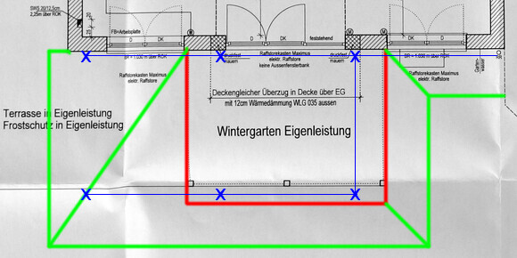

I am currently planning the terrace. A cold veranda with dimensions of 5x4m (16x13 feet) will be built there.
I have one problem: The base rails of the cold veranda itself cannot have any slope because of the sliding doors. How would you recommend designing the slope? The terrace next to it on the left side definitely needs a slope.
Should it be diagonal as shown in my attached picture? But that would be complicated since we have planned slabs with a size of 60x60cm (24x24 inches).
How is this usually done?

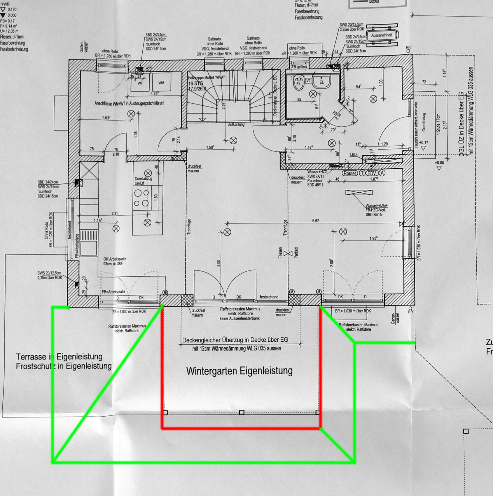

Floor plan with terrace and conservatory, colored outlines in green and red
A 45° angle radiating from the front corners should work best (caution – Pythagoras – the 45° refers to the edge with the slope!).
11ant5 Mar 2017 15:27
The green line is meant to outline the terrace, the red one the conservatory with the roof overhang, and the drawn window represents the sliding door (why not place it on the side facing the terrace dining area in front of the kitchen)?
I read about your pedestal idea in another thread. Could it be that you’re creating unnecessary work based on a misconception?
The conservatory only needs to be “straight” in the sliding door direction; it can have a slope across that direction (1° should be enough, otherwise the plates would tilt too much). But it should also be possible without any slope and with several floor drains, unless you are expecting monsoon-level rainfall?

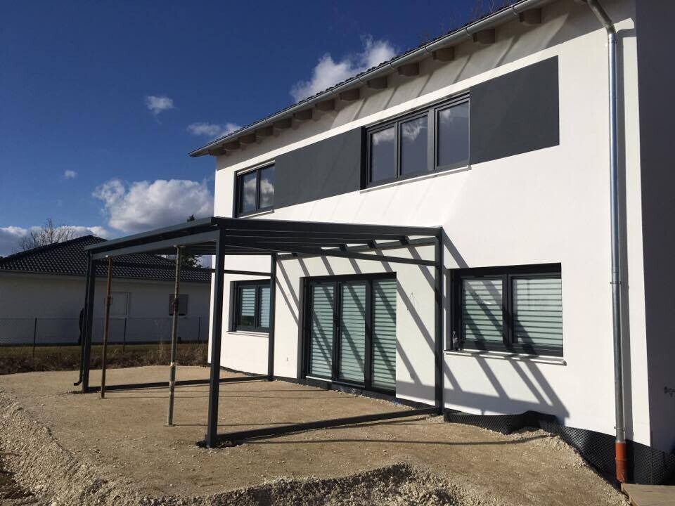

I’m attaching a picture for better illustration.
The cold conservatory will have sliding glass walls on all three sides.
I find the diagonal slope challenging with 60x60cm (24x24 inches) patio slabs. Therefore, the slope would need to run straight away from the house. Even with a 1% slope, I would have a 4cm (1.6 inches) step at the front, right?
Last year, at the start of construction, we had a storm with over 80 liters per square meter (2.3 inches) of rainfall. That gives the water considerable force. I prefer having the slope directed away from the house.

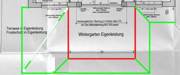

11ant5 Mar 2017 18:15
Floor plan with colored lines: green outer edge, red interior construction, blue conservatory/terrace.
