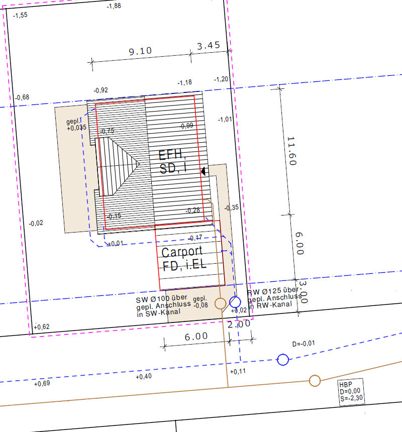

xpreisxHello,
the planner for our house does not consider a backflow preventer or similar device necessary and has not included anything like that in the drainage planning. The reasoning was roughly that if the plan is approved as it is, we wouldn’t need one.
We are complete beginners and would like to hear several opinions.
The finished floor level will be 5 cm (2 inches) above the “reference height point” shown in the attached drawing (drainage planning drawing). However, the fully developed street will be somewhere between 5 and 15 cm (2 to 6 inches) higher than the construction road.
We have a toilet and a shower on the ground floor.
Thank you in advance...
