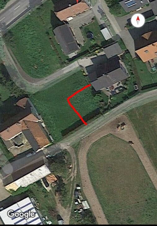

I marked the area in red where the slope is. If the soil is not poor, the earth could be spread over the rest of the property to ease the slope there (garden). North is also indicated in the attachment.

Oh yes. Everything beyond the hedge is a field, and it is flat.

Viewed from the front, at the back left near the hedge it is almost level (about 20cm (8 inches) slope).
That area seems generally large enough for a house, but it would be the rearmost corner. Please also draw in the boundaries and dimensions there.
