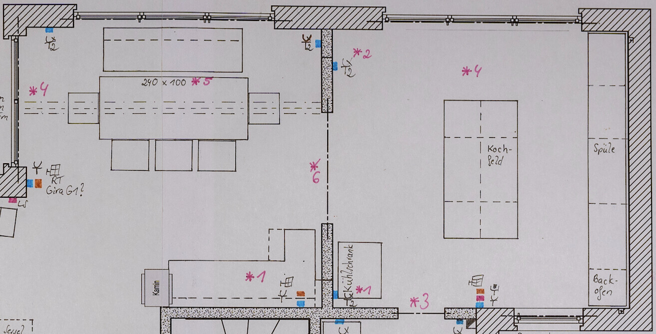

Thank you for the suggestions. Soft-close is noted and makes perfect sense. We also specially ordered that feature for our lift-and-slide door. Soundproofing is also a good point.
The door is necessary to separate the kitchen from the open-plan living and dining area. Usually, the door remains open but can be closed when cooking. We enjoy cooking, so this is a MUST-have feature. Regarding ventilation, we have deliberately decided against an exhaust system and opted for a recirculating option instead. This decision is final.
Okay. Currently, I see three solutions:
- Talk to the tiled stove builder to see if it might be better and even look good if the sliding door runs behind the tiled stove bench. This would also require a kind of drywall frame, but only on one side, with a depth of 90cm (35 inches) and a height of perhaps 1m (39 inches). Then the door would run a bit behind the backrest. Advantage: space feels larger; disadvantage: sliding door track would be visible from the dining and living areas.
- Partially enclose the sliding door with drywall in the dining area. Disadvantages: additional shell and build-up.
- Place the sliding door on the kitchen side without enclosure. Disadvantage: fridge must stand 6-8cm (2.4-3.1 inches) away from the wall to allow the door to slide behind it. No switches or sockets possible directly at the kitchen entrance.
hanghaus202329 Jan 2024 12:22I would cover the entire wall. Please share the floor plan with the furniture layout so that the situation can be understood better.
