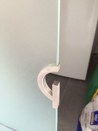

Doc.Schnaggls30 Aug 2016 15:32Hello,
we also have a sliding door that completely disappears into the wall.
Ours, however, is made of glass and has a handle that can also be operated from the "narrow" side. The handle is integrated into a recess at the edge of the glass panel.
This way, there is no risk of scratching the wallpaper or the door frame if you forget to fold the handle back before closing.
It looks like this:
Regards,
Dirk
