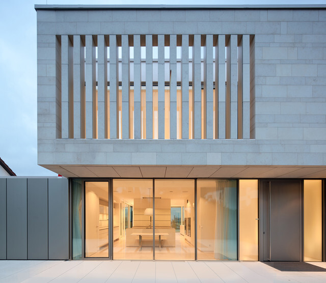

we are currently working on the facade design for a Bauhaus-style house. Does anyone have experience with stone louver structures in terms of practicality (windows), costs, or photos with additional ideas?
We mean something like the example attached.

Bauexperte5 May 2016 11:54In this picture, the slatted structure probably serves to shield a roof terrace from the view of others. It looks nice!
You probably won’t find much information about this in forums or from typical homeowners. It is a rather complex and therefore more expensive solution; regarding lighting, it doesn’t make much difference at first since it’s not placed directly in front of a window. In this example, it functions as privacy screening; the lighting comes from above.
Only highly skilled masons can accomplish this—any carelessness would be noticeable to the observer’s eye. Find the right specialist and it will work out well 😉

Traumfaenger6 May 2016 18:33Hello building expert,
Thank you for your reply! I didn’t expect that simply stacking a few stones straight on top of each other would be such an expensive challenge for the trade.
Best regards!
Best regards!
These
Traumfaenger schrieb:are actually a complex, reinforced concrete or steel structure clad with natural stone, including the also complex waterproofing system in the terrace area.
just a few stones stacked straight on top of each other
Traumfaenger6 May 2016 20:26Okay, then I take everything back. At first glance, it doesn’t look that complicated, but all right, I understand now 🙂
