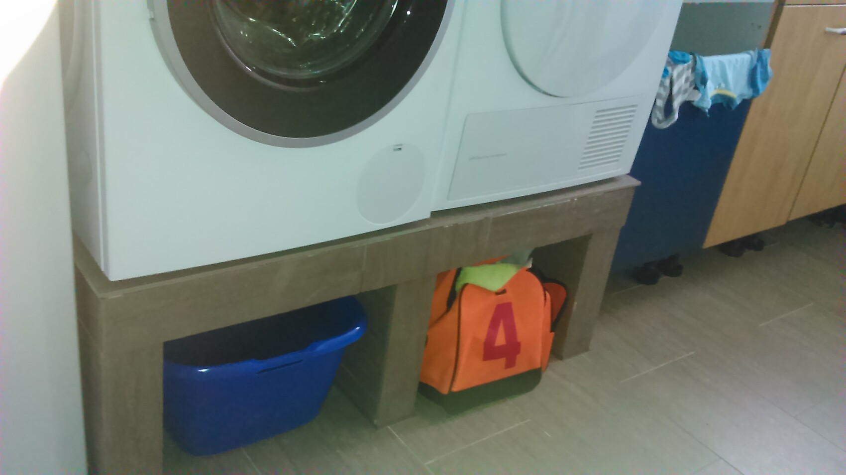

In our case, the feet of the platform are made of masonry (installed before the screed!) and the top slab is cast from concrete. Here is a picture.

Thanks for the photo! It’s really convenient to have the laundry basket right under the machine!

Regarding the height – my husband just said that the laundry basket still sits on the floor, so the higher the washer and dryer are placed, the higher I have to lift the laundry, and I still have to bend down just as far… When taking the laundry out, I could just let it fall into the basket, or are we overlooking something?

You still need to bend down to load the laundry, but in a different way. I always sort the laundry on the floor first, then lift it up from the floor into the machine. But it’s not as uncomfortable as having to squeeze it in so low, like we had before. And when taking laundry out, I use a stool that I place underneath, and then put the basket on it. This makes it really easy to load heavy, wet laundry, and then lift the basket up. Or the wet laundry goes straight to the freezer on the right.
