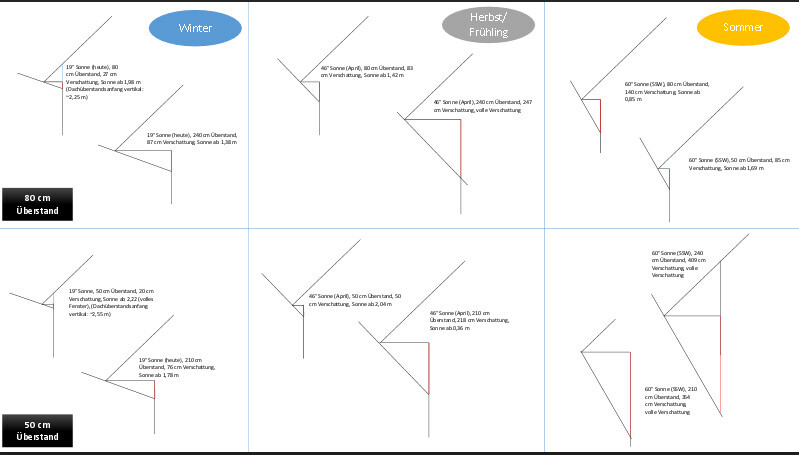

We tried to simulate the whole thing back then using the sun’s position and sun path diagrams.
For summer, one illustration should actually point upwards and the other downwards. Our issue at the time was whether to have a 50 cm (20 inches) or 80 cm (31 inches) roof overhang and, with the recessed building section, whether to have 2.1 m (6 ft 11 in) or 2.4 m (7 ft 10 in) clearance. We ultimately chose the smaller roof overhang so that we would get a bit more sun at the dining table during winter and spring. In summer, both overhangs provide sufficient full shading.
