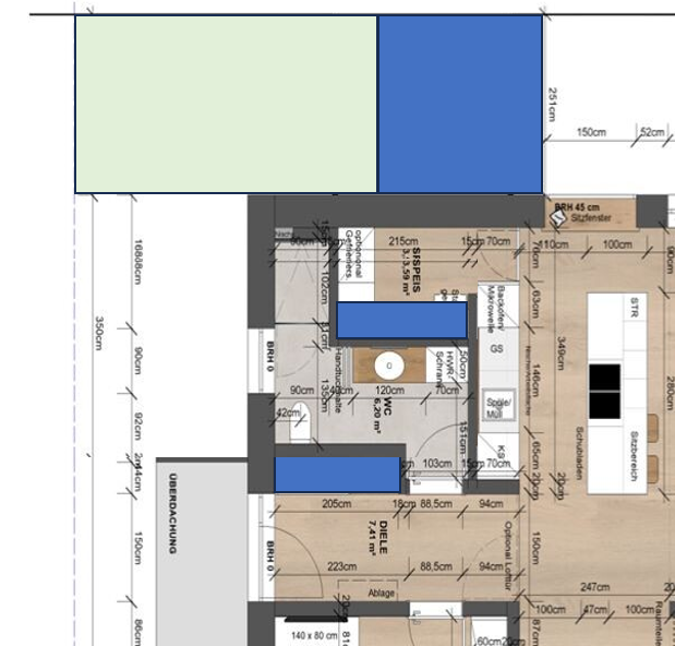

Here are my first changes.
Parking space in front of the shed. Shed slightly smaller.
A 60cm (24 inch) wardrobe niche is enough. This allows the bathroom to be moved slightly downwards, providing more space in the pantry. The shower is a bit longer. My robot vacuum only needs 40cm (16 inches). Then there is still room for a kitchen unit.
Upstairs, swap the bedroom and bathroom – bathrooms should ideally be planned one above the other.
Tilt-and-slide doors are not within the budget. Definitely reconsider. One door and the rest fixed glazing. In my opinion, this is also more practical.
The floor-to-ceiling windows throughout the house are questionable anyway. What does the energy consultant say about that?
Window seats are a bit of a trend. But do you really want that in the kitchen?
Without a basement, the budget might just be enough.

Here is the upper floor with a landing staircase. Why is the architect planning without it when this is your request?
Detailed floor plan of a residential house with bedrooms, kitchen, and hallways
The landing staircase can also be narrower, which benefits the bedroom and the office.
