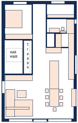

hanghaus2023
13 Nov 2025 13:42
Here is the ground floor plan quickly.
Two-dimensional house floor plan with living and dining area, kitchen, staircase, and bedroom
