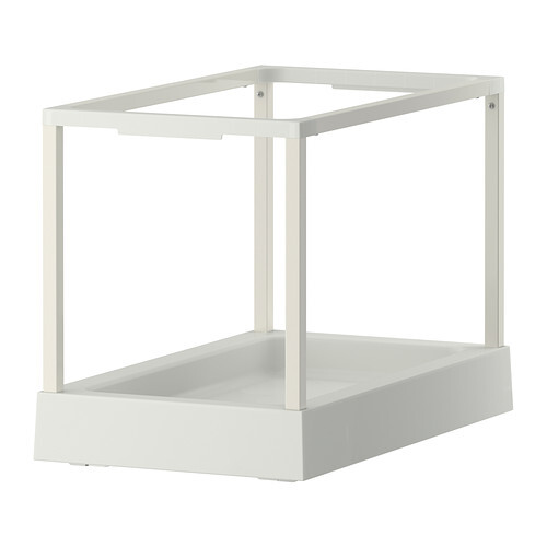

IKEA-Experte24 May 2016 18:43Hello, there is no problem installing a sink in the corner cabinet, unless the connections are located in the corner and you have difficulty reaching them.
Installing a pull-out waste bin is possible. It is easiest with systems that are mounted on the floor.
From Ikea:
However, it is located behind the door.
If the cabinet front is to be attached to the pull-out, there are alternatives from third-party suppliers.
If you want to use the Ikea system, some modification is necessary.
From Ikea:
