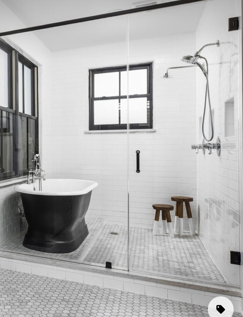

What don’t you like? Why? --- Only the bathroom on the upper floor we would still like to improve. Currently, the bathtub and shower are placed on the north side, which feels a bit cramped. We have always wanted a freestanding bathtub on the north side with a panoramic window looking north, where we have an unobstructed view of fields. Does anyone have an idea how we can arrange the bathroom better? This will be our main family bathroom.

If you want a freestanding bathtub there, the window will also need to be larger. However, I think a freestanding tub might still look a bit cramped. Maybe consider a built-in tub in the corner with tiled shelves instead? A freestanding tub could probably fit with a width of 2.60 m (8.5 ft), or maybe a wall-mounted option?
The shower would then either have to be moved to the wall by the stairs, with a glass panel as a divider towards the front and enough space to prevent water splashing to the sides, or it could go in the corner near the kids’ room. I don’t see many other options. But of course, it also depends on where it is possible to route the wastewater.
The current proposal for the shower and bathtub feels quite cramped, and the window is also somewhat small.
