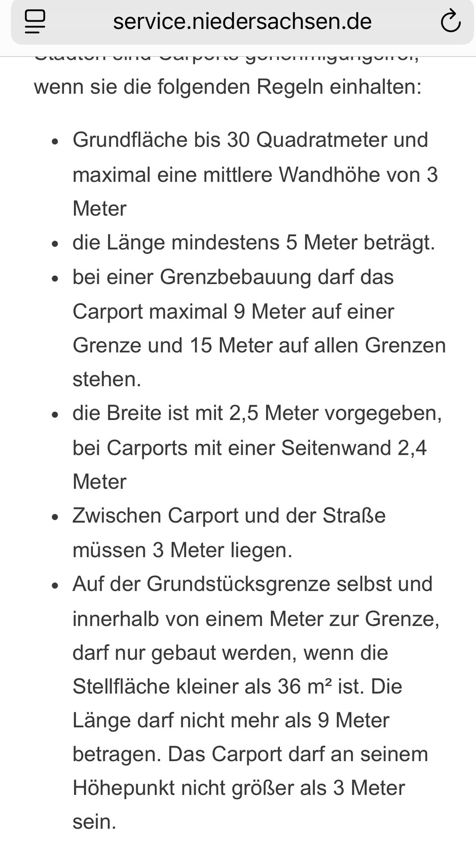

Garage 7x9m (23x30 feet) We’ve already discussed this topic: building on the property boundary is limited to 36 sqm (388 sq ft).

We’ve already discussed this topic: boundary construction limited to 36 square meters.Who plans like that? I just sketched a rough idea of how it should look...

Really? I think my neighbor built 8 x 9 meters (26 x 30 feet) right on the boundary...
Where I live, there’s no size limit, except for a maximum length of 9 meters (30 feet) along a boundary...
nordanney30 Jun 2025 11:10Buddy90 schrieb:
Really? I think my neighbor built an 8x9m (26x30 ft) structure directly on the property line... In our area, there’s no size limit except for a maximum length of 9m (30 ft) along a boundary... That is correct for Lower Saxony. This is stated in the building regulations (unless there are restrictions in the zoning plan).
However, there are plenty of other limitations, such as having to plant 10% of the area with specific types of vegetation. Gravel is prohibited — only necessary surfaces (parking spaces, paths, terraces) may be paved or sealed — the rest MUST be designed as garden or lawn.
So parking a car “somewhere” will not really be feasible. Beyond just living there, other desires will be difficult to implement.
Border building area limited to 36 sqm (387 sq ft). That does not really exist; at most 15 m (49 ft) of border building is allowed, with a maximum of 9 m (30 ft) in one continuous section; so effectively at both edges, approximately 54 to 56.25 sqm (581 to 606 sq ft) of ground area.
nordanney schrieb:
So parking a car somewhere is also not really feasible. Beyond regular residential use, other wishes probably cannot be realized. For everything else, the original poster would likely have needed a mixed-use zoning instead of a residential zone.
It might only apply to carportsNo, it specifically refers to the aspect of constructing a parking structure that does not require a building permit / planning permission.https://www.instagram.com/11antgmxde/
