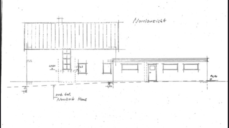

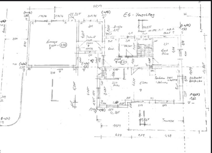

The floor plan drafts were originally drawn by our draftsman with pencil and paper. For this reason, we have redrawn them using the Magicplan app (allows furniture layout and 3D view).

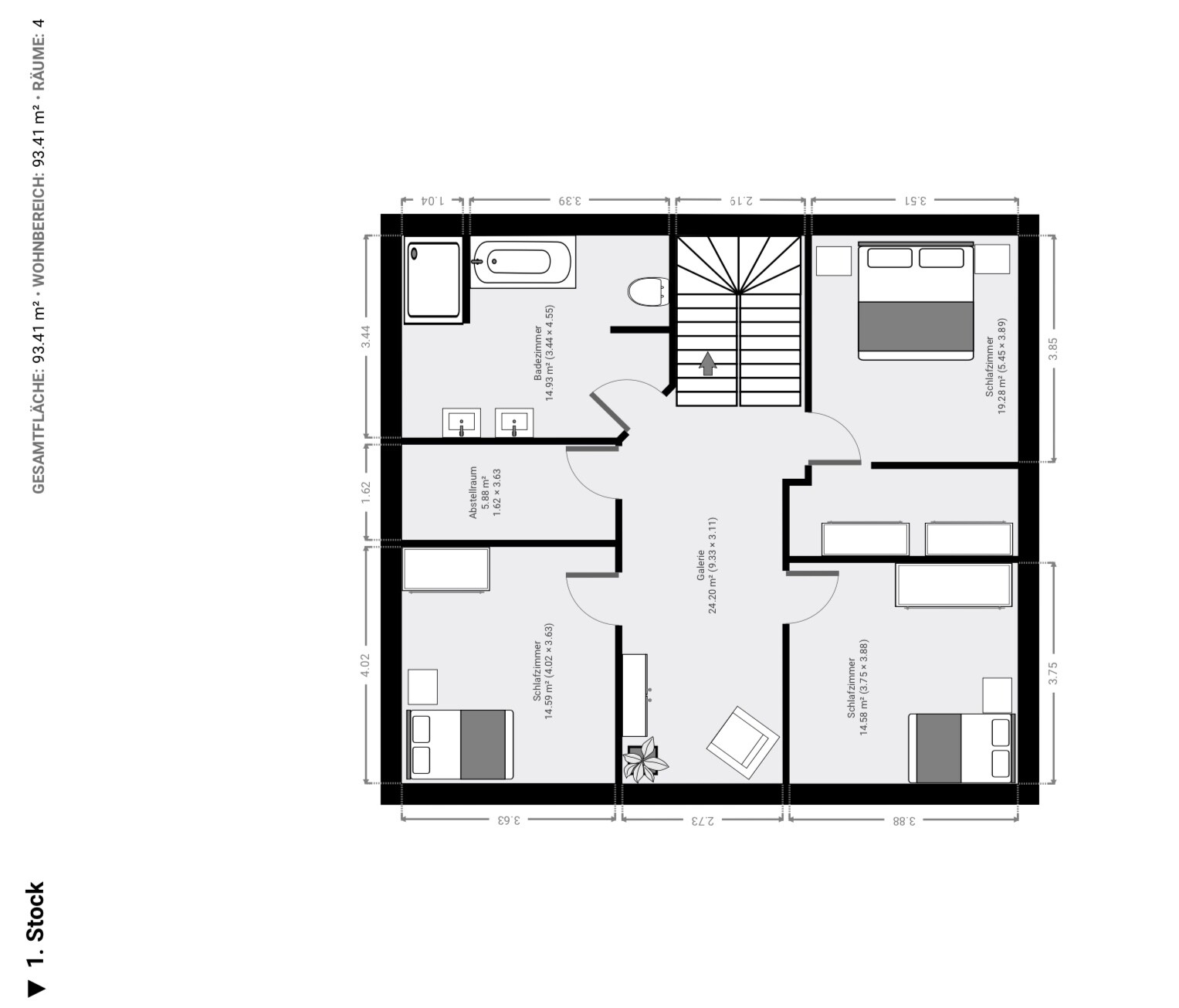

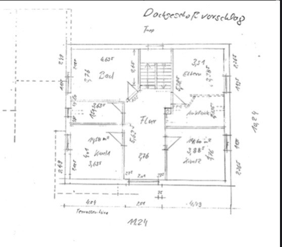

BBaumeister11 Jun 2021 11:55Overall, it makes sense. I would consider adding a second bathroom on the upper floor, specifically where the hallway is quite spacious. If you are a family of four and both children go to school, it can get tight when four people want to use the bathroom at the same time. This would also make the guest bathroom tidier, allowing you to skip the shower there.
If you want to include a full basement, the budget of 500,000 euros might become very tight. I would recommend building the fireplace as a masonry stove, as otherwise the corner tends to overheat quickly.
For our house (170 sqm (1,830 sq ft), partial basement, double garage, and fireplace), we paid 540,000 euros about three years ago.
Also, when considering the size of the plot, make sure to allocate enough money for the landscaping. The garden is not exactly small.

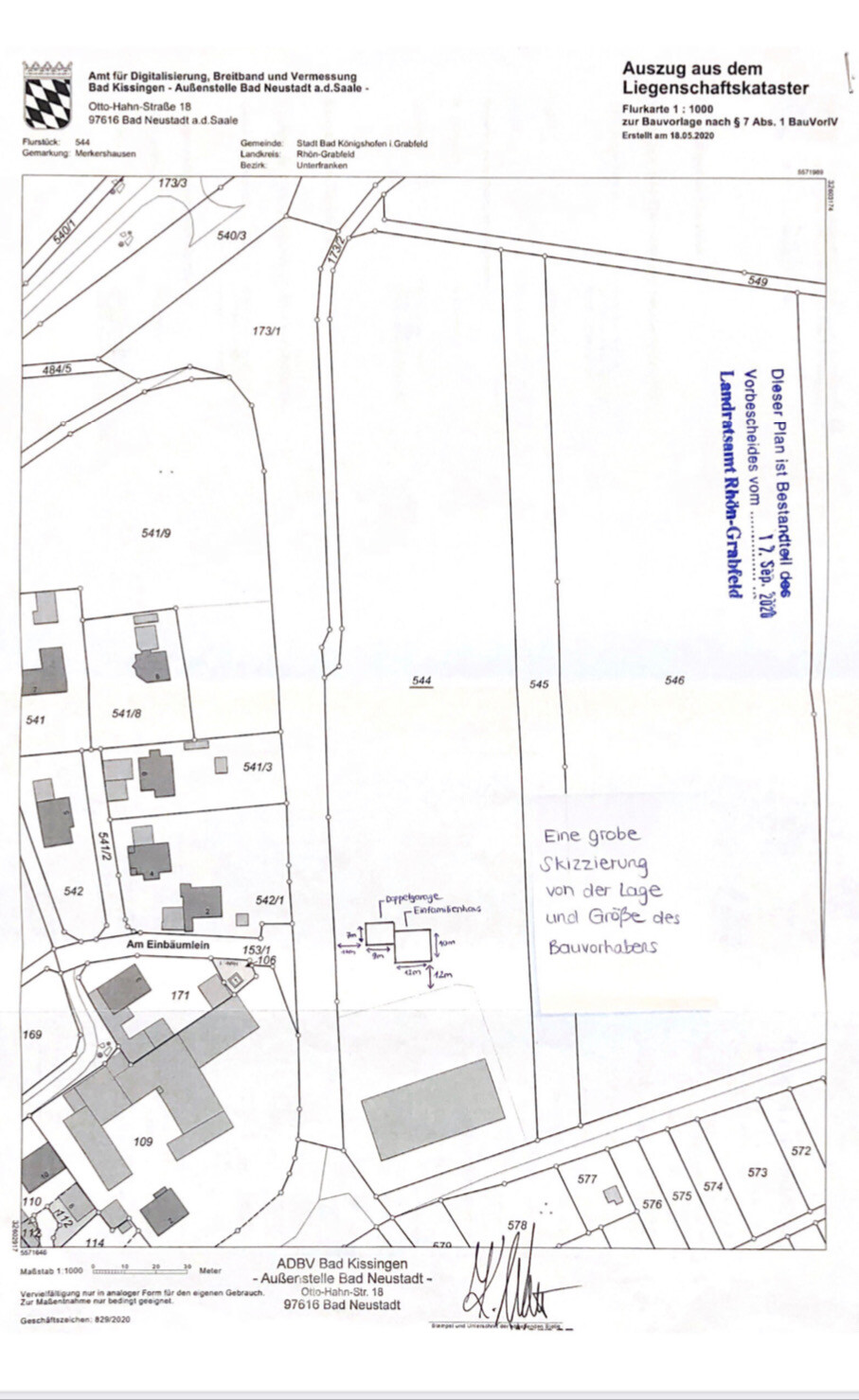

hanghaus200011 Jun 2021 13:01Why not have the driveway to the garage from the street? That way, you would have a nice west-facing garden.
At first glance, I like it. Very nice ground floor (especially if the entrance door to the open-plan living area is aligned with the stairwell).
I’m not fond of the first floor – I would adjust that a bit. However, the design doesn’t make sense to me in relation to the plot and its orientation.
Also, I can’t really make sense of the site plan without my reading glasses. Where exactly does the 1000sqm (10764 sq ft) plot end?
By the way, the gentleman forgot the chimney flue on the first floor.
Myrna_Loy11 Jun 2021 14:50I am mainly curious about why you are allowed to build in the outdoor area. 🙂
