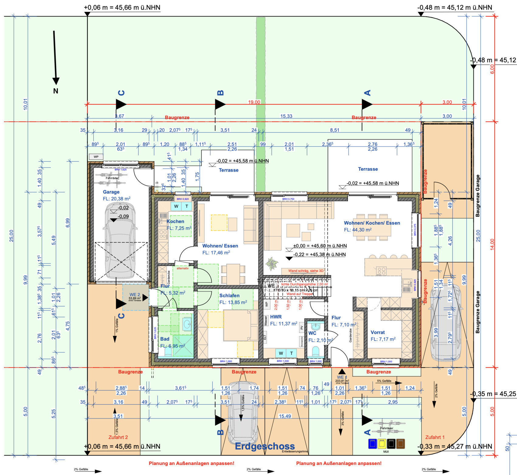

Ground floor: barrier-free basement apartment with bedroom, shower bathroom, living room, kitchen, optional small storage room (approx. 50sqm (538 sq ft)); main apartment: living-dining area, open kitchen, (small backup kitchen/pantry), guest toilet, utility/technical room

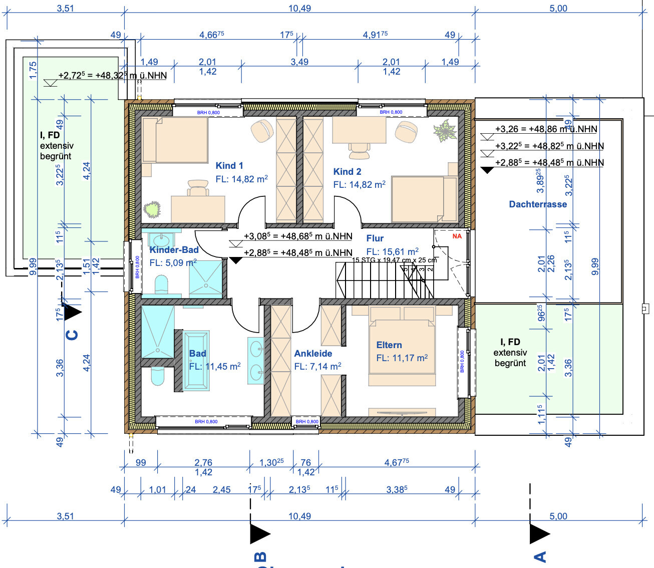

First floor: 2 children’s rooms approx. 15sqm (161 sq ft) each facing south, master bedroom with west-facing window plus a small dressing room, bathroom with T-layout accessible to all, children’s bathroom with shower

  • Living-dining area plus kitchen fits our requirements. We saw it in a show home and immediately agreed we wanted it like that.
  • The basement apartment is barrier-free, and the room layout basically fits well.
  • No complaints about the first floor:
    • Both children’s rooms are the same size (approx. 15sqm (161 sq ft)) and face south.
    • Master bedroom is in the (north-)west with a west-facing window.
    • Two bathrooms as requested.
  • Converted attic as extra space for home office, fitness, and hobbies.

  • The pantry (backup kitchen) seems a bit large.
  • The area around the staircase, door to the utility room, and guest toilet feels cramped and awkward.
  • We actually like the straight staircase, but it is completely hidden, so only the stairwell is visible.

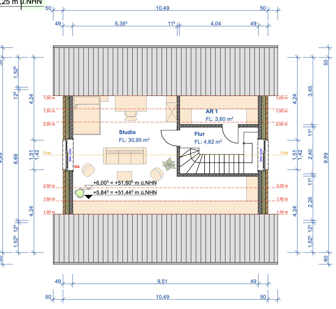

  • The attic staircase is placed on the west gable side; we would prefer it centrally placed or at least on the north eaves side.
  • No access from the basement apartment to the utility room (e.g., to do laundry).
  • Garden shed currently planned in the southwest; if anything, it should go to the northwest for garden tools and bikes.

Primarily based on our wishes, which were mostly implemented already. However, we are especially bothered by the arrangement/design of the utility room, staircase, and pantry layout—at least on paper—as it’s hard to imagine this part clearly.

Floor plan of an interior with studio, hallway, and staircase as well as furniture layout

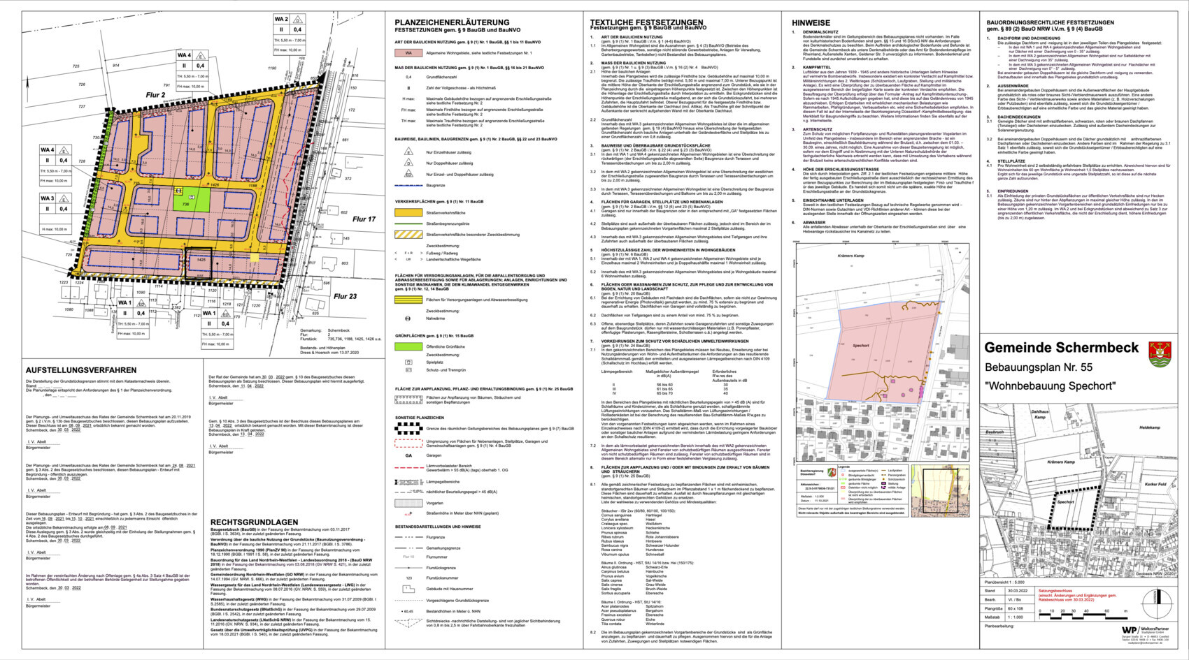

And of course the development plan including our plot.
Detailed floor plan of a house with children’s rooms, parents’ room, bathroom, and hallway
2D floor plan of a single-family house, ground floor with garage, terrace, and living area
Clear development plan of Schermbeck with plots and streets
