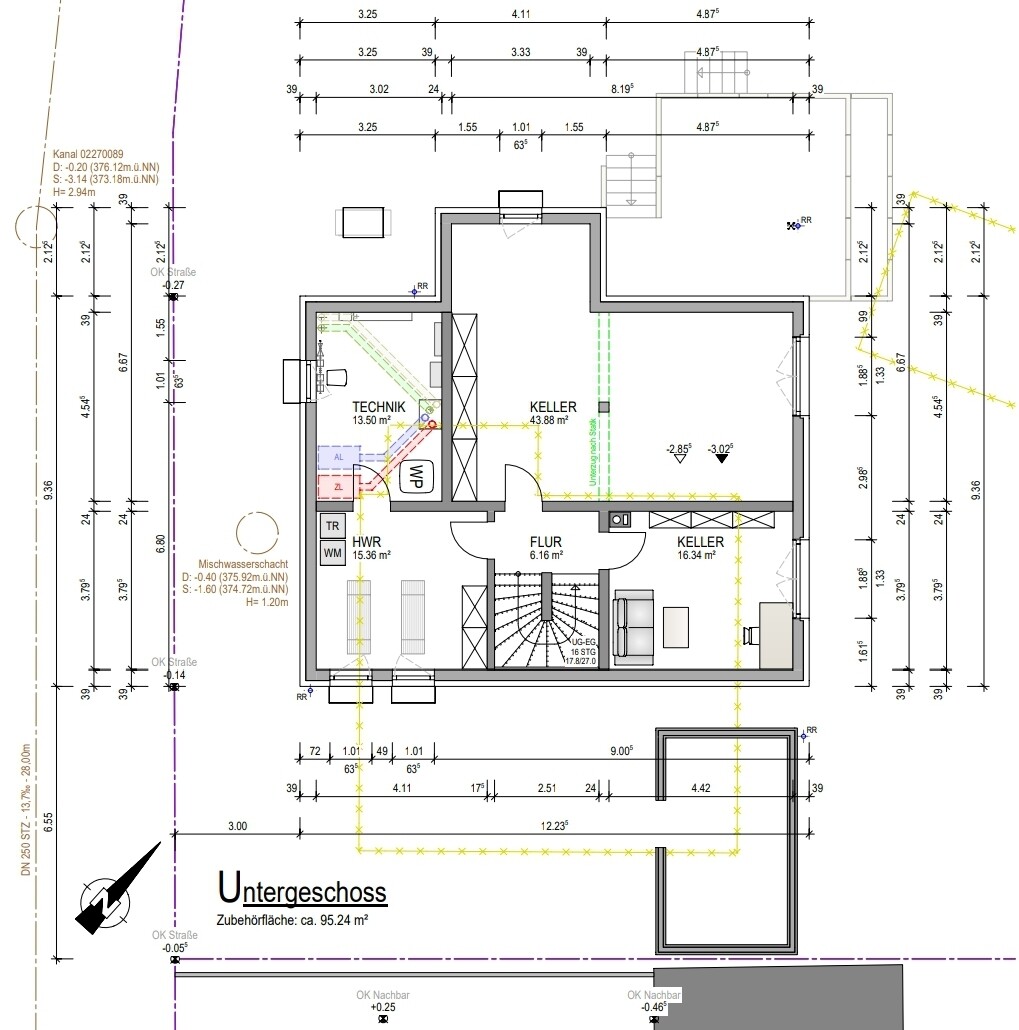

Basement, floors: (half “living”) basement plus 2 floors; this was a major discussion point: we also considered building more broadly across just two floors (+/- attic), but due to the slight slope, the engineer suggested a basement, and the building authority also urged “not to build excessively large,” which influenced our decision => we look forward to your opinions on this!

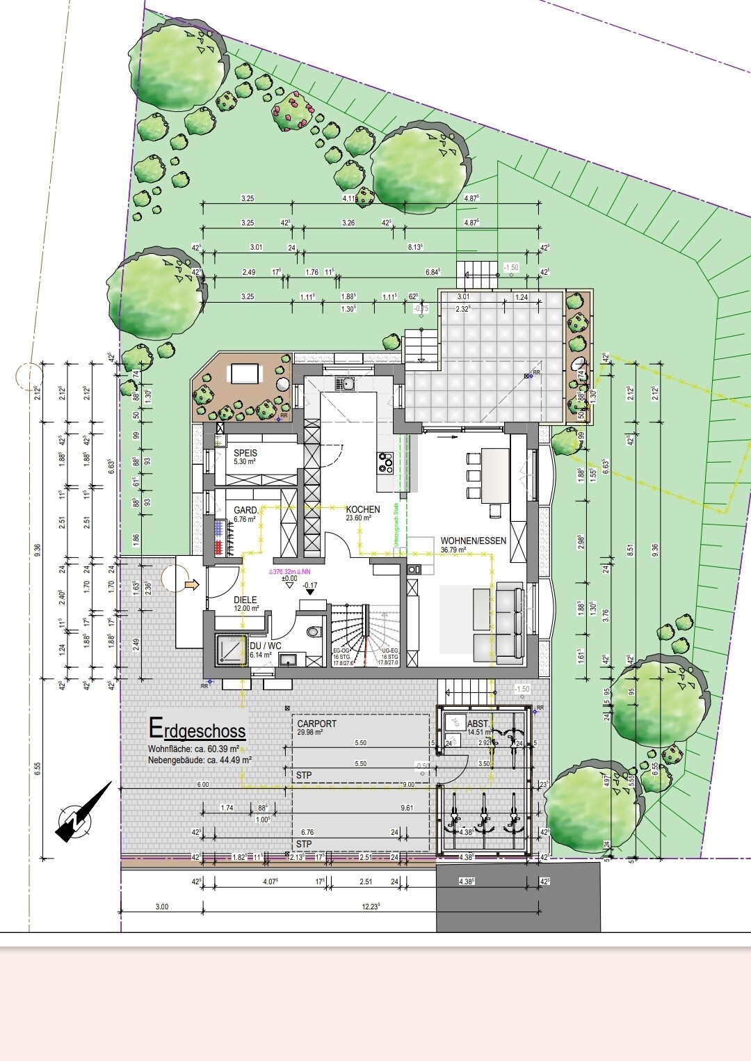

On the entrance level: cloakroom, generous shower bathroom, pantry (for short-term storage, possibly freezer, rarely used kitchen equipment, cleaning supplies, recycling bags for paper/plastic/glass, empties, etc.), large kitchen with open adjacent dining area for comfortably 6–8 diners (possibly up to 10+ on special occasions) and either a cozy living/TV room separated from the kitchen-dining area or a spacious office/guest room

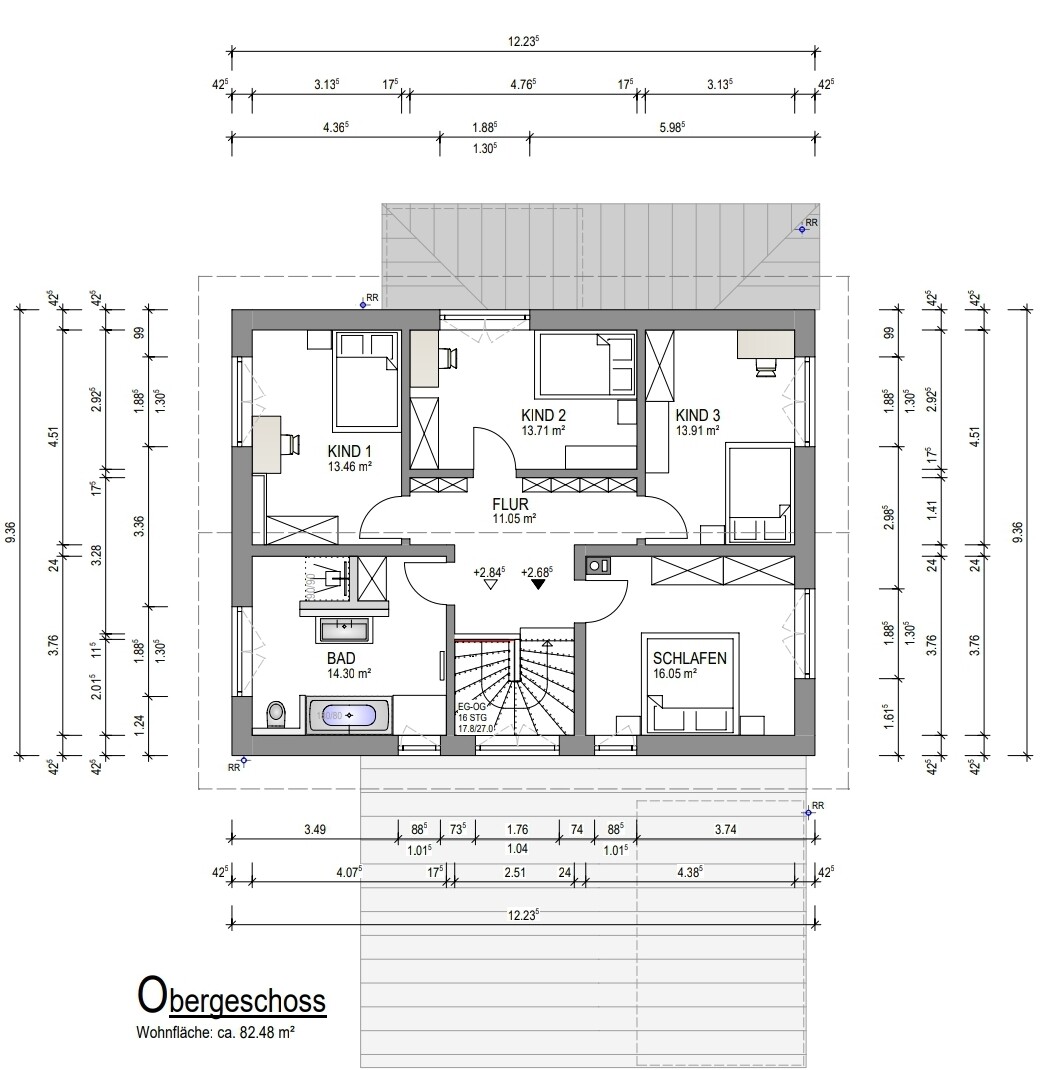

On the other floor(s): 3 children’s rooms, master bedroom, family bathroom (preferably with a T-layout or another solution that allows privacy at the toilet while someone else uses the sink/shower, but no separate children’s bathroom);

Garage, carport: ideal wish would be 1 garage and 1 large carport (space for 1 car, the whole family’s two-wheel fleet, possibly also trash bins) with an adjoining shed area (garden tools, grill, etc.); budget is a limiting factor here, so if needed, the two cars will be parked for some years on loose gravel outside — we will see what is ultimately possible...
Garden: extension of dining and play area, access via dining area (or kitchen). The next few years mainly terrace, children’s play area, herb beds and some fruit/vegetables; when time permits, more fruit/vegetable growing desired; currently there are some nice fruit trees and grapevines on the plot—anything that can remain or be successfully relocated during construction would make us very happy!

a) good: upper floor layout suits us very well (3 children’s rooms of similar size, parents’ room somewhat separate/closest to stairs <=> north orientation of kids’ rooms suits us too); ground floor has lots of space for kitchen/dining and living area; bay window and terrace roof look very nice (even though we initially said “appearance doesn’t matter, prefer simple = inexpensive building shape!”); cloakroom (for one of us a highlight); large office in basement and additional living room in basement; preliminary kitchen layout (the blue painted areas...); after simple furniture trials, except for the ground floor bathroom, we are very happy with the proposal, but unfortunately:
b) bad: we fear it is far beyond budget!
Also: ground floor bathroom a bit too tight => but cloakroom exists: broaden bathroom a bit and remove cloakroom niche next to entrance?!
Also: dining area OK but not especially airy and open.
No T-layout bathroom upstairs.
Children’s rooms have only one window each (apparently first budget cut; previously 2 children’s rooms had two corner windows and the middle one had a very large/wide window, which we liked a lot!).
Lots of built-up area => possibly shift carport toward street (so no additional 2 parking spaces in front of the carport on the plot; visitors must park on the street)?!
Office has only one window <=> a second south-facing window should be possible, especially if the carport shifts toward the street...
And last but big: garden/terrain—the various levels (west garden lower than terrace, east garden much higher than original terrain) and the slope cuttings along almost the entire boundary don’t please us <=> our idea would be to zone the garden into 2 levels: in the west/street side at about street level and fairly level with the terrace, and in the east of the house at the level of the lower plot boundary; the height difference would be taken up at the south behind the carport/storage and at the north near the terrace <=> is this realistically doable or are we totally mistaken? What ideas do you have?

Regarding the corridor upstairs: should the small alcoves be added to Children 1/3 rooms or does it make the corridor feel more spacious if these pieces remain with the corridor? Is the corridor bright enough?
Is the staircase to the lower garden level at the south/by the carport really needed? We considered removing it and instead moving the house further south; what do you think?
Is the carport wide enough for 2 cars at all?

  • Basement removed; ground floor becomes walk-out basement.
  • Bay window removed.
  • Wardrobe becomes the utility room. Pantry added to utility room.
  • Storage room placed under the stairs (no longer possible to store basement under stairs).
  • => this brings it roughly to about 170m² (1800 sq ft), so it’s already tight. With some DIY effort, the bay window might be possible again.

In my proposal, the pantry would be moved under the stairs, and the wardrobe area would be very small.
In addition: A small storage room upstairs would also be good. The bathroom is big enough to sacrifice a few square meters, but I’m not sure how best to position it.
Regarding the upstairs hallway: shouldn’t the small nooks better be added to Kid1/Kid3’s rooms, or does the hallway feel more spacious if those bits remain hallway? Is the hallway bright enough?
Brutally put: Assigning those nooks to the kids’ rooms would create dead space. You can’t use the door areas inside the rooms. And where the doors currently open to the rooms, that’s circulation space and can’t be used.
So I’d leave it as is.
Is the carport even wide enough for 2 cars?
Depends on the cars and driving skills. 5m (16.5 feet) is quite tight.

In the end, the structural engineer recommended a basement mainly because of the slight slope, and the building authority’s advice not to build anything "excessively large" also influenced our decision => we’re eager to hear your assessment of this!
Why, I wonder... a nice functional basement is no problem for him, but making something useful out of a slope is not. That worries him and requires a bit more brainwork. Why bother, if you can have a basement that’s basically useless? Then make the client like the idea of an extra room with "living space quality." That’s certainly legitimate.
What does "excessively large" refer to? Nearly four stories? Basement, ground floor, first floor, and attic? I would consider that excessively large!
Additional space: 95 m² (1,023 sq ft)! Ninety-five! If that’s not excessive.

Costs without benefits. 28 m² (300 sq ft) dedicated to something others manage with 15 m² (160 sq ft). Over 40 m² (430 sq ft) extra space, and upstairs in the first floor they’re queuing for the bathroom. Then there’s the many steps in the garden: 2 or 3 steps are fine, but it’s better without a basement that creates a barrier at the ground floor level.
Noxmortana schrieb:
Where do you see potential for savings? Where do you think floor area could be cut?
Basement
