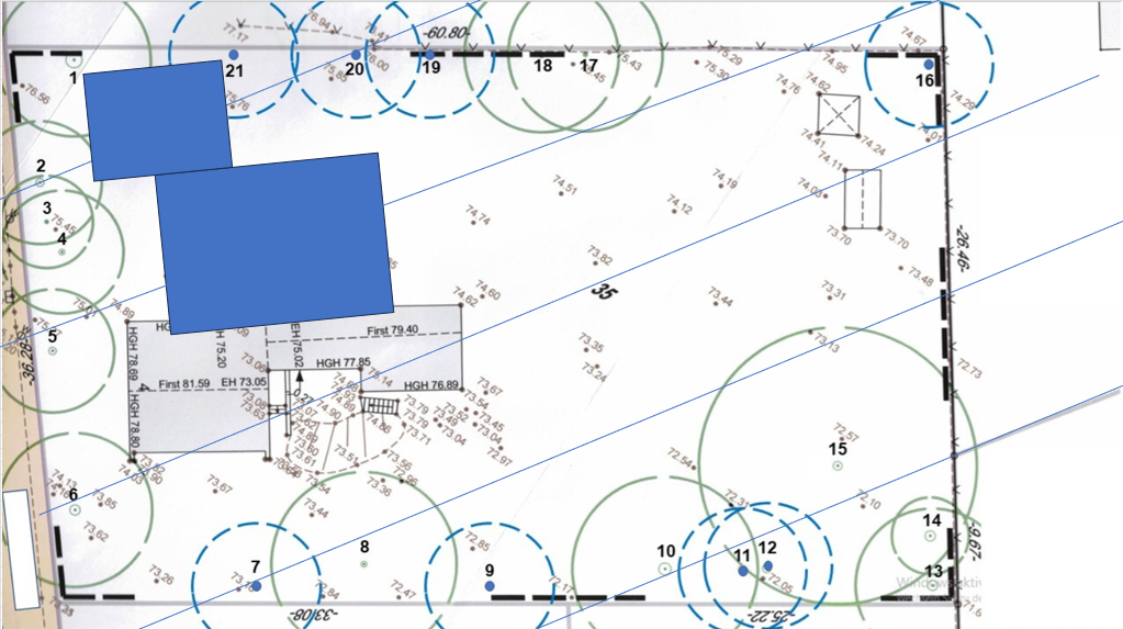

hanghaus20234 Nov 2025 10:00I roughly sketched the contour lines to better understand the plot.
The terrain has about a 10% slope. The road is slightly less steep.
The previous owner probably built along the slope. For example, the house is narrower and follows the contour line, which in my opinion makes more sense.
For two people, I would recommend a bungalow with a living basement.
Is the house still standing? If yes, please share some pictures of the existing building.
Could you briefly explain what the architect has planned? Possibly also where on the plot.
Have you shown your design to the building authority / planning office? Otherwise, I would recommend a preliminary building inquiry, as I don’t think you can prove the single-level layout.
The existing survey shows what is desired.
