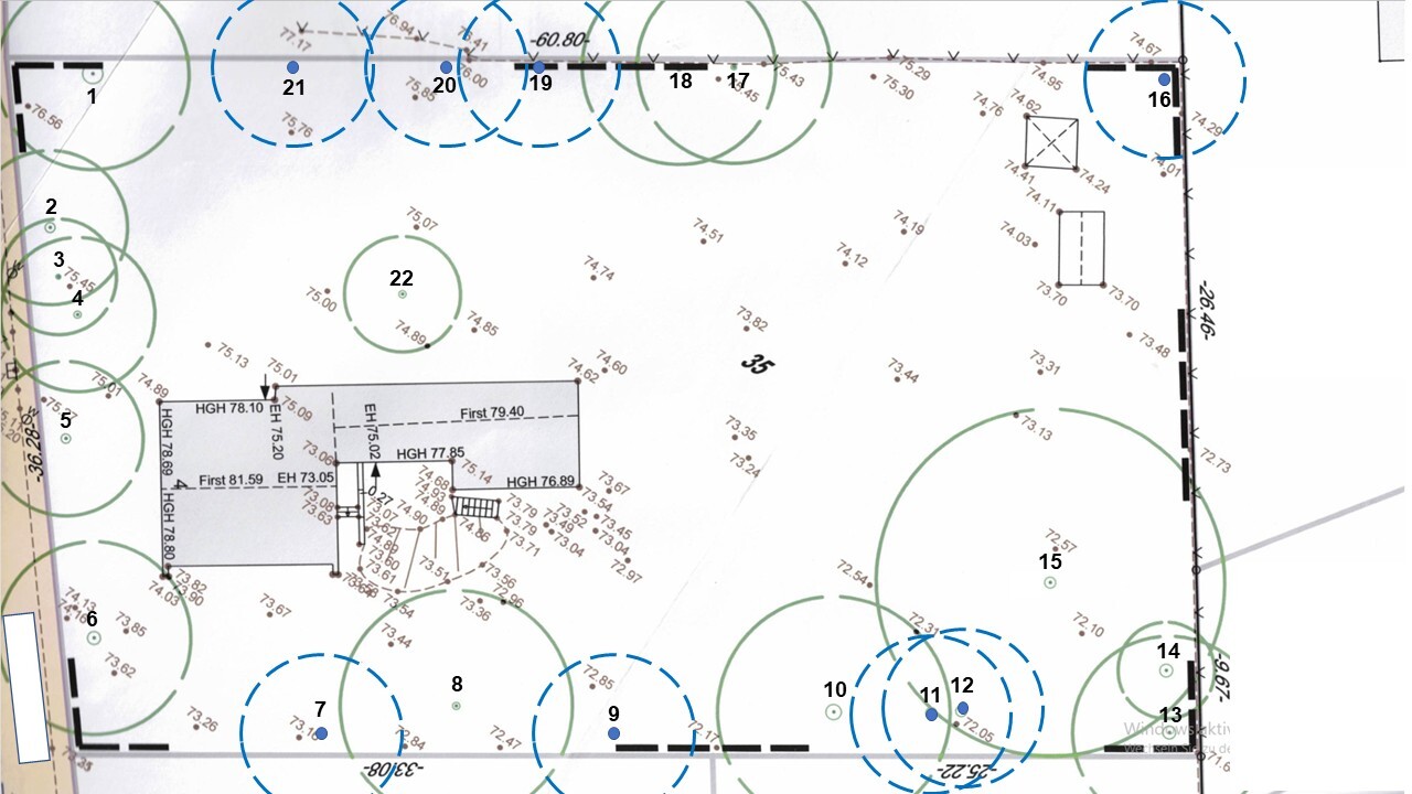

Attached is a site plan with the elevations.

From the street to the carport, it is about 8 to 9 meters (26 to 30 feet). The street is about 60 cm (2 feet) higher at this point.
Utility lines are only electricity, water, and cable. They enter under the front door and there is a built-in cabinet or similar inside. Wastewater exits under the door of the granny flat and then goes to the street.
I have commented on the structural design for 11ant.
I will probably place the bathroom in the basement inward because an external bathroom requires a larger hallway and therefore takes up a few square meters of space. I probably won’t use the bathroom myself. Still thinking about it...
The area around the basement stair entry is indeed small; the architect had it even smaller and added doors in all directions. I will enlarge it a bit...
The windows next to the entrance door don’t need to have clear glass. The front yard is large, about 9 meters (30 feet) to the street, and you could place the sofa against the outer wall and the TV on the wall facing the guest WC/bathroom.
All doors are 89 cm (35 inches) wide.
The architect also wanted to make the window on the right side facing the neighbor larger. But there are only 4 meters (13 feet) to the neighbor.
I like the visualization; however, it is not an architectural tool, so maybe the viewing angle is somewhat unfavorable.
I trusted an architect, but it didn’t work out very well.
The garage is located on the north side and should be a large double garage with a door at the front because we use bicycles a lot. Also, I don’t want to go straight into the house with the dog in bad weather.
To the south would be the right neighbor, which feels too tight for me. I want to look into the garden and only let enough sun in from the right side. Otherwise, in front facing the street, there is an area connected to the living room where the afternoon sun can come in.
