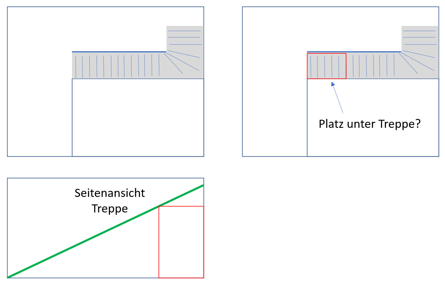

And a shower under the stairs was just a typo? Well, that’s a relief No, that wasn’t a typo, but rather an idea I wanted to explore here.
The idea: a concrete staircase, under which there could be enough space from a certain dimension to use as a shower.
In some floor plans, you often see the space under the stairs used as storage—so why shouldn’t that be possible here? Not the entire shower fitted underneath, but making use of some of the space.
Maybe this sketch helps (proportions are not accurate!):
On the left “normal,” on the right with the red box is the idea. The side view is meant to clarify the area again.
The question was whether something like this is possible and whether it makes sense.
For various reasons, I would consider this rather impractical.
- You would need to design your entire floor plan around having the bathroom in that specific location.
- As you have drawn the staircase, the hallway would be at the top of the plan, which means the bathroom would practically have to occupy the entire lower half of the floor...
- Typically, a wall is required on one side of the staircase.
- The free space underneath the stairs is generally larger than a shower, so using it as storage space or for a built-in closet is more space-efficient.
