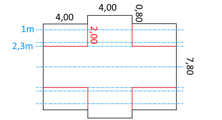

How exactly is the 75% of the upper floor calculated in relation to the sloped ceilings?
Floor plan of a rectangular room with two interior cutouts; dimensions: width 4.00 m, 1 m, and 2.3 m.
For the Auro on the website (estimated knee wall 50cm (20 inches)), the following calculation applies (dimensions estimated as not shown):
Ground floor footprint: 7.80m * 12.00m + 2 * 4.00m * 0.80m = 100m² (1,080 sq ft)
Upper floor footprint > 2.30m (7.5 ft): 100m² - 4 * 4.00m * 2.00m = 68m² (730 sq ft) < 75m² (810 sq ft) = 3/4 * 100m² => not a full story

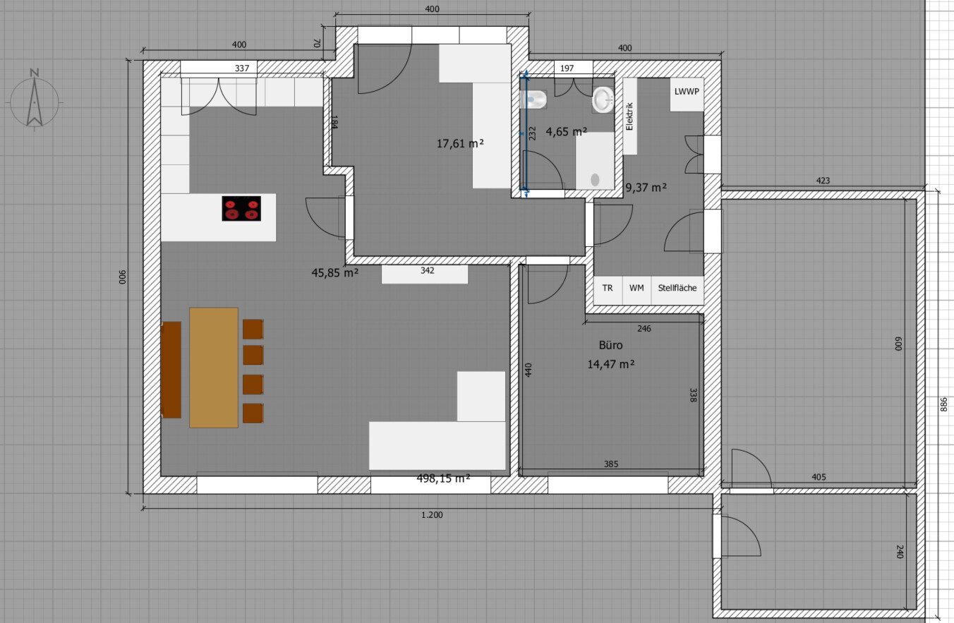

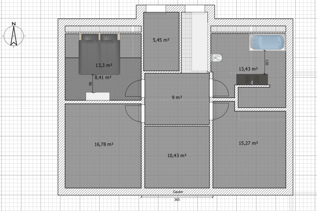

Who designed it:
The basis is the Auro model from Kern-Haus, which we have adapted slightly.
Important: we are open to any suggestions and don’t want to force our wishes onto the Auro design at all costs.
Please feel free to show options allowed on the plot. For example, a side entrance or similar would be a conceivable option.
Please also consider allowed extensions / bay windows / dormers. Two-thirds of the building length is permitted here.
Is the two-thirds allowance per side or overall?
What do you like especially? Why?
The large office downstairs, which opens nicely to the garden (south). In old age, this could be converted into a bedroom allowing living on one level.
What don’t you like? Why?
Possibly the technical and laundry room – somehow it doesn’t really fit well, what do you think?
The bathroom with the sloped ceilings doesn’t look ideal at first glance— or is it deceiving? How could this be improved?
The hallway on the ground floor is quite large – presumably this space is wasted. Could this be optimized?
Preferred heating technology: open
If you have to give up something, which details / extras
-you cannot live without:
1. A shower on the ground floor is important because of the dog and the option to live on one level later.
Could the space under the stairs be used for placing the shower to gain more room for the utility/technical room?
2. A walk-in closet for the parents would be desirable. Ideally, with direct access from the dressing area to the bedroom (not like in the current plan).
I am aware that windows and similar are still missing in the draft…
If anything else is missing, just contact me.
Best regards and thanks again for your great help!

27 Oct 2020 11:40
Escroda schrieb:
For the Auro on the website (knee wall estimated at 50cm (20 inches)), the following calculation results (dimensions estimated, as not specified):
Ground floor area: 7.80m (26 feet) * 12.00m (39 feet) + 2 * 4.00m (13 feet) * 0.80m (31 inches) = 100m² (1,076 sq ft)
Upper floor area > 2.30m (7 ft 7 in): 100m² (1,076 sq ft) - 4 * 4.00m (13 feet) * 2.00m (6 ft 7 in) = 68m² (732 sq ft) < 75m² (807 sq ft) = 3/4 * 100m² (1,076 sq ft) => not a full storey
Is this just a simplified calculation, or are the exterior and interior walls not considered in the 2.30m (7 ft 7 in) height area calculation for the upper floor?
11ant27 Oct 2020 13:17
Reviloo schrieb:
A shower on the ground floor is desired because of the dog and the possibility of living on one level later.
Maybe the space under the stairs could be used to install the shower there.
Dog yes, age no: at 30/26 you will very likely be among those who build new homes close to retirement – the trend among those around fifty-five now will have caught up with you by then. I’ll check later where I can find the discussions about shower standing height under the stairs.
KEVST schrieb:
Do exterior and interior walls not count in the 2.3m (7.5 ft) floor area calculation on the top floor?
To my knowledge no: "including their enclosing walls."
