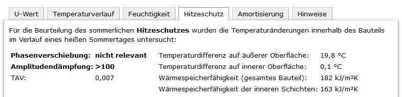

By the way, the thermal conductivity is rather high than low. You probably mixed that up.Rather high? That depends on your point of view. Compared to sand-lime brick, you’re right! But high, for me, means a value where I could use the brick without an external thermal insulation composite system (ETICS). In other words, filled Poroton.
toxicmolotow schrieb:
Next arguments in favor of sand-lime brick: wall-mounted cabinets thermal storage capacitya) Wall-mounted cabinets. I was able to mount those very well in a friend’s house. They used 17.5cm (7 inches) T18 blocks with an ETICS from another regional supplier. Sure, sand-lime brick has advantages here.
b) Thermal storage capacity, but isn’t that negligible because of the ETICS!?
Conclusion: So, as an advantage, I see the load-bearing capacity due to the high bulk density and the better sound insulation. The load-bearing capacity is the only thing that makes me think. Especially since we are building a single-family home and not a terraced house, semi-detached house, or a multi-story residential building.

toxicmolotof3 Aug 2016 09:24Thermal conductivity is not the same as thermal storage capacity.
High thermal conductivity = poor insulation performance (in this case, the external thermal insulation composite system (ETICS) is the more important component).
Thermal storage capacity causes a phase shift. Here, calcium silicate brick can absorb about 50% more "heat." Temperature fluctuations become slower.

@toxicmolotow
Yes, you better hold back. You’re just repeating what I already politely asked and pointed out to you. I tried to communicate with you. It seems pointless. And obviously, you didn’t even look at the pictures... Otherwise, you would have seen from the values shown there that the phase shift is not relevant.
