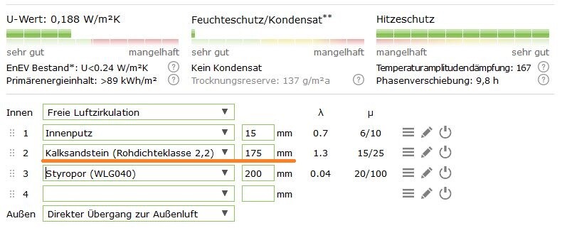

Regarding your question in the thread: my opinion is NO. Poroton combined with ETICS (External Thermal Insulation Composite System) is not the right choice in my view. If using ETICS, then 17.5 cm (7 inches) calcium silicate bricks, mainly for sound insulation reasons.
I don't think the 17.5 cm (7 inches) Poroton bricks are strong enough in terms of compressive strength for a load-bearing wall. Besides, if using ETICS, I would only rely on calcium silicate bricks. Interior walls can then be built with 11.5 cm (4.5 inches) thickness and still offer better structural stability, heat storage capacity, and sound insulation than Poroton. Also, fixtures on the wall can be mounted more securely.

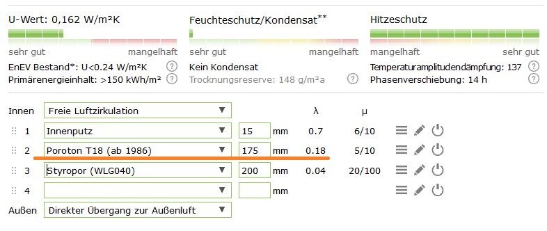

A thermal conductivity of 0.18 W/mK for the T18 is a joke, so I don’t even consider that the thermal conductivity of the Poroton T18. For me, a stone has thermal conductivity only if it could also serve as a substitute for an external insulation and finishing system (EIFS) / external wall insulation. Whether filled Poroton bricks are useful or not, we’ll leave aside.

It is not true that a T18 with 17.5 cm (7 inches) is not strong enough in compression for a single-family house. And I never said that builder #1 does not offer any sand-lime bricks. They offer either Ytong or POROTON directly to choose from, but of course you can get anything else as well.
If I’m supposed to consider a sand-lime brick, which one would you suggest?
