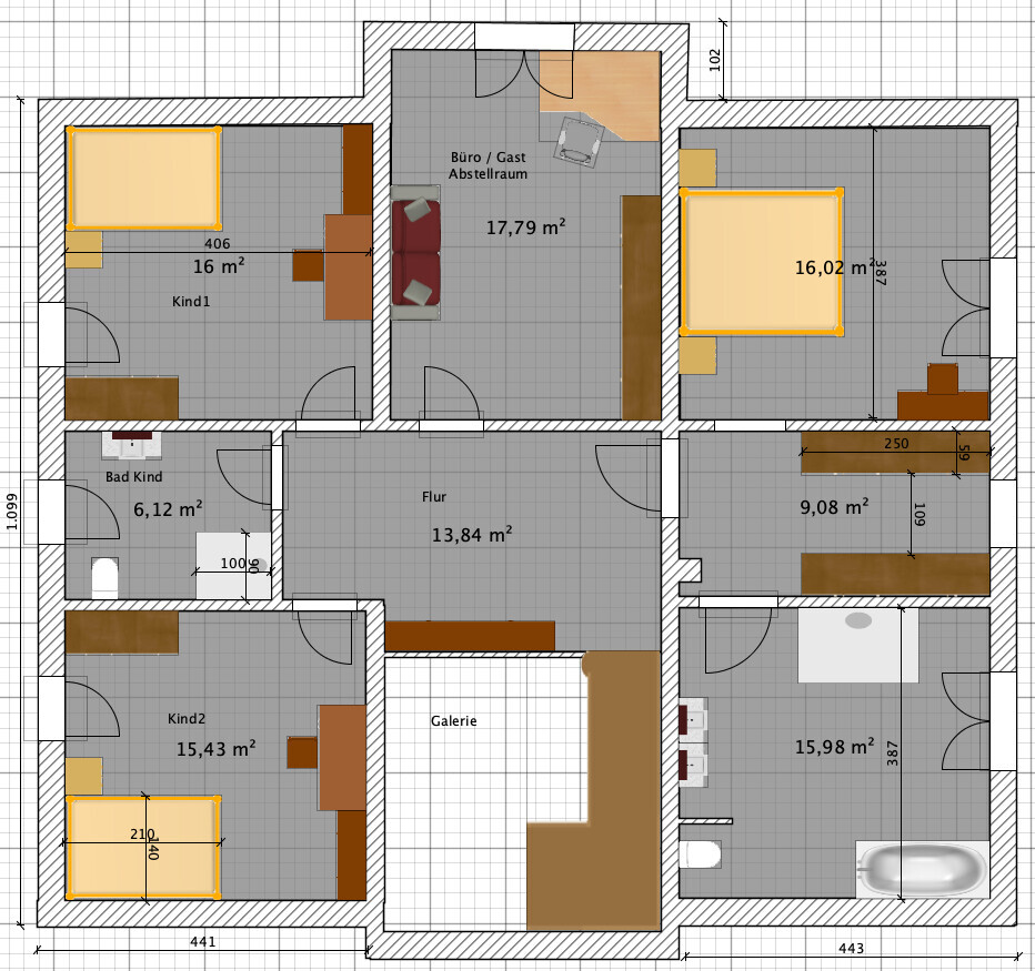

maleba89
11 Sep 2020 16:53
I have now drawn it in a program with the dimensions and furnished it as we imagined.
My question is whether the technical equipment like the heat pump and storage tank can fit into the utility room, or should I use one of the garage rooms for the technical installations?

hampshire
12 Sep 2020 16:33
pagoni2020 schrieb:
In my opinion, the bay window in the dining room should be designed so that the dining table can be used exactly in that space; otherwise, it doesn’t look as good.
I thought so too and see that it has been implemented in the latest proposal. That already makes a big difference.
Regarding the stove position, I agree with @Climbee. I would rather move the TV.
The layout in the center of the house is very generous in terms of square meters. That’s not a problem if you’re not focused on the budget. But it’s a pity if this spaciousness can’t be translated into quality of living. I find there’s too little creativity here.

maleba89
12 Sep 2020 19:33
Moving the TV is not possible because of the screen behind it. I will reconsider the stove placement.
The bathroom is no longer above the dining room as it used to be.
Could you please elaborate a bit on the living quality in the center of the house?
11ant12 Sep 2020 19:46
hampshire schrieb:
The center of the house makes very generous use of the square meters. [...] It's a pity if this generosity cannot be translated into living quality.
I agree: upstairs there is a spacious hallway, yet it doesn’t really bring joy to anyone; and downstairs there is a large open area in front of the dining table, which, in my opinion, does not actually need to be centered. At least I no longer see any traces of the former Scandimerican farmhouse — I hope that’s not only missing from the drawings but has actually been removed.
maleba89
12 Sep 2020 20:33
I am happy to receive suggestions on how to optimize the hallway upstairs as well as the area in front of the dining table.
11ant12 Sep 2020 23:16
You will have to try another design. Creating a donut-shaped hole in the middle of the house is hardly feasible.
