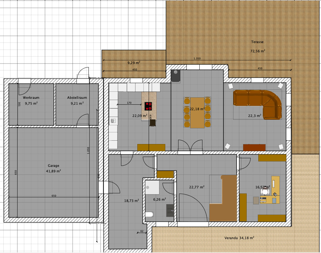

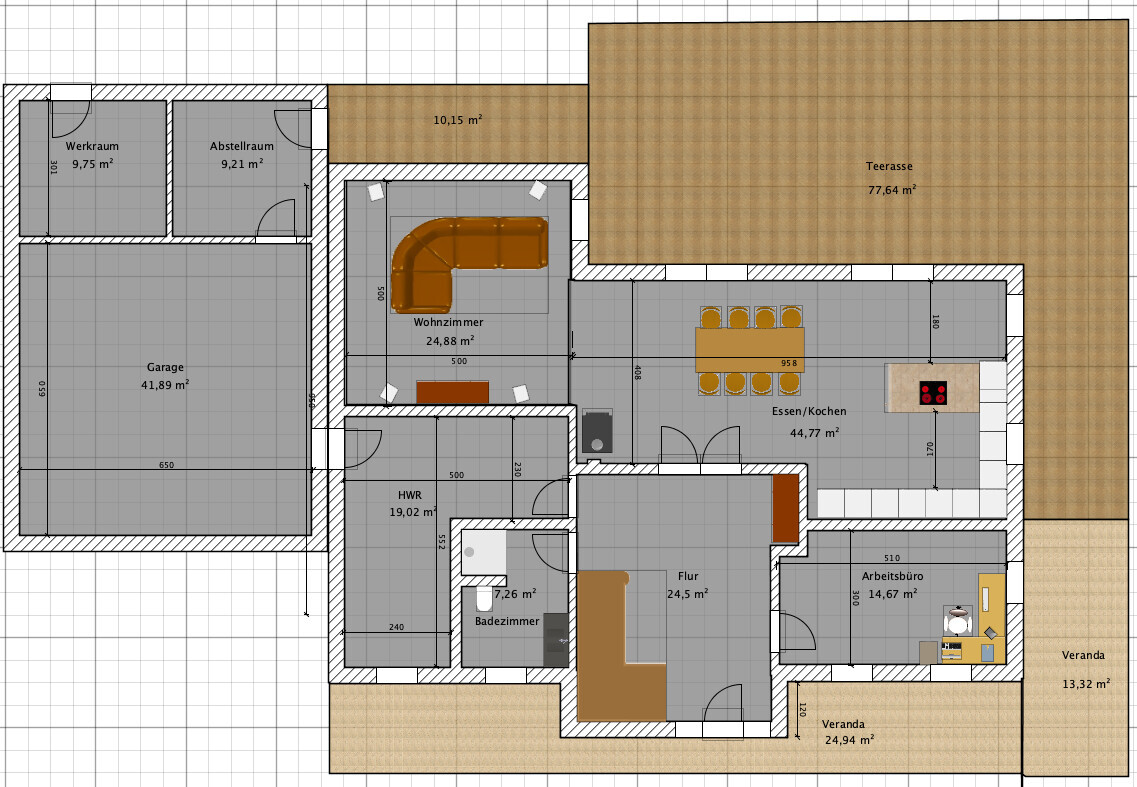

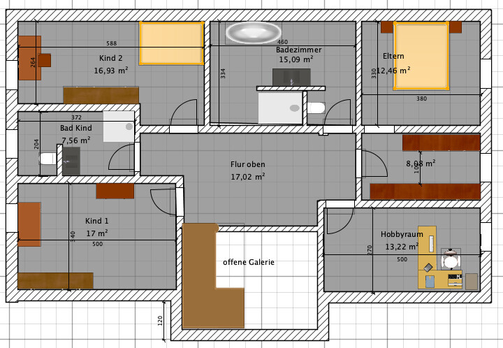

I have now revised the floor plan of the ground floor to include a wardrobe area. I am still working on the upper floor but have tried a different approach to better orient the house towards the garden. What do you think?
The first two images show the new design, and the last one is the adjusted ground floor with the wardrobe.
pagoni20203 Aug 2020 20:18I didn’t calculate it exactly, but there should be about 250 sqm (2,690 sq ft) of living space over two floors, plus a garage and storage room, as well as almost 100 sqm (1,075 sq ft) of terrace!
Your living room, on the other hand, has 24.88 sqm, is framed by three closed walls, and is therefore exactly the same size as your hallway!
Even with my untrained eyes, I can see that you still seem to be playing Tetris, sorry. Huge floor area with rooms pushed together and built in tightly, some even dark.
With this kind of floor area, an experienced architect could design a real paradise. Even your utility room is almost as large as the living room.
The bathroom upstairs is quite something. You can immediately tell who sat on the toilet, because that person probably has a kneecap fracture from someone else opening the door too hastily. That this location for the toilet is probably the worst possible spot ever doesn’t require an architecture degree to recognize.
Upstairs, the hallway is again one of the largest rooms, and the bathroom and other rooms have no windows, so they rely on artificial lighting? The master bedroom next to the guest toilet is almost the smallest room in the entire, huge house...??? Child 2 wouldn’t be envied if they had to get through the space between the closet and the bed at all.
You should enter exact measurements for windows, doors, furniture, etc. Despite the already numerous criticisms, it seems you have remained true to your original, self-made approach, and picture 3 with the other version doesn’t improve things. Here again, the hallway is just slapped in and is almost the largest room of all.
Please don’t take this the wrong way, but you are planning such a massive house and apparently doing the planning yourself with a computer program? This surely wasn’t designed by the architect mentioned at the beginning, or if so, they wouldn’t deserve that title.
I really can’t believe it: almost 100 sqm (1,075 sq ft) of terrace and a 24 sqm (258 sq ft) living room with almost no windows, and wherever I look I see hallways...
Just by looking at the bathroom layout upstairs, it should be clear that a qualified professional needs to address this design idea.
I’m certainly no floor plan expert, but after all your efforts since last time, there is no visible improvement, so that’s my honest assessment.
