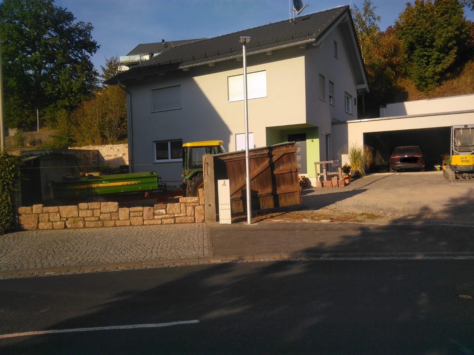

phil123453 Jun 2020 19:52Time for another local inspection drive through residential areas.
Do you have any additional feedback on the plan from #86?
Thanks!
Thanks!
