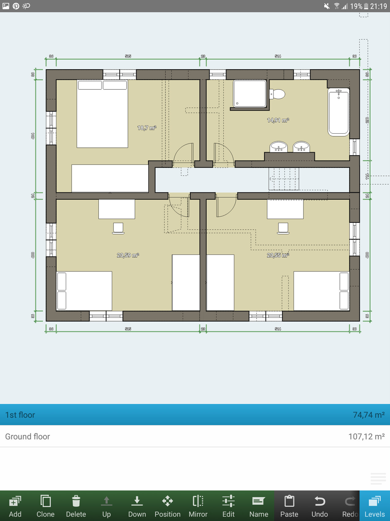

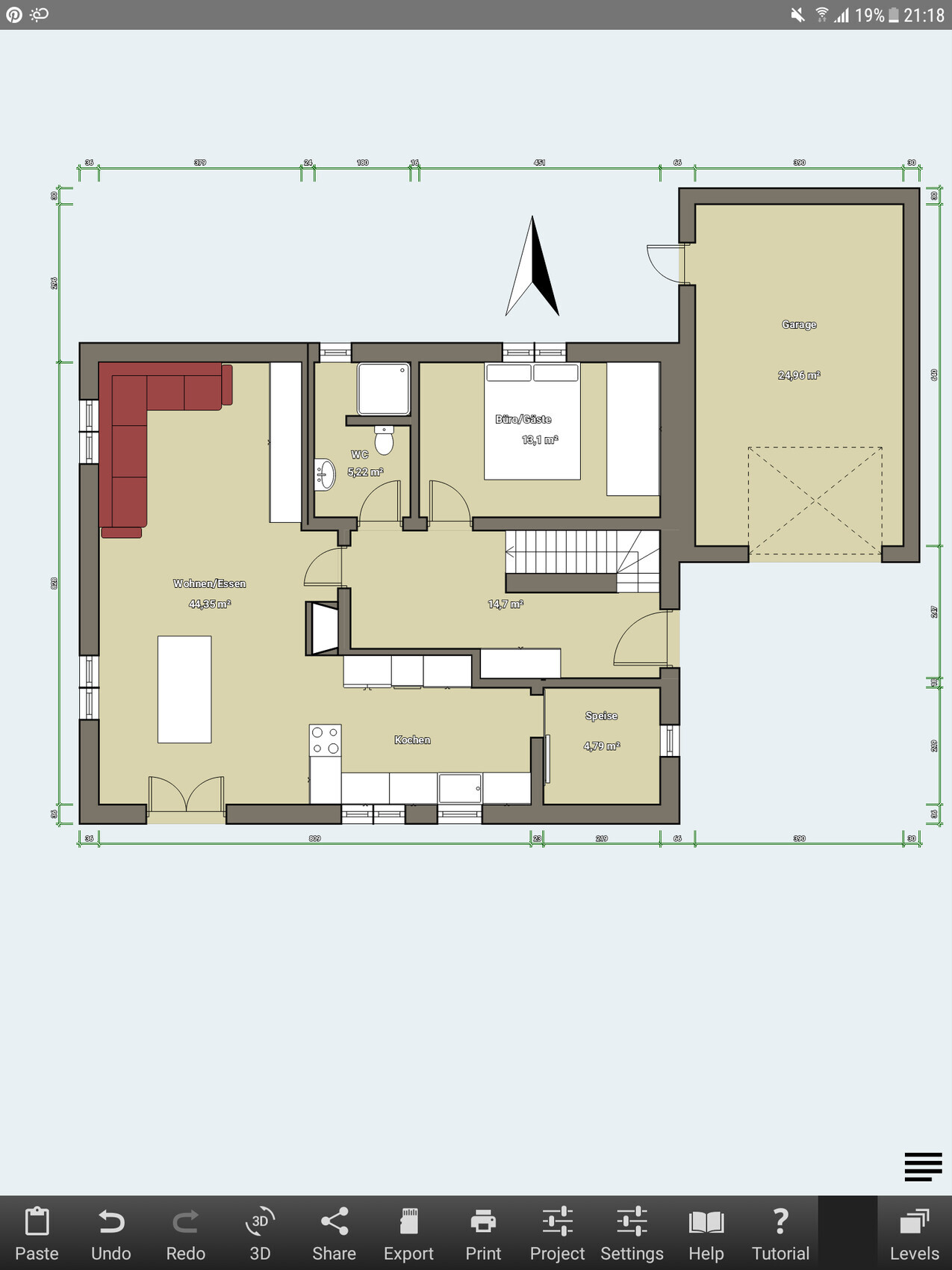

I have finally finished drawing the floor plan and am looking forward to your opinions and advice.

Can the floor plan be realized as drawn, meaning can you get through all areas in practical use? Are there any elements that won’t work as shown?
Floor plan: living/dining area with sofa, kitchen, pantry, office/guest room, WC, hallway, stairs, garage.
Floor plan first floor: four bedrooms, bathroom, central hallway; each approx. 18–21 sqm (194–226 sq ft).

hampshire schrieb:
I don’t find the drainage over and next to the guest room problematic; a guest just has to be able to tolerate it.
Of course, it’s bearable for a guest. But if the drain, when optimally positioned, ends up in front of the window, that would be a design flaw. If we add a bend above, it can go into the corner of the room, but with a width of 2.90 meters (9.5 feet), it restricts the furniture layout.
hampshire schrieb:
A pass-through to the hallway with generous shelving behind it would be a solution. You come in, put your groceries through the pass-through onto the shelf, and then walk around to sort them away.
... and while pass-throughs may have their place in some buildings, if you’re planning a new build, please avoid such a theatrical gimmick. Walls in the entrance area should provide space for a chest of drawers, shoe rack, or coat hooks.

Hundreds of readers don’t know what you mean. Or do you use the profile search?
Regarding your hallway: a circulation route (for example, entrance-kitchen-storage, or stairs-bathroom, or bedroom-bathroom-hallway) should be passable blindly or in a hurry without bumping into walls. That means: hallways should be as straight as possible. Your hallway is a bit of a maze.
About the kitchen/stove: grease splashes behind the 60 cm (24 inch) cabinet, making the floor greasy. When you stand at the stove, you’re cramped on the left side.
If you want to constantly carry your trash and beverage crates from the pantry through the kitchen, living room, and the entire long hallway, that’s your choice. Then do it. Or install the hatch suggested by @hampshire. I see only disadvantages in these disproportionally elongated rooms and wouldn’t want to build like this.
If you want a short route from the kitchen to the pantry, then create a different path to Rome. Everything is possible, but obviously, you no longer consider any other options.

Thanks. Hmm, then we’ll have to do the hallway downstairs differently. Where would you place the pantry? The problem with the plot is that it’s narrow and long. We designed with a footprint of 11 × 9m (36 × 30 ft) because we don’t have much garden space anyway and didn’t want to lose more. So, our initial ideas were probably not optimal from the start.
About the drainage: Am I misunderstanding, or should the toilet downstairs be exactly in the same position as the one upstairs? I thought it would be sufficient for the rooms themselves to be stacked vertically.

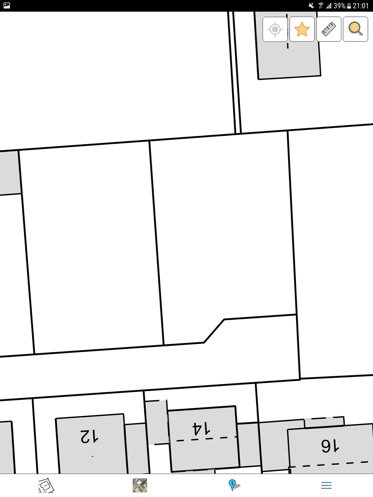

Well, if only we knew which plot of land it is, its dimensions, and roughly how the house is supposed to be positioned on the plot.
Pinky03019 Feb 2020 08:25
I really don’t like the kitchen layout. Some points have already been mentioned above. Please consider these carefully before construction starts, otherwise it will be difficult to make changes later.

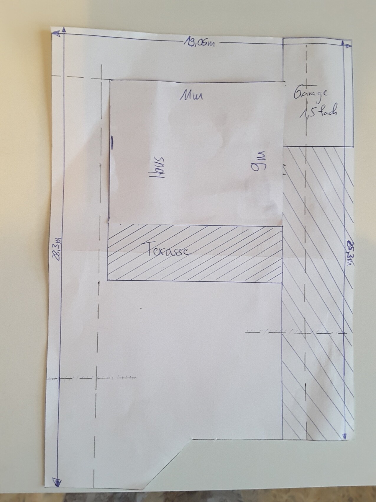

9 Feb 2020 08:33
kbt09 schrieb:
Well, if only we knew which plot it is, its dimensions, and how the house is roughly positioned on the plot
Sorry, I forgot. It is the plot opposite number 14. It is 19.06 m wide (62.52 ft), 28.3 m long (92.8 ft) on the left side, and 25.3 m long (83.0 ft) on the right side.

Nagrie123
9 Feb 2020 08:37
Pinky0301 schrieb:
I really don’t like the kitchen layout. Some points have already been mentioned above. Think about it carefully before the house construction starts, otherwise it will be difficult to make changes.
Thanks, yes, we are thinking about it but somehow can’t figure out how to change it. We considered moving the kitchen to the north, but I would find that a shame because of the light. Especially since the living room would then be on the south side, which is a bit awkward for watching TV.
