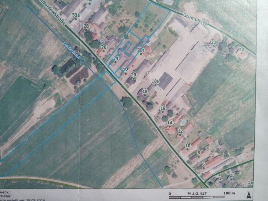

little.grisu15 Oct 2016 16:30We would like to have only two floors! The wider the house, the steeper the roof slope! The ceiling height is already quite high.
Do you have any ideas on how we could plan differently – do you have example floor plans? I can’t find anything similar on Google.
Shouldn’t we minimize the hallways as much as possible?
Where else could the kitchen be located?
What would you advise us to do?

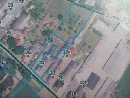

Yes, the driveway is in the garden, and the street is at the entrance.
Living area approximately 140 m² (1507 sq ft)
Regarding the location – Grumpelweg is the street access – the house is to be built in the garden there.
Many thanks in advance to everyone who wants to help us!

little.grisu15 Oct 2016 16:32@ MracWen - Could you possibly share your floor plan with us? Your house is very beautiful! (profile picture)
Our floor plan won’t be of much help to you. You’ll need about 24 meters (79 feet) of street frontage. It’s also important to consider the orientation. In our case, it’s a classic north-south layout. The entrance is on the north side. The kitchen is to the east, the living and dining areas along with the balcony and terraces to the southwest, and the bedrooms and office are on the west side.
L
little.grisu15 Oct 2016 17:42Too bad, we would have been interested. 24 m (79 feet) might be possible – but probably on the other side.
How do you "use" the basement? Is it a livable basement?
What is the slope?
What is the slope?
Our thread here. There have been a few changes in the detailed planning, but the overall concept has remained the same.
Yes, the basement will be almost entirely used as a living area, featuring a complete granny flat with 95 m² (1,023 sq ft) of living space and ground-level access to the terrace or garden on the south side.
The site has a slight slope from east to west. Otherwise, the rest of the terrain will be artificially shaped. I believe the driveway to the garage has a slope of about 15%.
