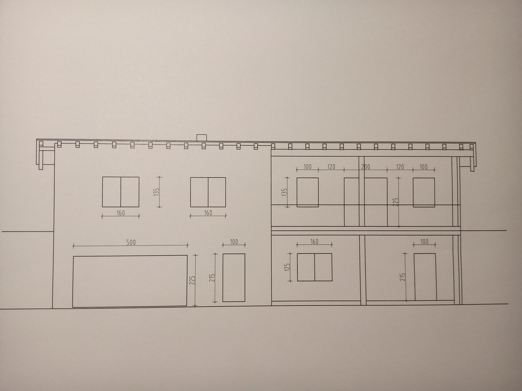

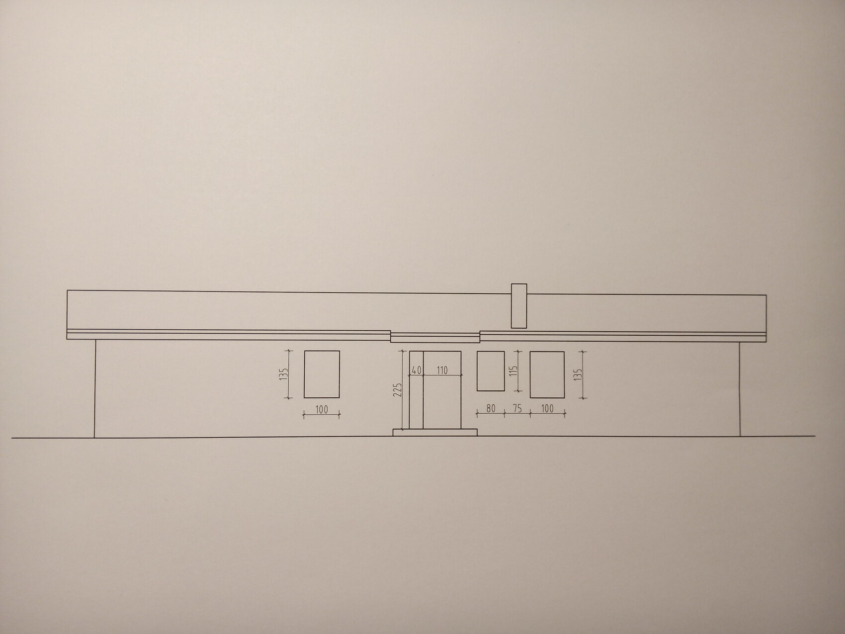

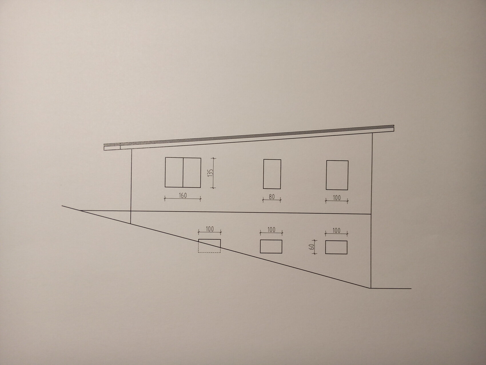

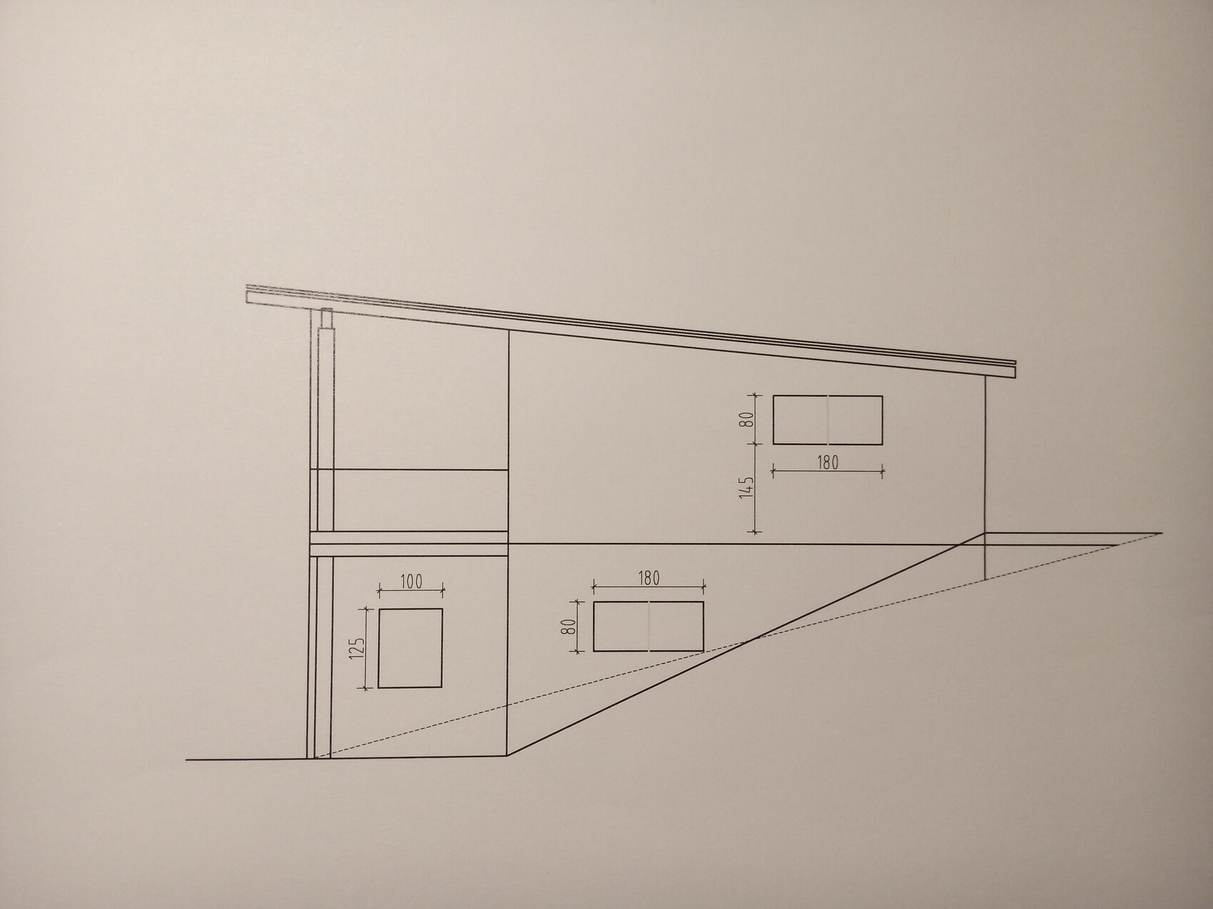

little.grisu15 Oct 2016 10:53Hello dear forum members,
We are still quite at the beginning.
We (26 and 27 years old) are still very early in the process – we have already visited a planning office a few times, but we are not really making progress! I hope you can help us. We look forward to criticism, ideas, and suggestions for improvement.
Here are the key details:
The plot is on a slope and can be accessed from both sides (east and west). If I have made any major mistakes, I apologize in advance. I have provided the data as accurately as possible.

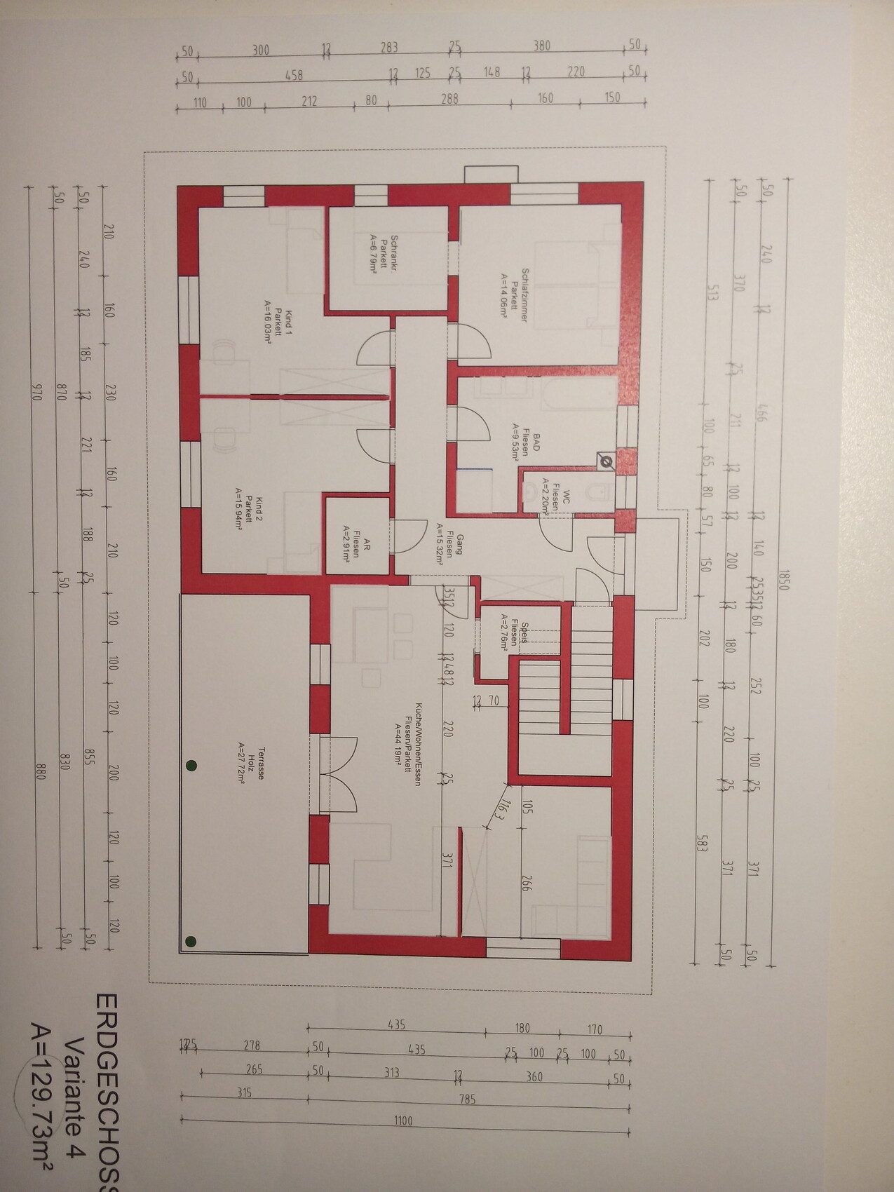

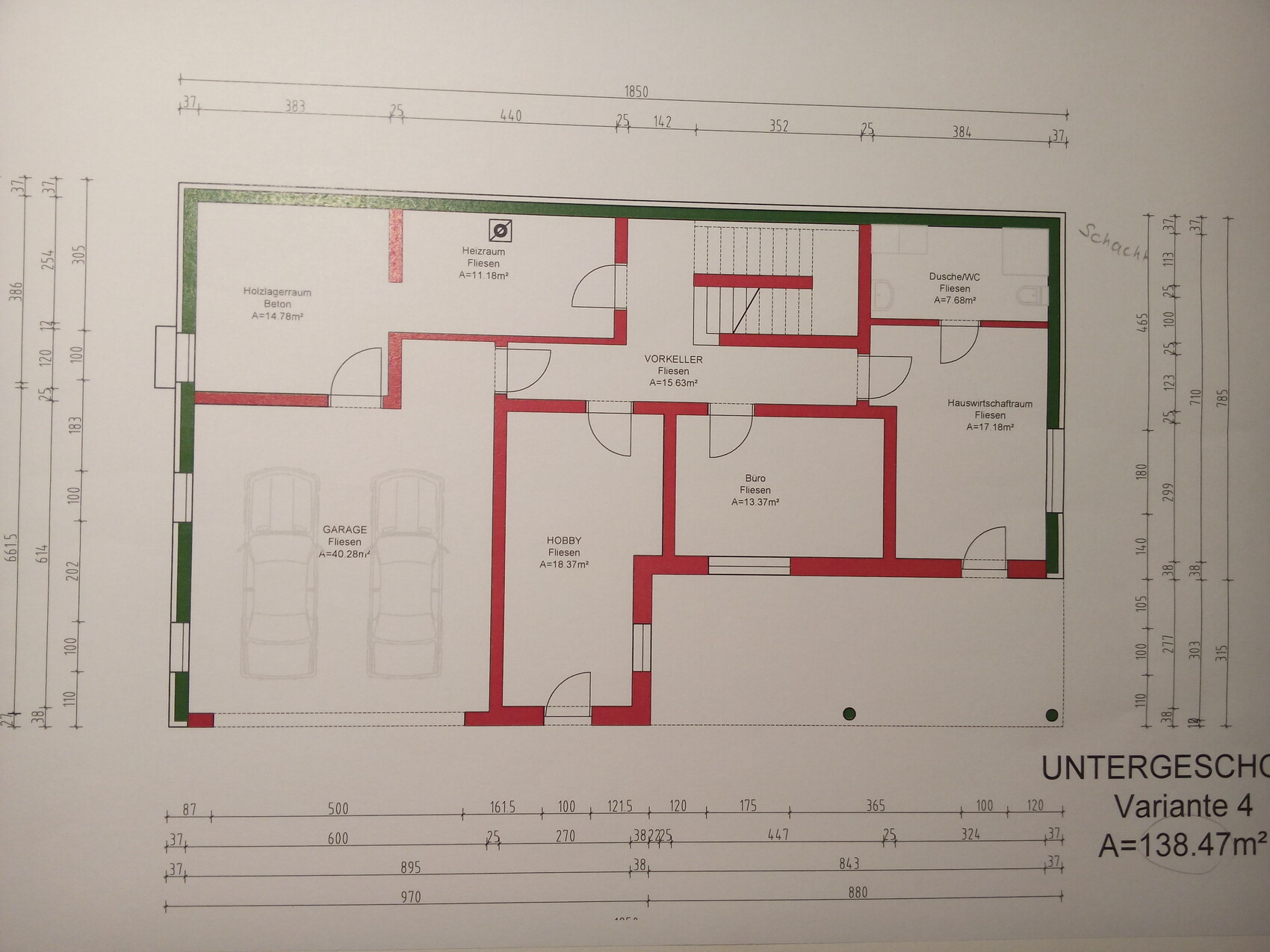

My thoughts:
Basement:
Ground floor:
I’m not completely convinced by the layout.
Basement:
- Does it really make sense to have the shower and toilet behind the utility room?
- Where is north? I assume it is by the entrance?
Ground floor:
- The hallway will be very dark
- There is a lot of wasted space between the dining area and kitchen
- The living room feels somewhat like a small room or chamber
L
little.grisu15 Oct 2016 11:42Thank you for the quick response!
I don’t have a site plan – does the planning office have one?
Why a “better location”?
Phew, I’m not really comfortable with this. It reminds me of a platform—long and narrow.
Why isn’t the attic considered a non-full floor?
There are many corners and, above all, hallways that are way too narrow. The path to the kitchen is like a maze. Don’t you have more space available in width?
Does your design firm build 18.50 meters (61 feet) wide?
Our architect once mentioned that she builds a maximum of 15 meters (49 feet), but I’m not sure where that figure comes from.
How many square meters (square feet) of living space are currently planned?
