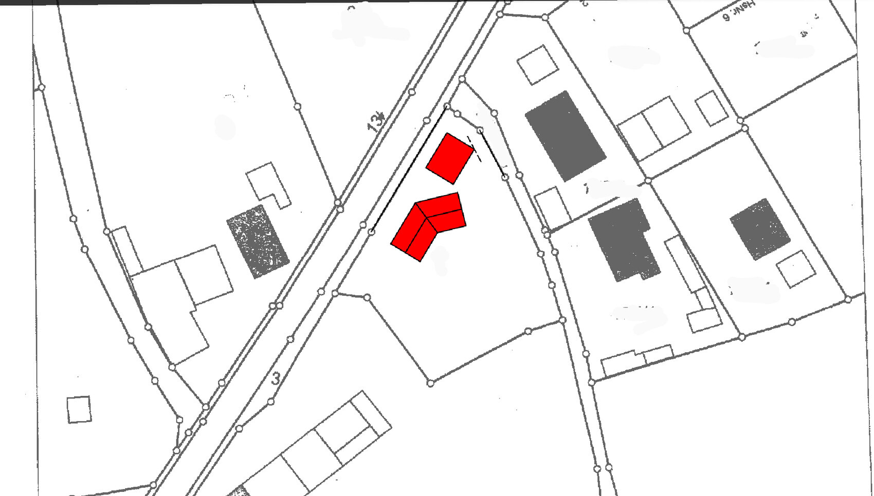

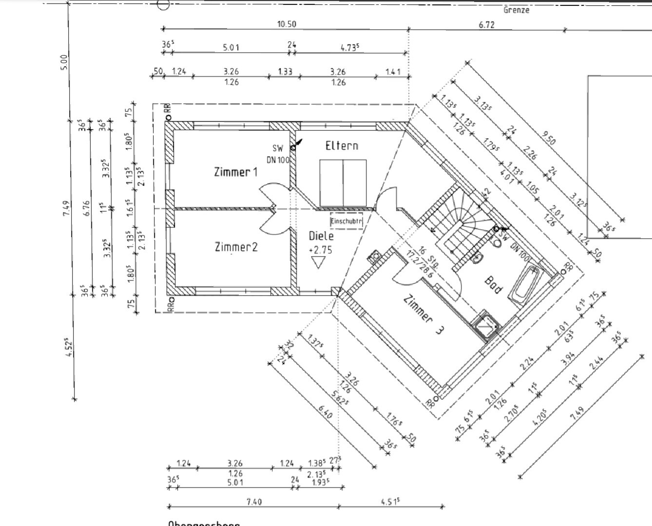

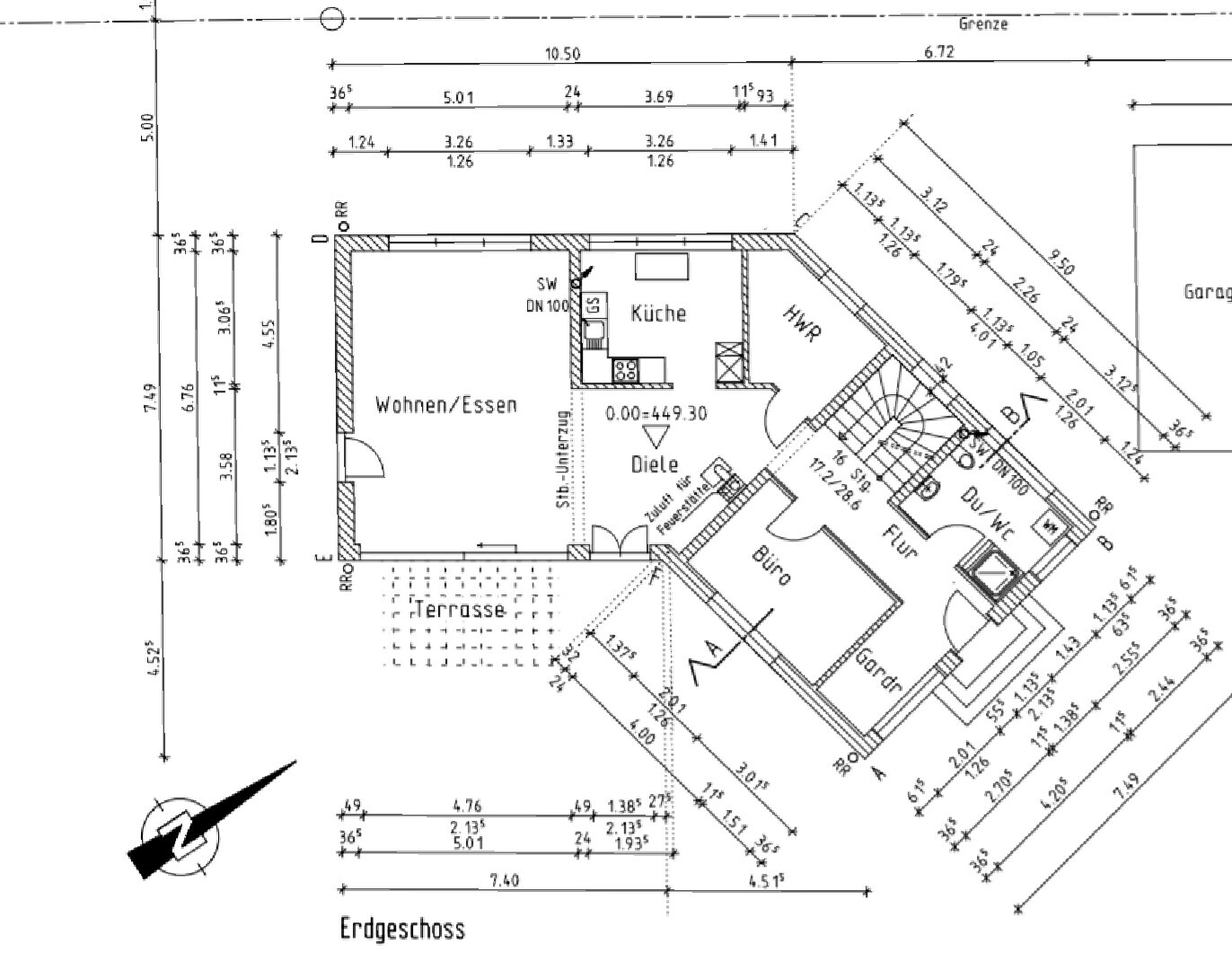

A lot has already been said, and I have looked at the site plan and floor plan numerous times. From all the points mentioned and what’s been on my mind, two key issues have stuck with me:
- I’m bothered by the orientation of the bend. The long side faces the street, and the short side faces the garden. This results in maximum exposure to the “less desirable” side and minimal exposure to the good side (the garden). The logical approach would be to give the nicer side more area and rotate the bend. If you imagine the shadow cast by a beam of light, you might also understand that this would better serve the desired noise protection.
- If the bend has to stay as it is, then in my opinion, the entrance should be located at the tip of the bend. Only that would be consistent. This would create a sort of left and right wing, which could work well with the room layout. I don’t like it as it currently is, and it’s not because of a problem corner, but rather the overall concept.

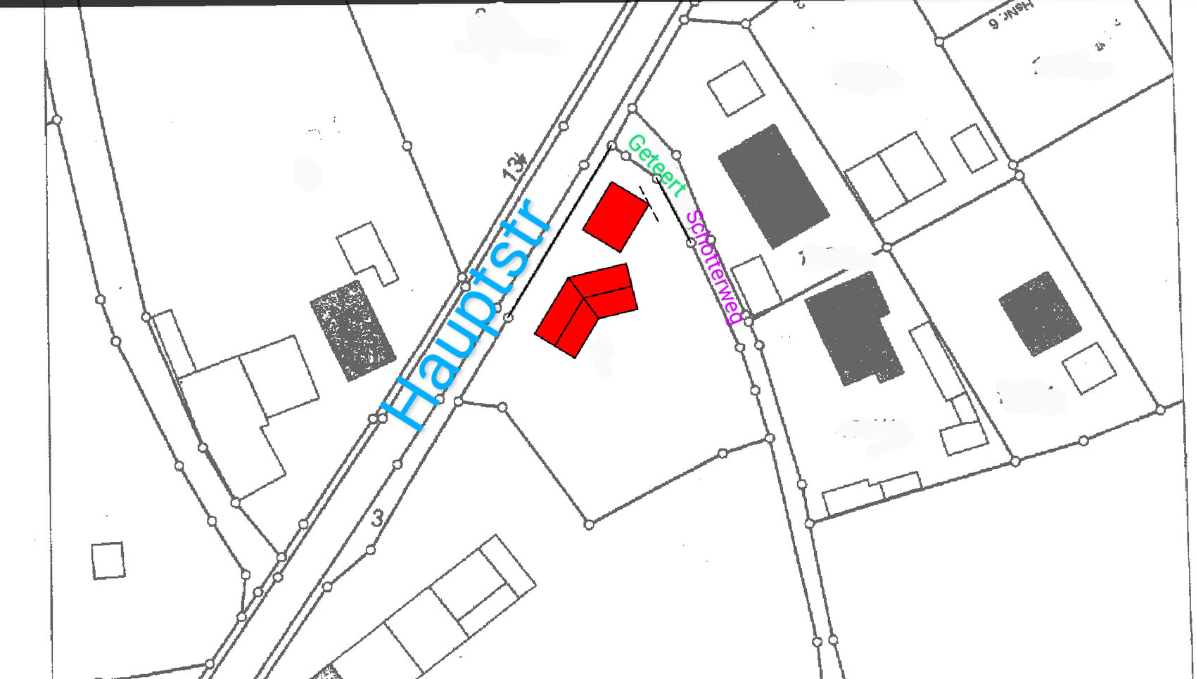

kbt09 schrieb:The driveway is planned on the right because it is purely an access road (serving two additional houses). The front few meters are paved, while the rear section is just gravel. There is also a street on the left; that is the main road. If the driveway were to be accessed via this main road, the sidewalk would have to be lowered, but I am not sure if that would be approved.
The property access is currently planned on the right side – is that correct? At least, that’s what I infer from the position of the front door and the view of the garage:
Is there also a street to the north/northwest from which access can be made?
