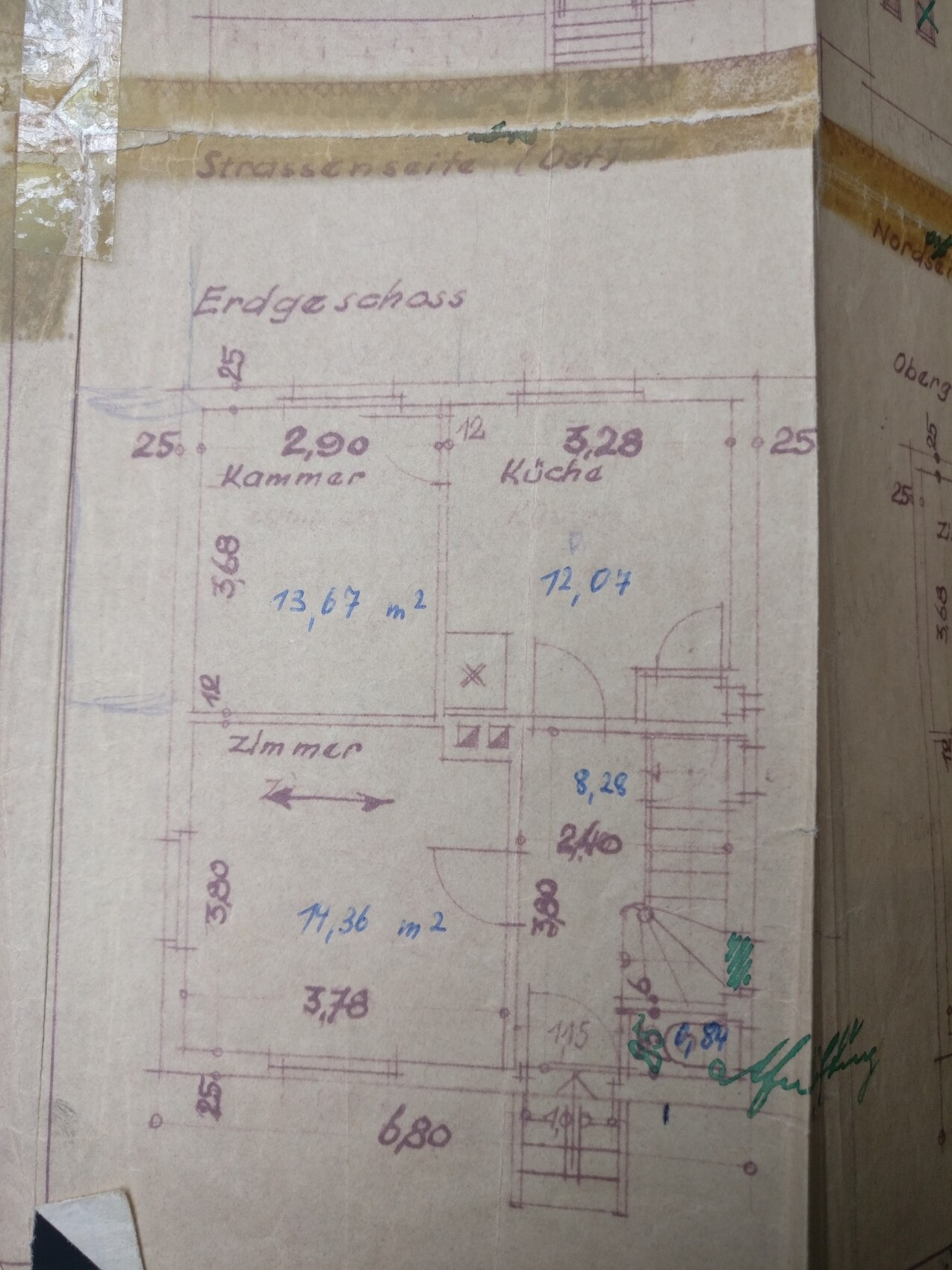

17 Nov 2019 08:20
I have attached the original plan from 1938, which might be helpful.
Only the old building is shown; two rooms were removed upstairs in 1957, and the single room on the left on the ground floor was removed in 1955.
Ground floor plan with rooms, kitchen, pantry, and area measurements in m².
kaho67417 Nov 2019 10:09
For a renovation like this, more information is needed. Before anyone starts planning, it’s essential to first identify which walls are load-bearing, preferably by a professional. Then, it’s best to show the current state with the load-bearing walls marked in red. Additionally, provide a separate file showing the planned state with new walls in yellow or a similar color. Mark important pipes, conduits, shafts, or chimneys as well. Also, include a north arrow and ideally the entire plot with access roads and parking spaces. In short, include everything.
11ant17 Nov 2019 14:36
Bombadil schrieb:
I’ve attached the original plan from 1938; maybe it will help.
I thought so. Please add the rest as well (and don’t forget the elevations – keep in mind: we have to envision your house a bit more thoroughly than you do).
17 Nov 2019 22:21
Has an extension already been built on the west side?
I’m interested in the plot, the location of the terrace, etc.
Perhaps some exterior views of the current condition as well, to get an impression.
Then the scale of the renovation becomes interesting: is it just a facelift with a simple opening, or does the budget also include relocating windows? Are the load-bearing walls known?
Is the planned bathroom already a bathroom?
Where are the drains and other pipes located?
Are the size measurements in the attic actual usable space or just the floor area?
Roof pitch? Knee wall height?
Altai
18 Nov 2019 10:12
With a house width of 6.80 meters (22 feet 4 inches), it is probably unavoidable to have the rooms shaped like narrow corridors. It’s the same in my case—I have 7 meters (23 feet) width and 10.5 meters (34 feet 5 inches) length, and the children's rooms are 2.80 meters (9 feet 2 inches) wide, although they share the house length. For my room, I allowed myself 3.30 meters (10 feet 10 inches).
I also think more information is needed about the current situation, what must be preserved, and how far modifications can go (for example, an additional extension or similar). And regarding the budget, just because the architect’s estimate is a certain amount does not mean that’s the final possible figure.
Tassimat
18 Nov 2019 13:58
The upper floor looks unusual. Is there currently an enclosed and inaccessible space? What is inside?
The wall in the ground floor bathroom might be non-load-bearing. The rest is probably load-bearing. This is clearly a case for a structural engineer.
