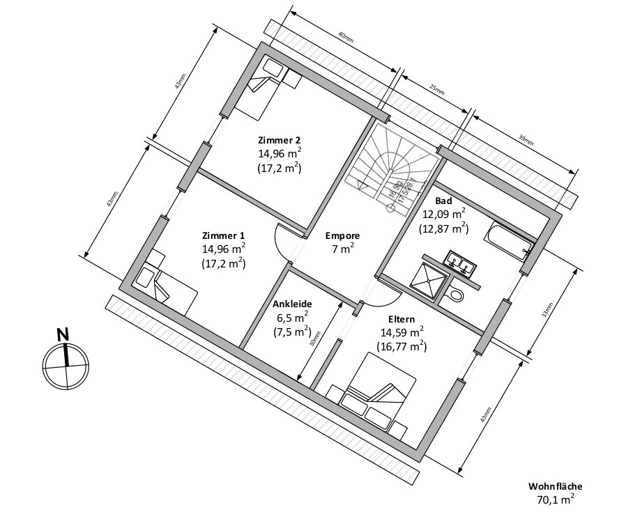

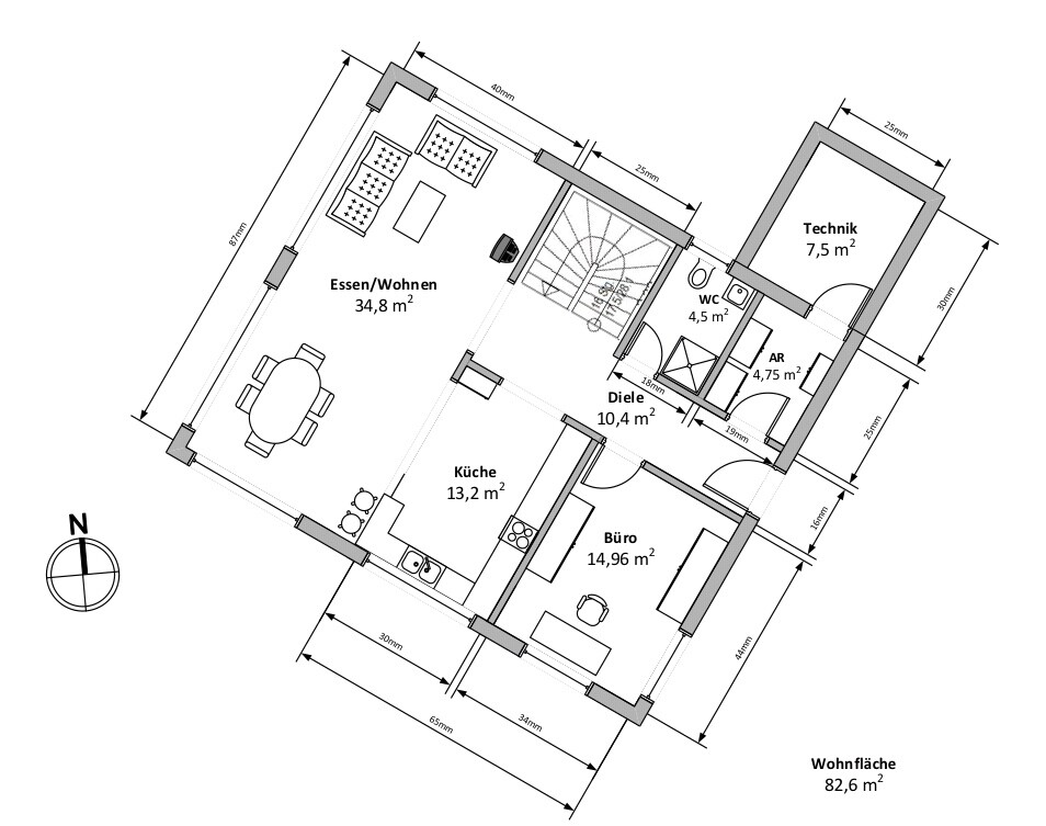

Space requirements on ground and upper floors: see sketches

We hope for some suggestions and improvements regarding the layout, orientation, and size of the house that we may have overlooked in the heat of the moment.

Either a lower top edge for facade windows, or possibly a higher bottom edge for roof windows, or accordingly "angled" windows, or dormers.Sorry, edit timeout: a comma was still missing :-(https://www.instagram.com/11antgmxde/
That's exactly why we have the experts here [emoji4]. We'll get back to you with the new floor plans.
