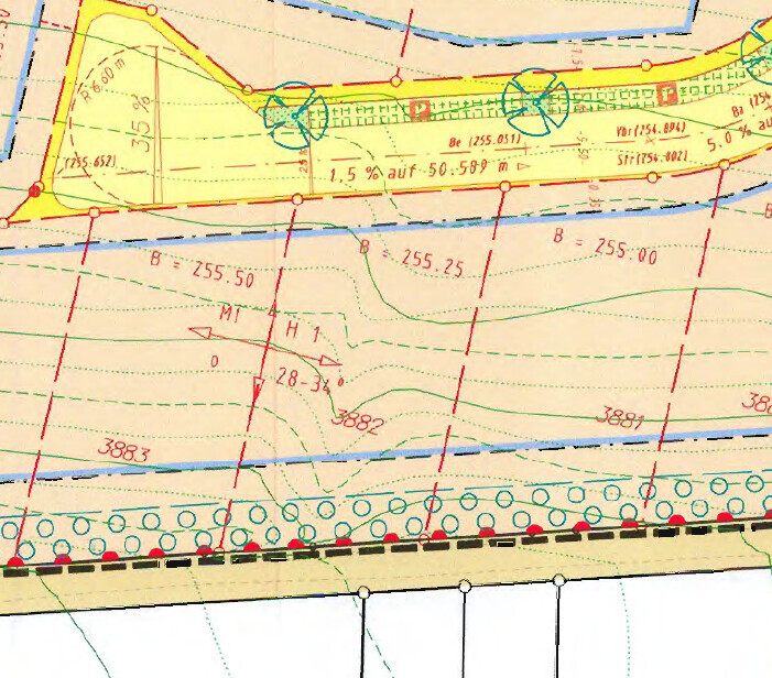

The development plan shows the building height limit H1 (plot no. 3882):

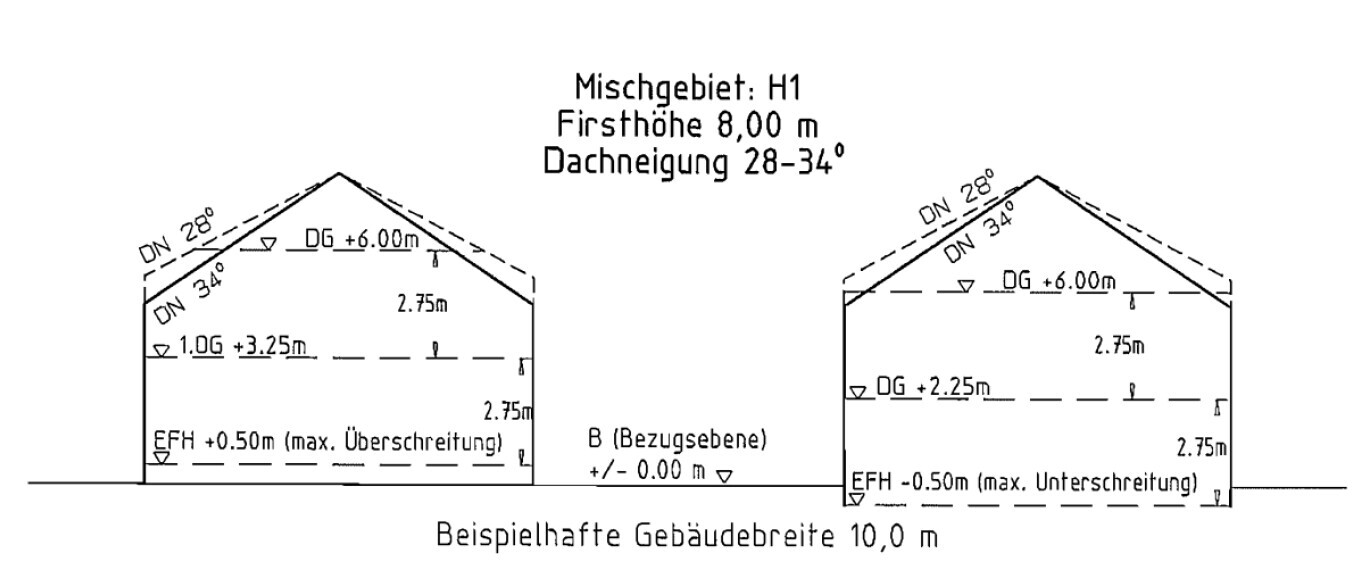

This is also illustrated in the text section:
Now, our general question is whether the variant: garage/entrance on basement level, garden on ground floor, sleeping area on upper floor is possible? The number of storeys is not entirely clear to me, since it is clearly stated that the ground floor must lie max. 0.5 m (1.5 ft) below or above the reference level of 255.25, is that correct? If the house is built raised, then the ground floor would be at least one storey above the reference level 255.25.

Simon91 schrieb:
Now the general question for us is whether the option: garage/entrance in the basement, garden on the ground floor, bedrooms on the upper floor is possible?IMHO no. You only have about one meter (3 feet) of height difference around the house. That’s neither one thing nor the other, since it’s not enough for a full story and leveling the terrace would be difficult. The plot calls for a split-level design. Simon91 schrieb:
If you build the house raised, then the ground floor is at least one level above the base level 255.25I don’t understand. Your ground floor finished floor height must be between 254.75 and 255.75. Your ridge must be below 263.26. Simon91 schrieb:
Is it theoretically possible that when multiple plots are adjacent, each builder can freely decide whether to level their plot or “raise” their house — e.g. build it on top of the garage or raised?Yes, but you would need to check with the local authority what exactly point 3.5 of the building regulations means: The terrain conditions of adjacent plots must be aligned with each other.

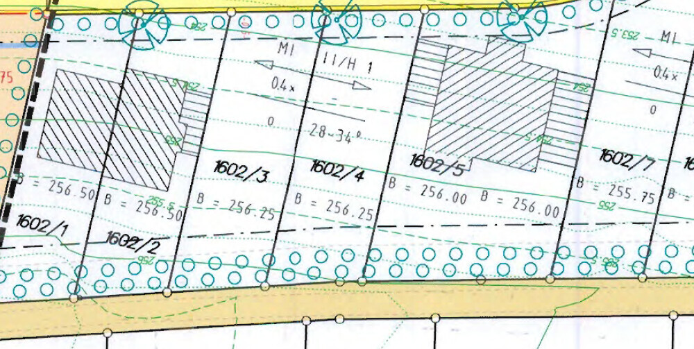

There are no immediate neighbors yet in the development, but about eight houses will be built on the same slope/gradient (which seemed a bit steeper to us). The houses will also be designed so that the front door is next to the garage, with the garden located one level higher.
Example: Plot 1602/5, with a single garage to the left and right, entrance below, garden above.
I don’t know how our direct “future” neighbors plan to proceed, unfortunately.

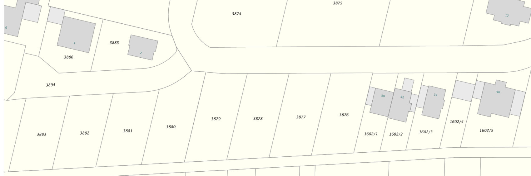

Simon91 schrieb:
Example: building plot 1602/5, single garages on both left and right, entrance below, garden above.I can’t quite align the two plans— which one is your 3882 here?Simon91 schrieb:
I will also contact the local authority to ask what exactly is meant by the phrase “Terrain conditions of neighboring plots are to be aligned with each other.”You’re not supposed to build steep retaining wall steps at the boundary with the neighbor, but rather create a smooth transition of terrain heights in this "cross direction." This shouldn’t be difficult here since the reference heights between the direct neighbors differ by only about a quarter of a meter. Overall, you’re in a good position here: the reference height for the uphill plots is almost level with the terrain at the building boundary, and within the depth of the house, it’s only about one and a quarter meters difference in height. From my point of view, this is still below the threshold where a split-level design becomes necessary—and therefore not really a disadvantage to build classic single-level floors.https://www.instagram.com/11antgmxde/

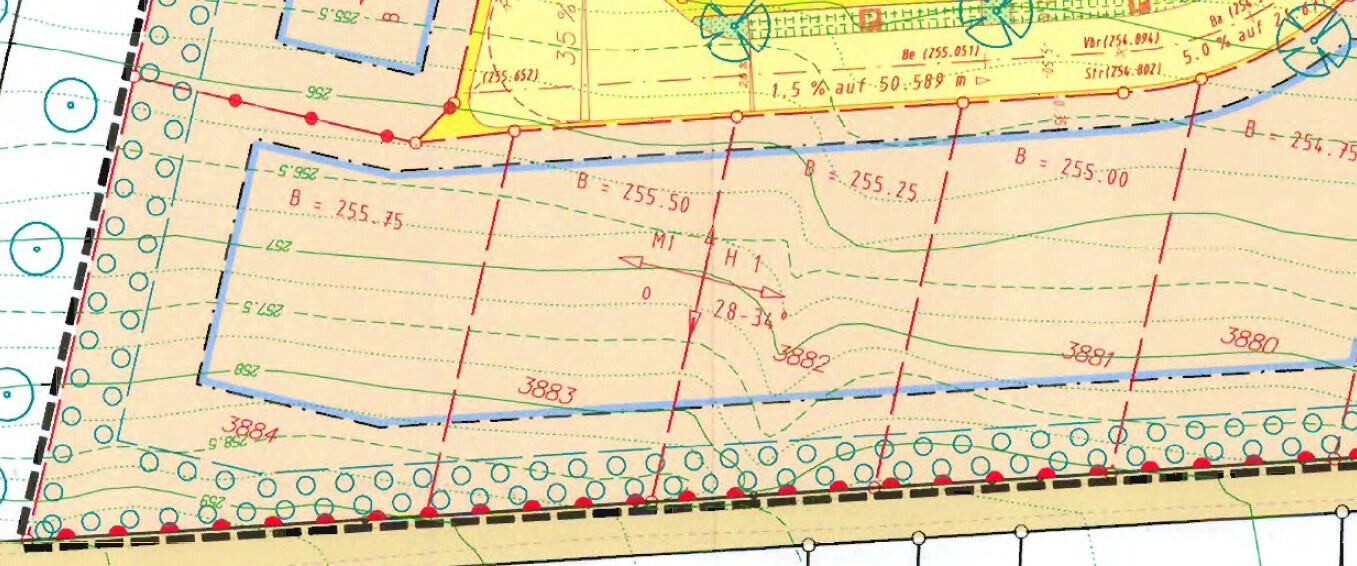

Which one is your 3882 here?11ant schrieb:
This is not a problem hereIf you want to overcome one level from the street to the garden, you have to move a lot of soil and create an artificial elevation difference compared to the neighbors. A prompt meeting with the neighbors could save a lot of money.11ant schrieb:
Within the house depth, it’s only roughly one and a quarter meters in heightYes, we need an exact terrain section, including the designed house profile. The sketch from #1 is simply not sufficient, especially since the contour lines on the development plan are incorrect because they overlap.Hello,
