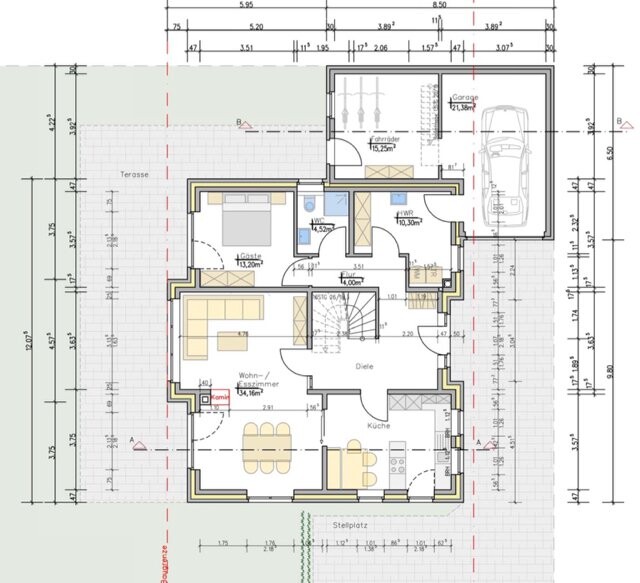

Hello everyone!
We feel like we’re nearly finished with the floor plan design. I would really appreciate it if you could take a close look and give us honest feedback.
I’ve tried to fill out the details as thoroughly as possible.
Attached, you’ll find the plans for the ground floor, upper floor, and attic, as well as relevant excerpts from the zoning plan and the site plan of the property.
The property is located at a dead-end street and is accessed from the southeast side.
The house is planned to be positioned on the lot so that the garage is located along the northeast boundary.
We have neighbors to the south and east. To the west is forest, and to the north is a wide green strip.
Thank you very much for your feedback. Maybe you also have suggestions regarding the layout of the living and dining areas, as we’re not yet satisfied with it.
Sebastian

- Additional wishes / special features / daily routines, also reasons why something should or shouldn’t be included: both adults work shifts, hence a separate “wing” for the parents. The kitchen should face the street at the front.
- Planner: our specifications, implemented by an architect
- What do you particularly like? Why? The layout on the first upper floor is almost perfect except for the windows in the northeast
- What do you dislike? Why? The access to the living room. We would prefer access to the dining room, with the living room connected from there. However, that would require a smaller kitchen or removing the wall, which we don’t want. We’re also uncertain about the size of the utility room, as it will likely need to house the entire heating system, technical equipment, and mechanical ventilation system.
- Estimated price according to the architect/planner: 295,000 euros
- Personal budget for the house including equipment: 300,000 euros
- Preferred heating system: originally ground-source heat pump; now rather considering gas
If you have to compromise, on which details/expansions:
- Can compromise on: we have already accepted a compromise regarding the staircase. We originally wanted a landing staircase rotated 90° or 180°, not a spiral staircase.
- Cannot compromise on: the separated area for the parents with walk-in closet (shift work). The children’s bathroom upstairs (we have two daughters). The guest room and guest bathroom with shower on the ground floor (frequent and many visitors).
Access is from the southeast, with a width of 5.30 m (17 feet 5 inches). Straight ahead there is a parking space. To the right of the house (east) is a second parking space or, continuing further, the garage. It is possible to turn around in the turning circle and reverse onto the property. The opposite direction also works. We expect little to no traffic (cul-de-sac).
To the south, the neighboring property is directly adjacent. We assume that the neighbor will build their garage on their northern boundary (our southern boundary).
The idea was to follow the sun’s daily path. The kitchen on the east side, the dining room on the south side, and the living room on the west side. The kitchen faces the front toward the street, and the living room faces the back toward the garden (sun from southwest to west).

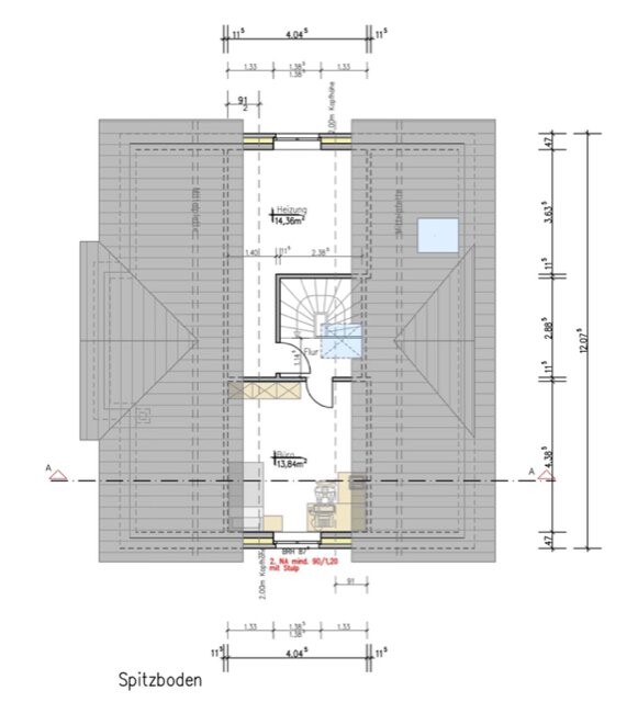

A small office will be located in the attic. There is still enough space for it.
Roughly estimated, the area is 180 sqm (1,937 sq ft), excluding the attic. The 300,000€ is only for the building and the garage. Additional costs for the land, fees, and the architect’s honorarium are budgeted separately.
Honestly, I was a bit surprised by the architect’s estimate. So far, I had calculated around 1,800€/sqm (167$/sq ft) for the 170 sqm (1,829 sq ft) of living space plus 25,000€ (about 27,700$) for the garage. This will be discussed again later, as the 300,000€ is the maximum construction budget we communicated to him.
Kind regards,
Sebastian

Steffen802 Mar 2017 13:441500 EUR per square meter... never 😉
Calculate with 2000 then you are on the safe side. Those who build with an architect usually don’t go for a standard design...
