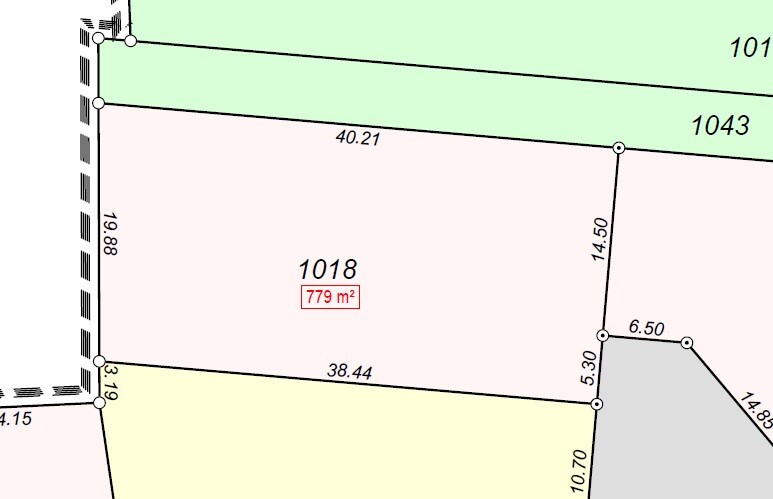

Attached, you’ll find the plans for the ground floor, upper floor, and attic, as well as relevant excerpts from the zoning plan and the site plan of the property.
The property is located at a dead-end street and is accessed from the southeast side.
The house is planned to be positioned on the lot so that the garage is located along the northeast boundary.
We have neighbors to the south and east. To the west is forest, and to the north is a wide green strip.
Thank you very much for your feedback. Maybe you also have suggestions regarding the layout of the living and dining areas, as we’re not yet satisfied with it.

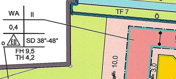

- Plot size: 779m² (8400 sq ft)
- Slope: --
- Floor area ratio:
- Plot ratio: 0.4
- Building envelope, building line and boundary: The dark red area in the attached zoning plan excerpt. Approximately 12m (39 feet) wide from east to west and about 20m (66 feet) from south to north at the boundary line development
- Edge development:
- Number of parking spaces: no requirement
- Number of floors: maximum 2 full stories
- Roof style: gable roof, 38-48° pitch
- Architectural style: single-family home
- Orientation: ridge direction freely selectable
- Maximum heights / limits: top of basement ceiling = 4.20m (13.8 ft) / ridge height = 9.50m (31 ft)
- Additional requirements:
