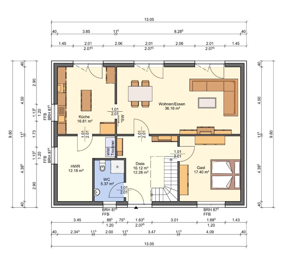

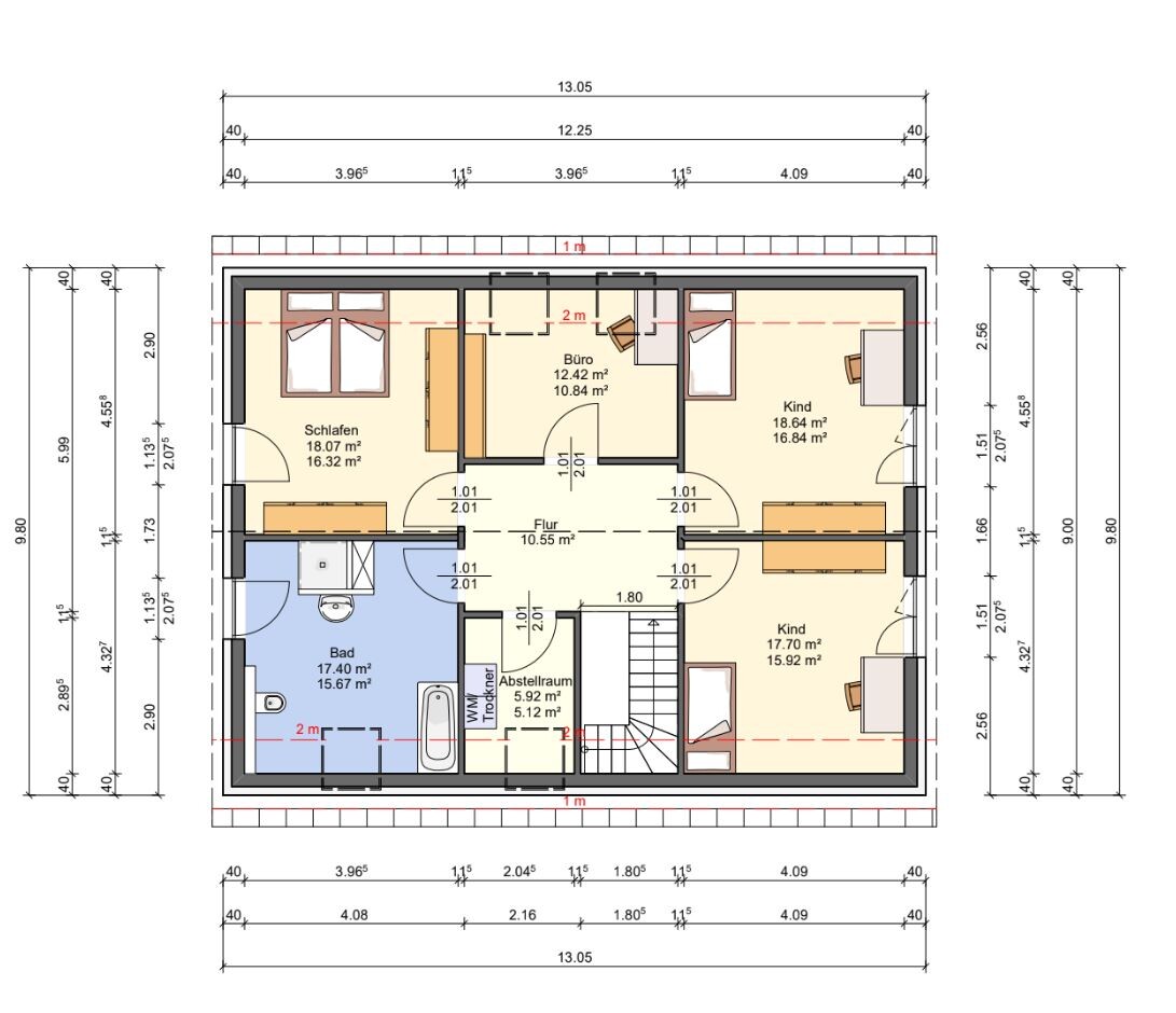

I have been thinking over the past few days about the arrangement and design of the rooms and the plot, and I would first like to know if the concept is okay. I am not concerned with details inside the rooms such as windows, doors, or bathroom design. That’s not possible anyway since I created the floor plan myself based on Gussek Haus floor plans. However, I tried to design it as well as possible. For this reason, I want to share the floor plan here for discussion. I’m mainly looking for feedback on the layout and room arrangement, as well as ideas, suggestions, or tips. Maybe you’ll also spot things that “just don’t work” or are not practical for everyday living.
I created the floor plan with RoomSketcher, but only used the free version, so many features are limited. Please ignore the room dimensions on the upper floor. There is a dormer in the area of the home office.

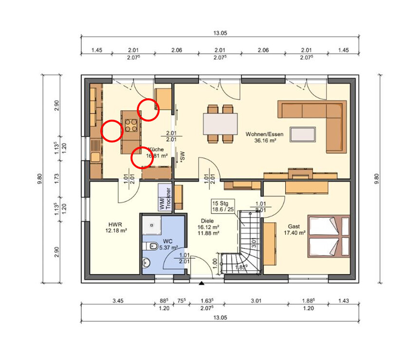

Take a look at these three spots—this won’t work as it is. Your distance between the island and the countertop is about 80 cm (31 inches), and the passageways are 60-70 cm (24-28 inches). That’s far too tight. I had already suggested a solution for this.

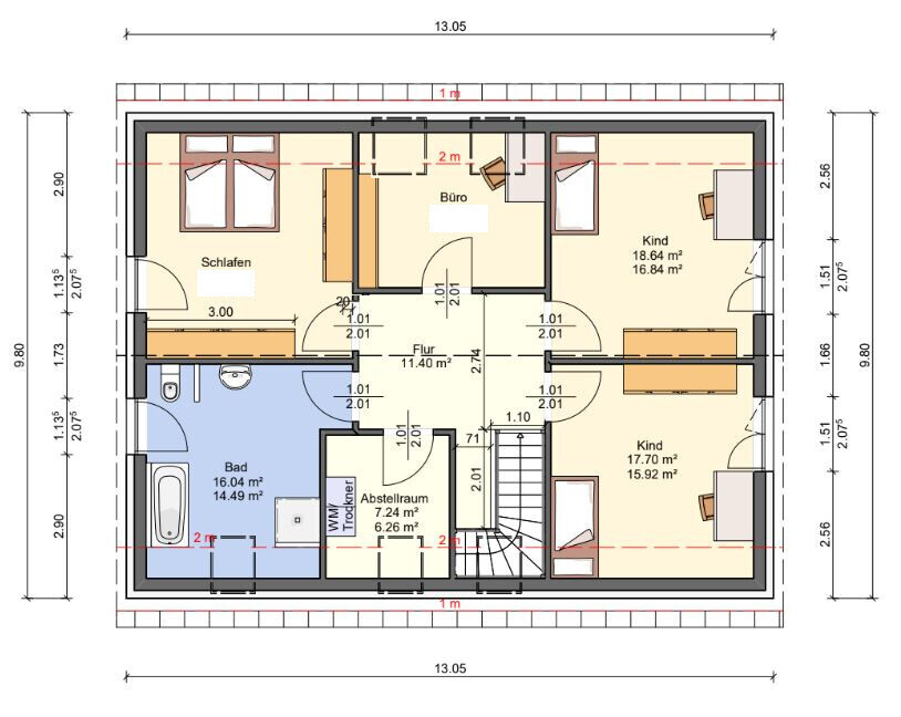

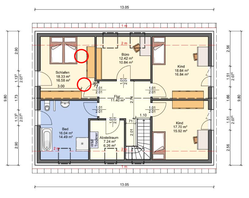

There are also tight spots upstairs—marked in red.
I would reduce the office by 20 cm (8 inches). You don’t really need that space there, and it would help ease the situation with the wardrobe next to the bed and the entrance in the bedroom. The wall offset doesn’t look good anyway. I definitely wouldn’t make the bedroom door any narrower.

We have a similar “corridor” in our living-kitchen area, and I already find our 2.6m (8 ft 6 in) clear ceiling height borderline. Friends have 2.75m (9 ft) and I find that noticeably more spacious and comfortable. If the rooms are somehow broken up or arranged in an L-shape, that’s certainly different, but I really think 2.5m (8 ft 2 in) is too low.
2.07m (6 ft 9.5 in) window heights—is that the top edge of the window opening? If so, that’s quite low. We have about 2.20m (7 ft 3 in) and I would still prefer it to be higher.
I also expect the sofa to be placed right in front of the window since the room width won’t allow positioning it further into the room. Thanks for your feedback. We didn’t make the decision lightly but have settled on 2.5m (8 ft 2 in). I had the chance to see a house with 2.75m (9 ft) ceilings on the ground floor and 2.5m (8 ft 2 in) upstairs. The 2.5m works for us, and we save on the additional costs.
Chrisi19068 Jun 2020 12:21Würfel* schrieb:
Look at these 3 spots – it won’t work as planned. The distance between the island and the countertop is about 80 cm (31.5 inches), the walkways are 60–70 cm (23.6–27.6 inches). That’s all way too tight. I already suggested a solution to fix this.

There are also tight spots on the upper floor – marked in red.
[ATTACH alt="1591609698486.png"]47824[/ATTACH]
I would reduce the office by 20 cm (8 inches). You don’t really need that much space there, and in the bedroom it would ease the situation with the wardrobe next to the bed and the entrance. The wall offset doesn’t look good anyway. I wouldn’t make the bedroom door any narrower under any circumstances.
[ATTACH alt="1591609747711.png"]47825[/ATTACH] First of all, thanks for your feedback.

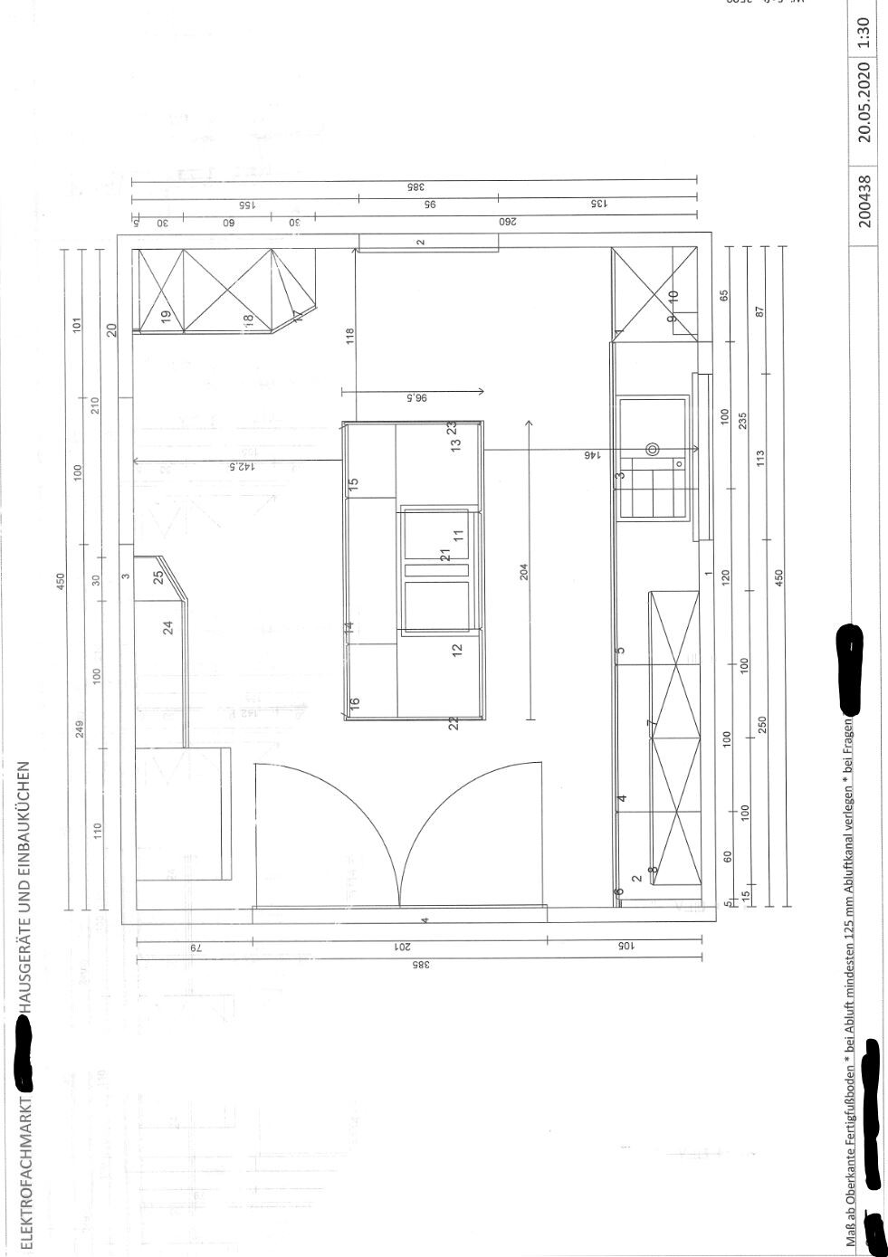

Unfortunately, the kitchen wasn’t drawn perfectly, so it looks narrower in parts. That’s why I’ve included a detailed view below. The distance between the kitchen island and the countertop is actually 86 cm (34 inches), which is a bit tight. I’ll note that and discuss it again with the kitchen planner when finalizing the layout.
Regarding the office: I didn’t want to reduce its size further, but I’m considering it now. The corner on the floor plan bothers me as well. But as you mentioned, it would also improve the bedroom situation with the wardrobe next to the bed.
