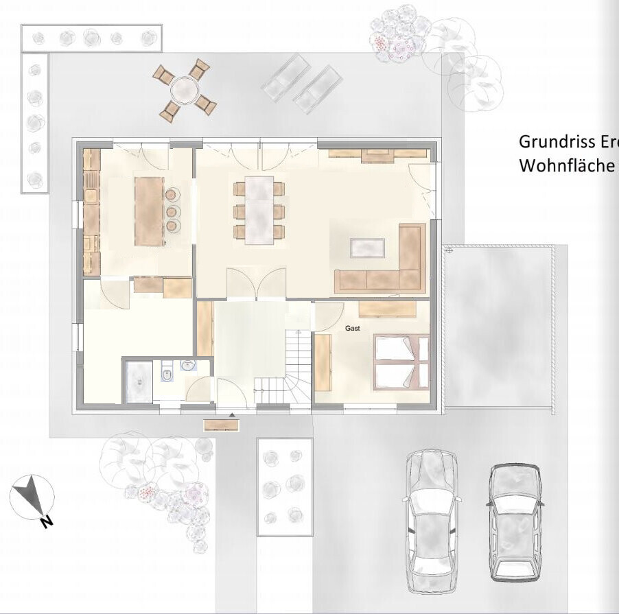

Chrisi1906
6 May 2020 16:13
kaho674 schrieb:
It would be quite easy to enlarge the guest bathroom in these sketches as well and additionally enjoy the advantage of a bigger living room. This isn’t brain surgery, just adapting the two rooms as requested. But okay, if you don’t want to.
Also, your kitchen island as drawn is quite pointless, right? How long is that 1.20m (4 feet)? Has it already been painted? If so, it’s best to just erase it immediately to avoid confusing everyone repeatedly.
Patio doors behind the sofa are also a bad idea.
That gigantic bathroom is simply ridiculous as it is now. So either add a sauna, a hot tub, or something else. At a minimum, a walk-in shower and a double vanity sink should be standard here. The fact that you still run into a wall when entering, even though this is like a ballroom, is really baffling.
We still want to discuss the kitchen with a kitchen planner. The same goes for the bathroom. The planner has again included standard toilet units even though I wanted something different. I guess I can’t change that? My only concern is that it might get too expensive.
I’ll comment on the floor plan again.
- Guest room doesn’t have enough space for the bed with two wardrobes
- Hallway is okay
- Utility room also not accessible from the hallway!
- Bathroom a bit small and especially too narrow!
- I would prefer the living room built-in wall on the other side. The distance between the sofa and TV is too big.
- Dining area is great!
- Kitchen is also very good with the kitchen island

kaho6746 May 2020 16:58
I’ll respond:
Chrisi1906 schrieb:
- Guest room too small with two wardrobes around the bed
Rotate the bed. Adjust the window.
Chrisi1906 schrieb:
- Utility room not accessible from the hallway either!
Just like it is now.
Make it wider. There’s enough space. You still have a utility room upstairs.
Chrisi1906 schrieb:
- Would prefer the living room feature wall on the other side.
Then just rotate the furniture 180°, although it looks much better as shown!
Chrisi1906 schrieb:
Distance between sofa and TV too large.
Too large isn’t an option. Just buy a bigger TV!
Chrisi1906 schrieb:
- Dining area top notch!
Absolutely fantastic.
Chrisi1906 schrieb:
- Kitchen also very good with the cooking island
Definitely better and still has potential for further development.

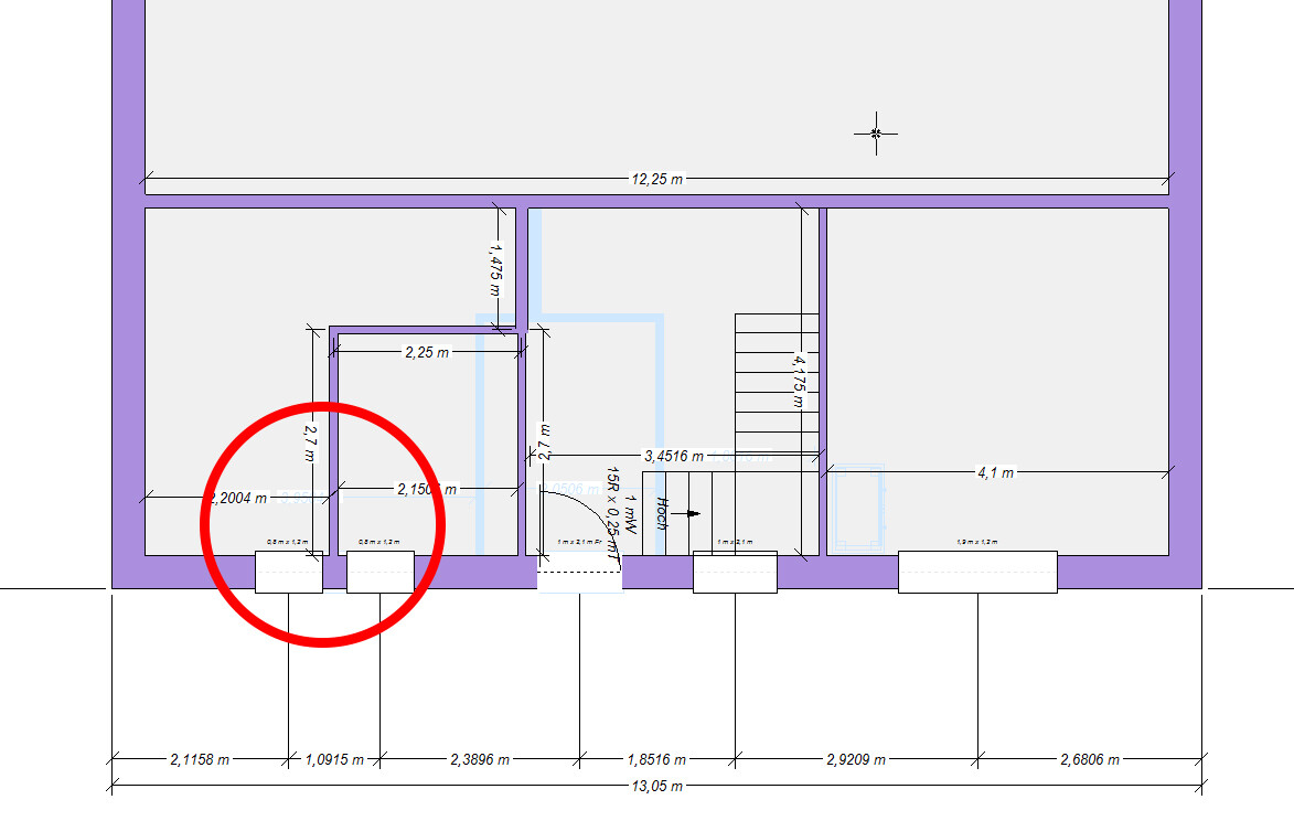

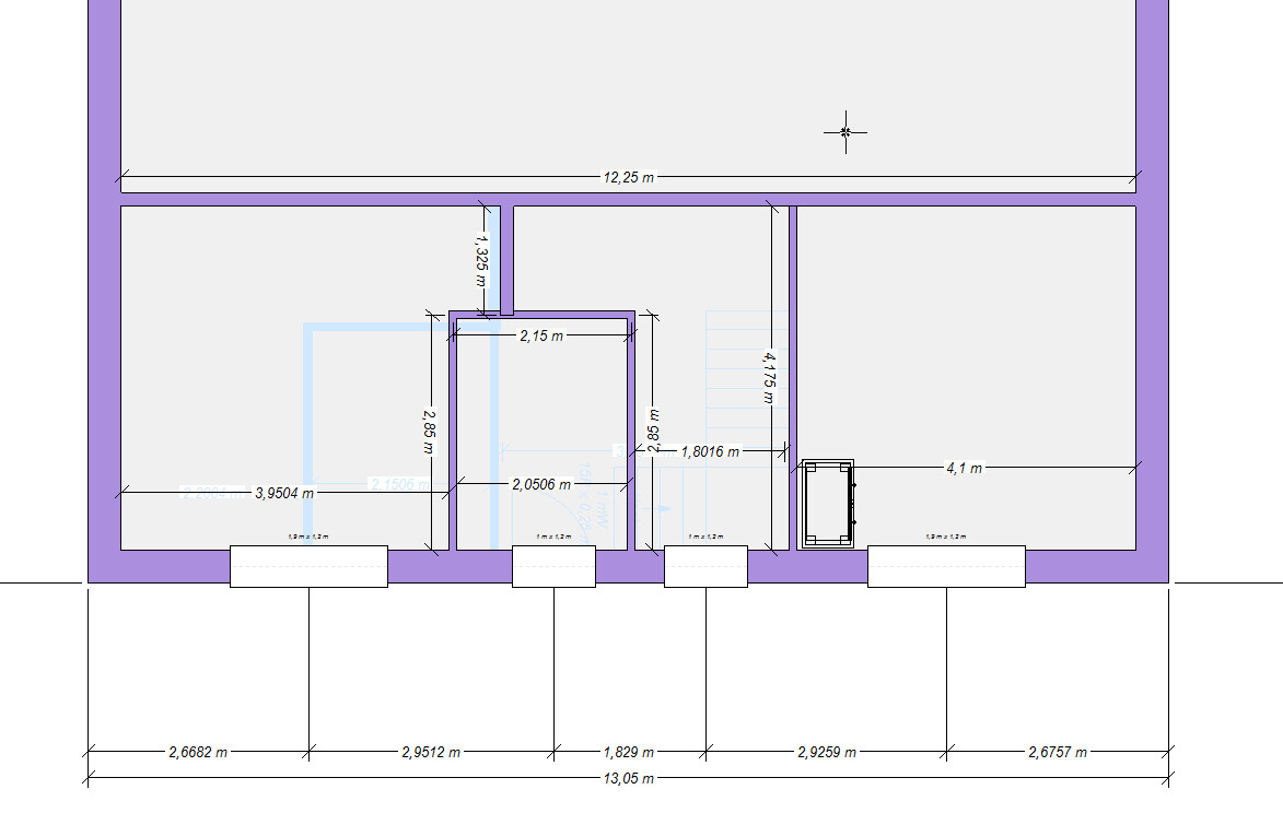

Chrisi1906
6 May 2020 19:26
kaho674 schrieb:
Okay, I switched on the automatic dimensioning for once—normally I don’t do that. But at least this gives you an approximate position of the windows. Unfortunately, the measurements often have up to four decimal places and aren’t 100% accurate. You’ll have to adjust and simply round those yourself. I had to move one wall by a few centimeters (cm) (inches)—see the red circle. It might be an option to replace the floor-to-ceiling window at the staircase on the ground floor with a regular window at sill height. Both options are possible.
It’s not set in stone either. Maybe someone else has some tips on improving the design?
Well done. Thanks for that. Is there any way to nicely design the front if, instead of the window/light strip next to the front door, you put a strip of glass? So the front door would have an integrated glass strip on the right side.
kaho674 schrieb:
I’ll comment back:
I’m also replying. I agree with you on one point: the size of the bathroom on the upper floor. It bothers me as well because it will probably become quite expensive. I’d be very grateful if you could help me with that.
The bed would then be below the window? How is that supposed to work?
kaho674 schrieb:
Exactly as it is now.
Exactly, so no advantage.
kaho674 schrieb:
Make it thicker. There’s enough space. You still have a utility room upstairs.
The architect always assumed at least 2.3m (7 feet 7 inches) width/length for the utility room in all drawings. I don’t see any advantage in placing the guest toilet “in front” of the utility room if you still have to walk through the kitchen.
kaho674 schrieb:
Then just rotate the furniture 180°, even though it looks much nicer as drawn!
Matter of taste!
kaho674 schrieb:
Too big is not an option. Buy a bigger TV!
Our TV is 65" and I find the distance in our rental apartment slightly too large. It’s about 4.8m (16 feet) from the TV wall to the back edge of the couch.
kaho674 schrieb:
Definitely better and still can be developed further.
We’re still planning the kitchen.

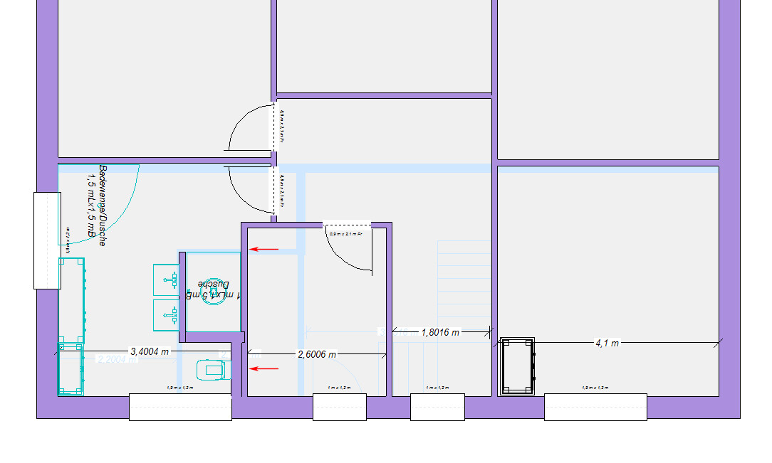

kaho6746 May 2020 21:00
Chrisi1906 schrieb:
Well done. Thanks for that. Is there still a way to nicely design the front if, instead of a window / strip of windows next to the front door, you make a strip of glass? So the front door would then have an integrated glass strip on the right side.
So, a side panel? How wide? Can the window still be included?
Chrisi1906 schrieb:
… the size of the bathroom on the upper floor. It bothers me too because it will probably be quite expensive. If you could help me with that, I would be very grateful.
Well, I can’t lend you money if that’s what you mean.
I would make the bathroom a bit narrower and enlarge the utility room instead. (Just move the wall in between.) Then you have a nice space in the utility room for handling tasks, ironing a shirt, and also storing Christmas decorations. The bathroom will be a little smaller but at 14.68m² (158 ft²) it is still in the high-end range. Add cabinets and a generous layout, and you won’t feel like you’re in a gym hall anymore. However, this doesn’t offer huge savings. So start looking for affordable tiles already!

Chrisi1906
7 May 2020 05:51
kaho674 schrieb:
So, a side section? How wide? Will the window still fit?
It should be 30cm (12 inches) wide. Remove the window.
kaho674 schrieb:
I can’t lend you money, if that’s what you mean.
I would make the bathroom slightly smaller and enlarge the utility room instead. (Just move the wall between them.) That way, the utility room can be used comfortably, for example, ironing a shirt and also storing Christmas decorations. The bathroom will be a bit smaller but with 14.68m² (158 sq ft) it’s still quite generous. Add some cabinets and a well-thought-out layout, and it won’t feel like a gym hall anymore. However, this doesn’t create a huge potential for savings. So start looking for affordable tiles already!
More money only if I don’t have to pay it back.
Thanks for the solution with the bathroom and storage room. I like that, and we could save a few euros this way. We don’t need expensive tiles, but even normal good ones are supposed to be costly with the bathroom planner. If we make the storage room that big, my wife will be happy.
