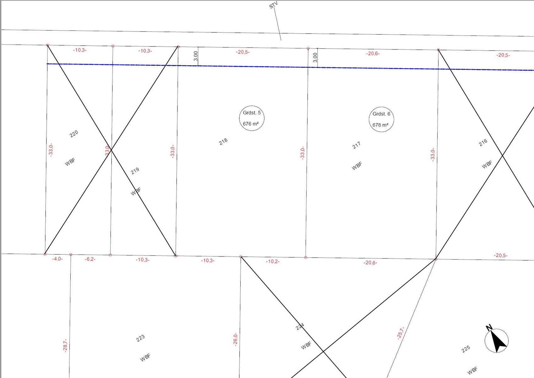

At our developer, a customer who had reserved a plot of land dropped out. Since the other plot faces south / southwest, we didn’t hesitate long and switched to that plot. The new plot is smaller, so we gave up on our bungalow dream. The plot number is 5.
To remind you: The plot is tied to the developer.

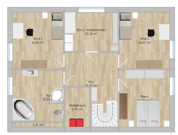

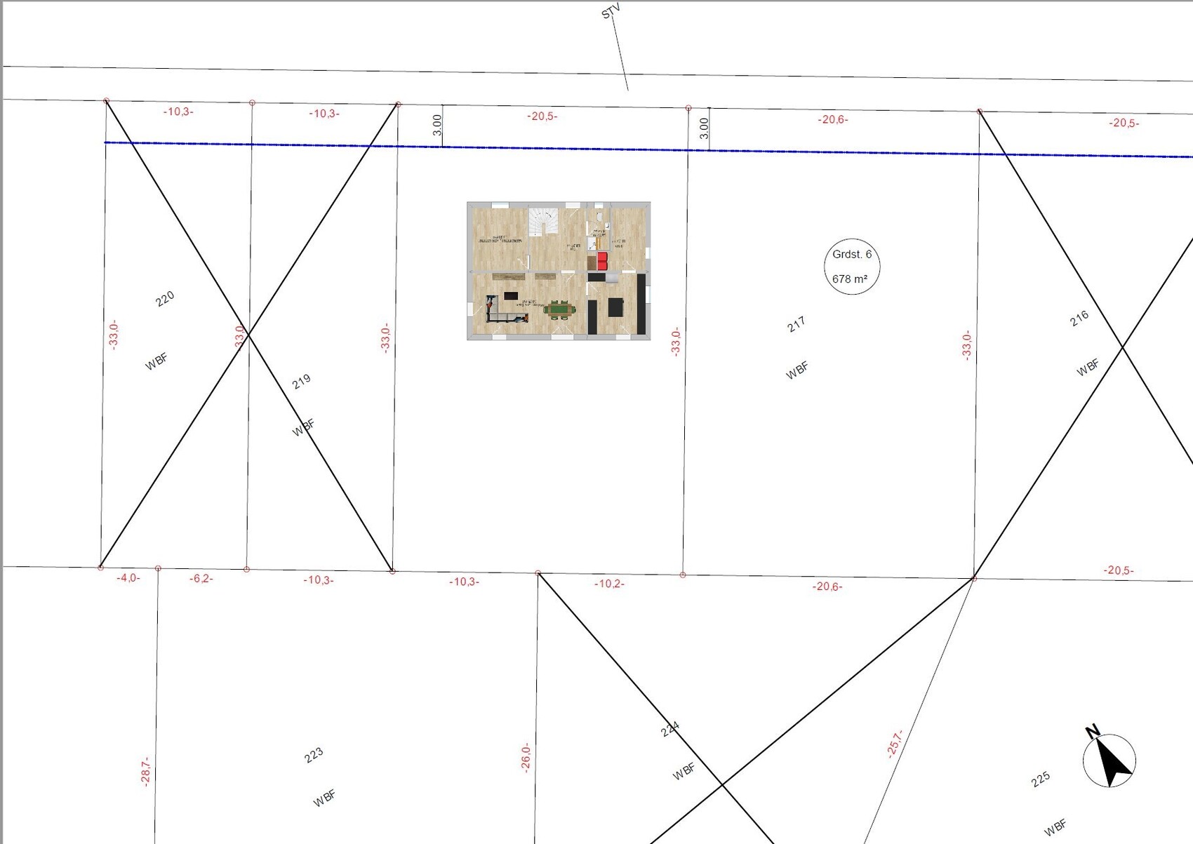

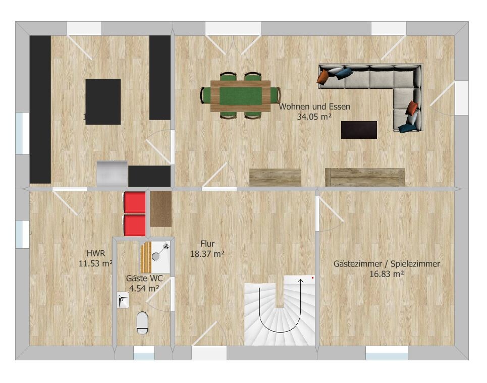

I have been thinking over the past few days about the arrangement and design of the rooms and the plot, and I would first like to know if the concept is okay. I am not concerned with details inside the rooms such as windows, doors, or bathroom design. That’s not possible anyway since I created the floor plan myself based on Gussek Haus floor plans. However, I tried to design it as well as possible. For this reason, I want to share the floor plan here for discussion. I’m mainly looking for feedback on the layout and room arrangement, as well as ideas, suggestions, or tips. Maybe you’ll also spot things that “just don’t work” or are not practical for everyday living.
I created the floor plan with RoomSketcher, but only used the free version, so many features are limited. Please ignore the room dimensions on the upper floor. There is a dormer in the area of the home office.

Plot size: 676m²
Slope: NO
Site coverage ratio: 0.4 (allowed exceedance 25 out of 100)
Floor area ratio: 0.6
Building envelope, building line, and boundaries: On the north side / south side approx. 20.5 m (67 feet) wide, west and east sides approx. 33 m (108 feet) wide, 3 m (10 feet) building setback on each side, rectangular plot, clearly visible in the pictures
Edge construction setback: 3 m (10 feet)
Number of parking spaces: no requirement
Number of stories: maximum 2 full stories
Roof style: Gable roof, hipped roof

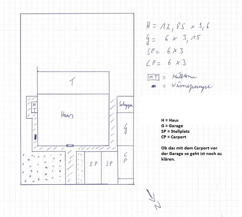

Other requirements: Garage must be 5 m (16 feet) from the property boundary. Garage on the west side because the curb is lowered there.

Ground floor: Living/dining/kitchen area, utility room, guest WC with shower, hallway with coat area and stairs to upper floor, guest room / playroom
Upper floor: Master bedroom, 2 children’s rooms, bathroom, storage room, office

Garage, carport: Space for 2 cars is required, preferably 3 to 4. Currently considering a garage (3 x 6 m / 9.8 x 19.7 feet) with a carport (3.6 m / 12 feet) in front, not sure if that works. Plus 2 parking spaces in front of the house.

I would install a large window from the staircase up to the upper floor, as the hallway upstairs would otherwise be dark.

Wasn’t the door from the kitchen to the utility room an absolute no-go? Now it’s in anyway. I would reconsider the design by Würfel from #88. Much nicer living room.

Wasn’t the door from the kitchen to the utility room considered an absolute no-go? But now it’s there. I would reconsider Würfel’s design from #88. Much nicer living room.
If we had the wall dimensions instead of just the window sizes, it would be easier to help you with the window placement on the front. But for that, you really need to know exactly where the walls are.

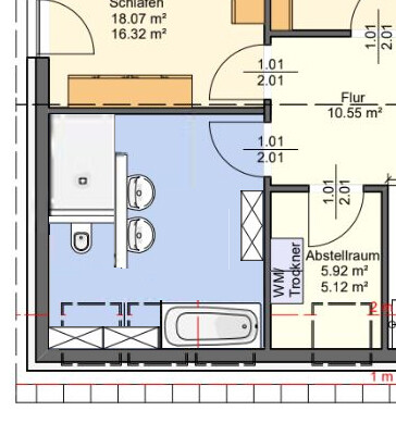

The door from the kitchen to the utility room is intentional because it allows for a larger guest toilet. In the other sketches, the guest toilet was smaller.
