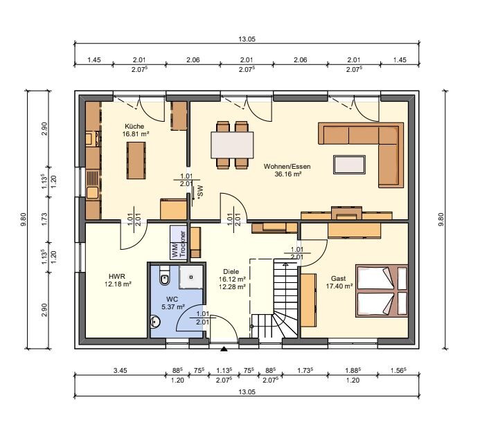

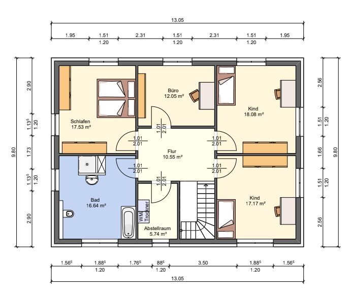

At our developer, a customer who had reserved a plot of land dropped out. Since the other plot faces south / southwest, we didn’t hesitate long and switched to that plot. The new plot is smaller, so we gave up on our bungalow dream. The plot number is 5.
To remind you: The plot is tied to the developer.
I have been thinking over the past few days about the arrangement and design of the rooms and the plot, and I would first like to know if the concept is okay. I am not concerned with details inside the rooms such as windows, doors, or bathroom design. That’s not possible anyway since I created the floor plan myself based on Gussek Haus floor plans. However, I tried to design it as well as possible. For this reason, I want to share the floor plan here for discussion. I’m mainly looking for feedback on the layout and room arrangement, as well as ideas, suggestions, or tips. Maybe you’ll also spot things that “just don’t work” or are not practical for everyday living.
I created the floor plan with RoomSketcher, but only used the free version, so many features are limited. Please ignore the room dimensions on the upper floor. There is a dormer in the area of the home office.
A few more details about the house.
Roof pitch 38°
Knee wall (Drempel) 100cm (39 inches)
External dimensions 12.85 x 9.60 m (42.2 x 31.5 feet) (enlarged, original dimensions of Gussek Haus models are smaller)
Unfortunately, I cannot show internal room dimensions because RoomSketcher does not allow it.
Plot size: 676m²
Slope: NO
Site coverage ratio: 0.4 (allowed exceedance 25 out of 100)
Floor area ratio: 0.6
Building envelope, building line, and boundaries: On the north side / south side approx. 20.5 m (67 feet) wide, west and east sides approx. 33 m (108 feet) wide, 3 m (10 feet) building setback on each side, rectangular plot, clearly visible in the pictures
Edge construction setback: 3 m (10 feet)
Number of parking spaces: no requirement
Number of stories: maximum 2 full stories
Roof style: Gable roof, hipped roof
Other requirements: Garage must be 5 m (16 feet) from the property boundary. Garage on the west side because the curb is lowered there.
Homeowners’ Requirements
Architectural style, roof type, building type: Doesn’t matter, initially considered a house with a gable roof, there is a dormer in the home office area
Basement, number of floors: No basement due to high groundwater level
Number of occupants, ages: 4 people aged 36 (female), 37 (male), 3 (child), 1 (child)
Space requirements on ground floor and upper floor:
Ground floor: Living/dining/kitchen area, utility room, guest WC with shower, hallway with coat area and stairs to upper floor, guest room / playroom
Upper floor: Master bedroom, 2 children’s rooms, bathroom, storage room, office
Office use: Family use or home office? Home office combined with family use
Guests per year: 1–2 times
Open or closed architecture: Closed architecture?
Conservative or modern style: A mix of both
Open kitchen, kitchen island: Closed kitchen with island would be nice but not a must; open kitchen is also an option
Number of dining seats: 4, with the option for 6
Fireplace: No
Music / stereo wall: Sound system in the living room
Balcony, roof terrace: No
Garage, carport: Space for 2 cars is required, preferably 3 to 4. Currently considering a garage (3 x 6 m / 9.8 x 19.7 feet) with a carport (3.6 m / 12 feet) in front, not sure if that works. Plus 2 parking spaces in front of the house.
Additional wishes / special features / daily routine, including reasons why certain things should or shouldn’t be:
Who created the design:
- DIY - copy and combination of Gussek Haus models Lindenallee, Kiefernallee variant 1, and Buchenallee variant 2
What do you especially like? Why?
- Large closed kitchen with island and direct / short access to the terrace
- Living room close to the terrace
- Guest / playroom on the ground floor
- Storage room on the upper floor with washing machine and dryer
- Utility room with washing machine and dryer (yes, twice)
- 6 rooms
- Layout of rooms on the upper floor
What do you not like? Why?
- Location of the home office on the upper floor is not ideal in my view, but I could live with it
Price estimate from architect/planner: No new estimate so far
Personal price limit for house including features: 400,000
Preferred heating system: Heat pump
Why does the design look like it does now? For example:
Copy-paste of Gussek Haus models Lindenallee, Kiefernallee variant 1, and Buchenallee variant 2
What is the most important fundamental question about the floor plan summarized in 130 characters?
Is the room layout okay?

It wouldn’t be my house either. Basically, the room sizes are quite generous (17m2 (183 sq ft) guest room, 17m2 (183 sq ft) bathroom), but otherwise it somehow lacks the charm of a Flair 113. I would trade some of the (room) size for features like dormers, a gable window, more window area, and so on.
Curly schrieb:
Who needs a window that can be opened right next to the stair steps? You could easily trip over it coming down from above if you’re not careful, or bump into it coming up from below.
SabineI would install fixed glazing there; you really never need to open it.C
Chrisi190628 Apr 2020 15:22RomeoZwo schrieb:
It wouldn’t be my house either. Basically, it’s very spacious in terms of room sizes (17m2 (183 sq ft) guest room, 17m2 (183 sq ft) bathroom) but somehow lacks the charm of a Flair 113. I would trade off (room) size for a dormer, gable window, more window area, etc. We don’t want too much window area. I have to admit that I find the number of windows in most show homes excessive.
Chrisi1906 schrieb:
We don’t want too much window area. I have to admit that I find the number of windows in most show homes to be excessive. Then everything is fine, as long as you like it.
Sabine

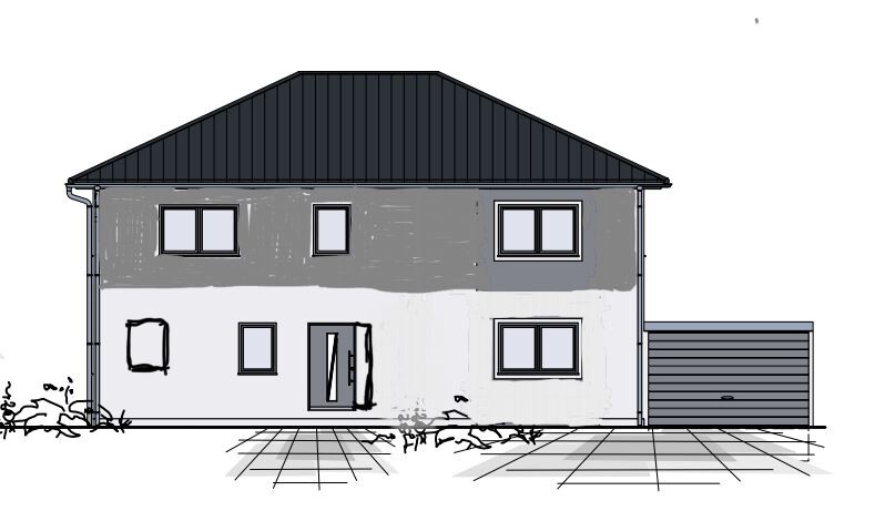

Chrisi19066 May 2020 14:0611ant schrieb:
Nothing changes for the ground floor. Thanks to the “knee wall” raised to full height in the attic, you can assign a bit more space to storage purposes in the upper floor – which you roughly lose again due to the shallower roof space. Overall, it’s a zero-sum game, no win but no loss. Nothing to complain about there.
Quite the opposite. This is exactly what gives you a townhouse where others only have a “one-and-a-half” house. If you want a villa, this is an advantage – if you want a normal suburban house, a standard plain design is better. The developer told me that the townhouse with two full stories costs less than €5000 (around $5300) more than a one-and-a-half story house with a gable roof (even with a hip roof design). The attic windows alone have an MSRP of about €2500 (around $2650) each. Since we need four of those, I’d rather go with the townhouse. However, I feel like the floor plan fits the one-and-a-half story house better. My reason is the front elevation of the house. Maybe I’m just confused.
I gave some thought to the arrangement of the windows (just for the front, since the rest is quite straightforward) in the townhouse, and this is what I came up with. Please ignore the windows shown in the ground and upper floor plans, as some adjustments would be necessary.
How would you position the windows?
Alessandro6 May 2020 14:15Just don’t forget the laundry chute from the upstairs bathroom to the utility room!
