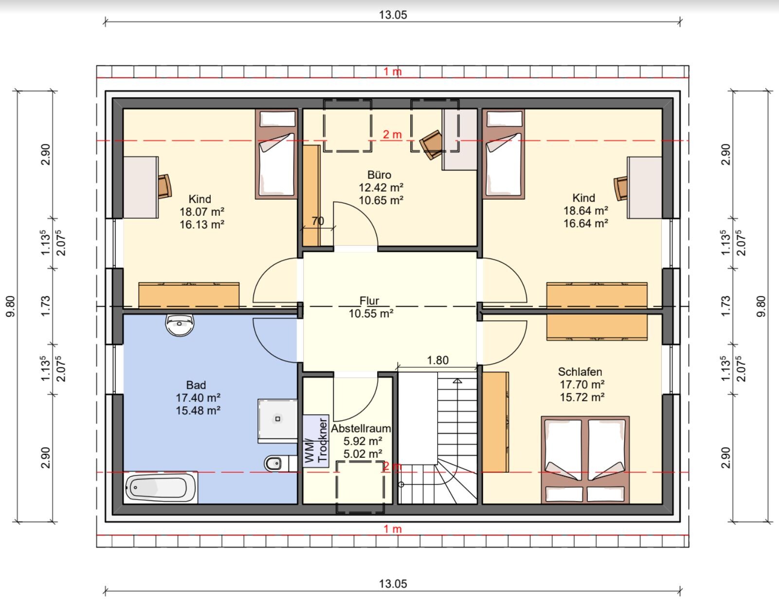

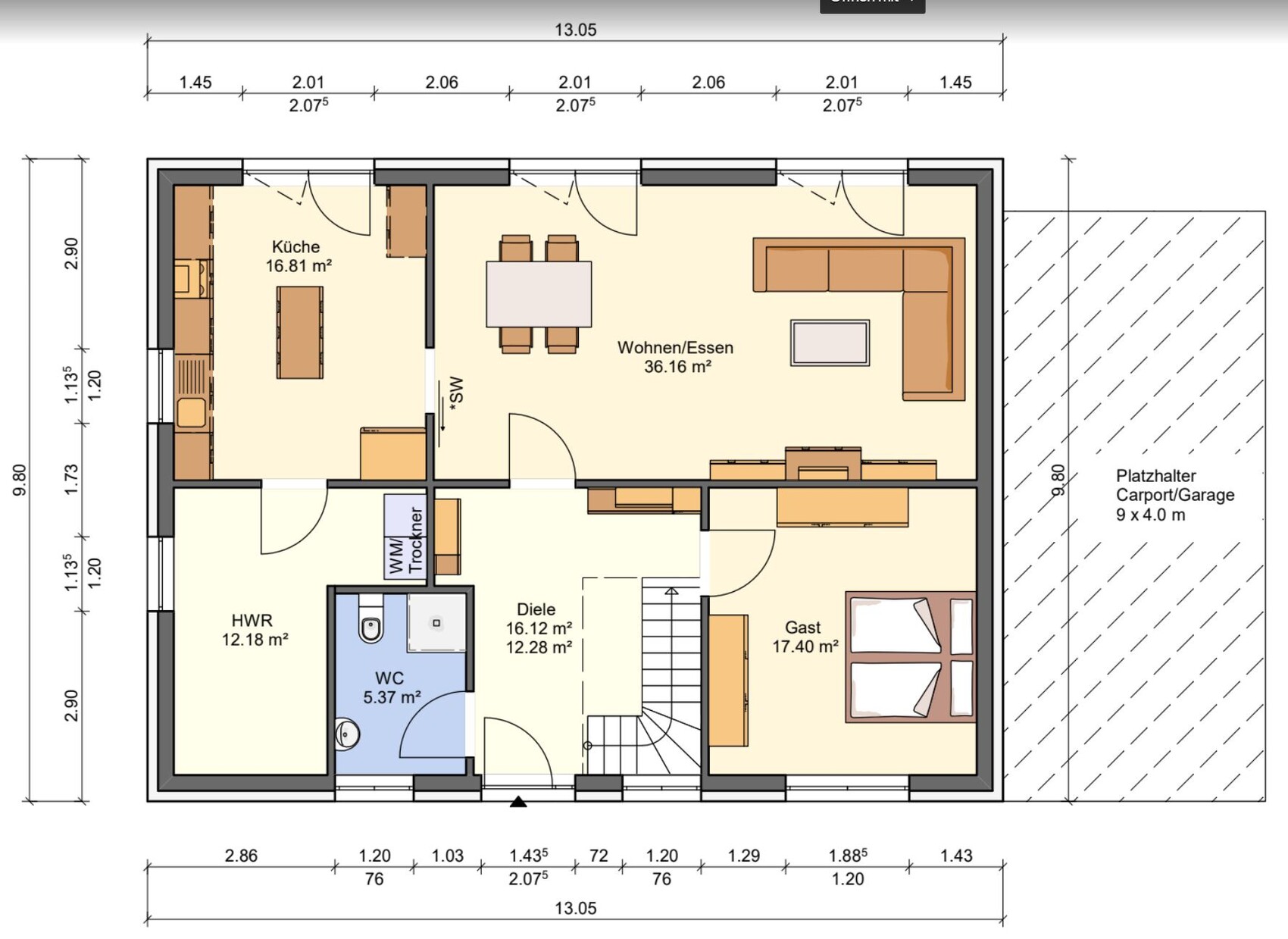

Attached is the latest draft from the planner.
On the ground floor, the utility room is accessible again through the kitchen. This was deliberately chosen to allow for a slightly larger guest toilet. Kitchen planning is still pending, and the same applies to the bathroom layout. Unfortunately, the planner has once again included his standard bathroom furniture in the floor plan, which is not desired. I will address this again.
On the upper floor, we have returned to the original deep-sill windows because they allow for better furniture placement.

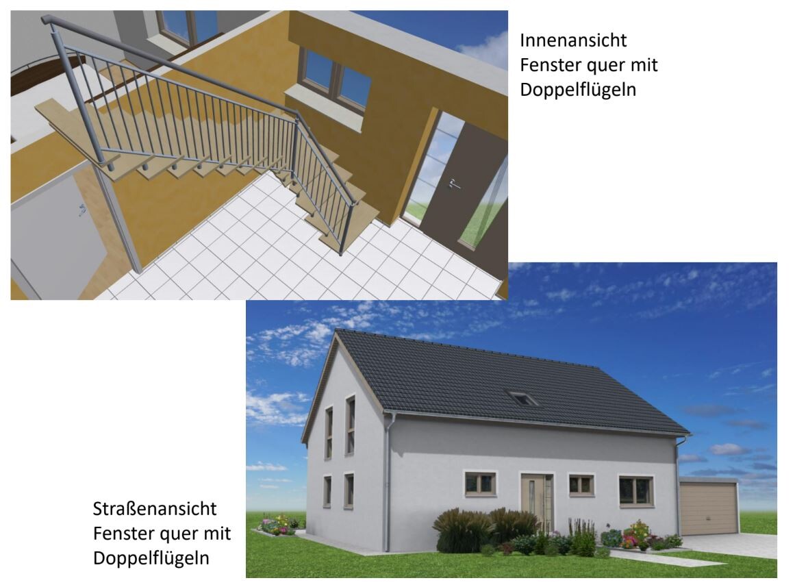

Question: What do you think of the windows on the front of the house? Specifically, the two horizontal windows designed as double casement windows?
The advantage of horizontal windows is that the casement sashes can be fully opened without issues if they are designed as double casement windows. If it is not a double casement, the sash hits step edges or stair railings, causing the same problem. I hope this explanation is clear. The 3D views of the street and interior elevations support the visual understanding.
If the windows in the hallway are vertical, they would need to be shifted toward the front door so that the bottom edge of the window is above the fifth stair step; otherwise, the casement cannot be opened. However, this also creates gaps between the stair step and the bottom edge of the window.

What do you think about the windows on the front of the house? I mean the two horizontal double casement windows.
Curly
28 Apr 2020 14:37
Chrisi1906 schrieb:
What do you think about the windows on the front of the house? I mean the two horizontal windows with double sashes,
small, old-fashioned, suitable for cannon barrels. Upstairs in the hallway everything is dark, and in the living room the windows are so low that taller people have to duck. How high will your ceilings be? Are they that low?
