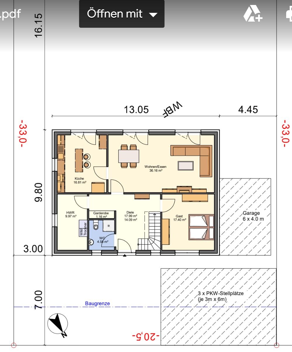

At our developer, a customer who had reserved a plot of land dropped out. Since the other plot faces south / southwest, we didn’t hesitate long and switched to that plot. The new plot is smaller, so we gave up on our bungalow dream. The plot number is 5.
To remind you: The plot is tied to the developer.
I have been thinking over the past few days about the arrangement and design of the rooms and the plot, and I would first like to know if the concept is okay. I am not concerned with details inside the rooms such as windows, doors, or bathroom design. That’s not possible anyway since I created the floor plan myself based on Gussek Haus floor plans. However, I tried to design it as well as possible. For this reason, I want to share the floor plan here for discussion. I’m mainly looking for feedback on the layout and room arrangement, as well as ideas, suggestions, or tips. Maybe you’ll also spot things that “just don’t work” or are not practical for everyday living.
I created the floor plan with RoomSketcher, but only used the free version, so many features are limited. Please ignore the room dimensions on the upper floor. There is a dormer in the area of the home office.
A few more details about the house.
Roof pitch 38°
Knee wall (Drempel) 100cm (39 inches)
External dimensions 12.85 x 9.60 m (42.2 x 31.5 feet) (enlarged, original dimensions of Gussek Haus models are smaller)
Unfortunately, I cannot show internal room dimensions because RoomSketcher does not allow it.
Plot size: 676m²
Slope: NO
Site coverage ratio: 0.4 (allowed exceedance 25 out of 100)
Floor area ratio: 0.6
Building envelope, building line, and boundaries: On the north side / south side approx. 20.5 m (67 feet) wide, west and east sides approx. 33 m (108 feet) wide, 3 m (10 feet) building setback on each side, rectangular plot, clearly visible in the pictures
Edge construction setback: 3 m (10 feet)
Number of parking spaces: no requirement
Number of stories: maximum 2 full stories
Roof style: Gable roof, hipped roof
Other requirements: Garage must be 5 m (16 feet) from the property boundary. Garage on the west side because the curb is lowered there.

What is the most important fundamental question about the floor plan summarized in 130 characters?
Is the room layout okay?

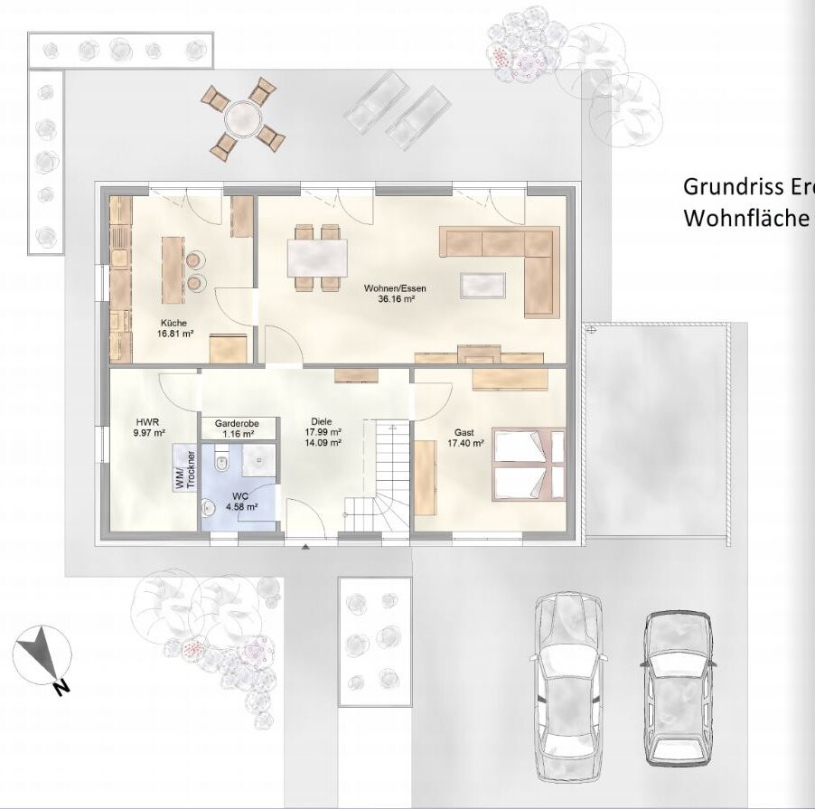

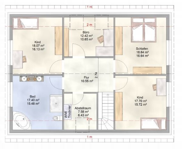

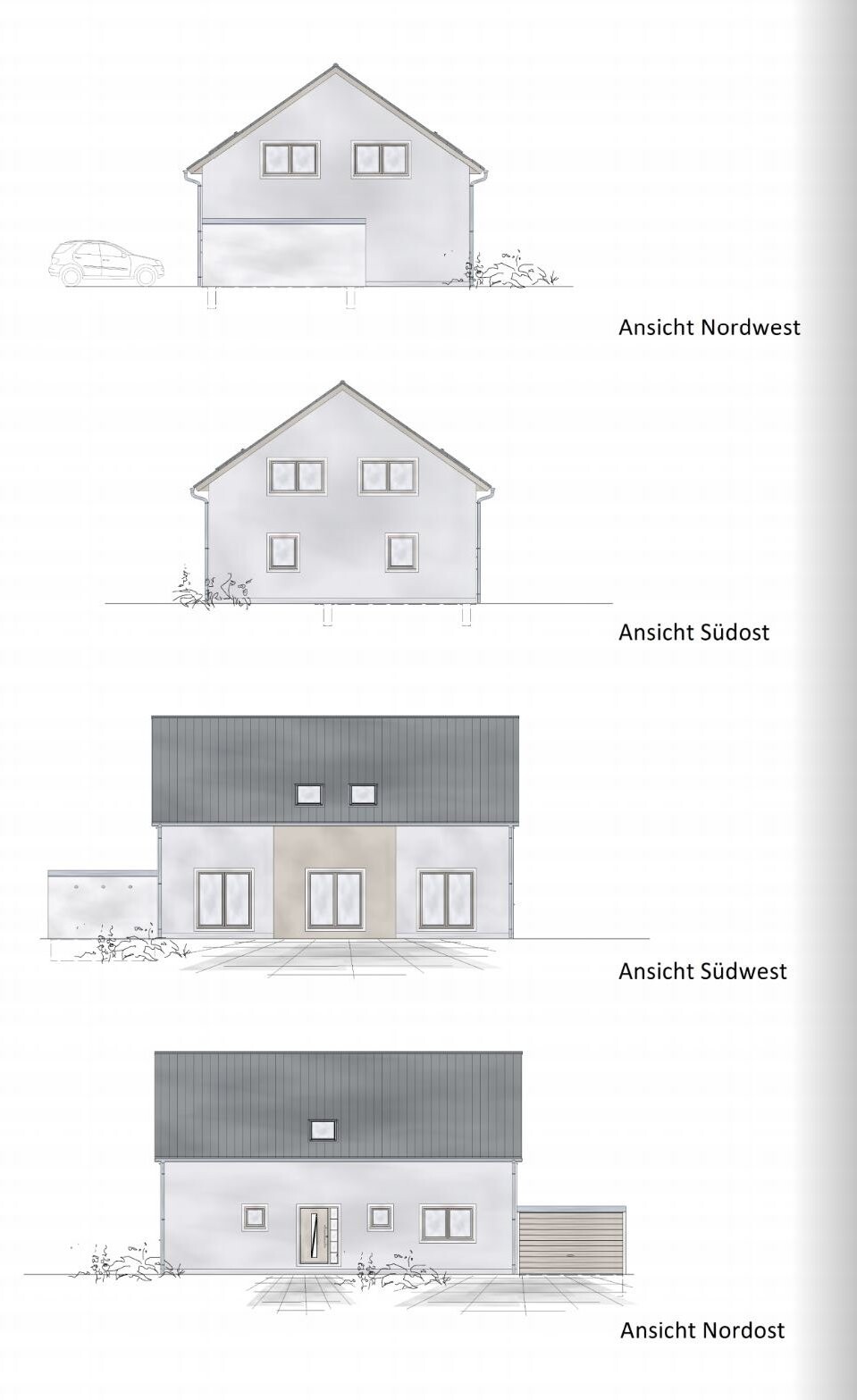

Chrisi190621 Apr 2020 06:47Attached is the floor plan from the designer. The house dimensions are now 13.05m x 9.80m (43ft x 32ft) with a knee wall height of 130cm (51 inches). On the ground floor, we have about 100sqm (1,076 sq ft), and the upper floor covers 92sqm (990 sq ft). I had the windows on the gable ends of the upper floor changed because the distance to the neighbor is quite small. Depending on the neighbor’s house, it ranges from 6 to a maximum of 10m (20 to 33 ft), so I find floor-to-ceiling windows impractical there.
Instead of a roof window in the hallway on the upper floor, the designer has now placed a small window on the ground floor by the staircase. This naturally lets less light into the hallway upstairs, but the window is much easier to clean and to open and close. YPG said I should make the window quite large. I still think it’s too small—what do you think?
In the attic, the children’s room and bedroom on the right side have been swapped. The designer gave the parents’ bedroom the larger space.
I would still discuss the kitchen and bathroom with a kitchen supplier or bathroom fitter.
The cloakroom should now be sufficient for 4 people, with storage space along the wall towards the living room, storage under the stairs, and space behind the guest bathroom.
The hallway area on the ground and upper floors now totals 24.64sqm (265 sq ft) and makes up 12.83% of the total living area.
I’m interested in your opinions. Are there any mistakes? Comments? Feedback?
Thank you very much!

Ground Floor:
I would plan the sofa against the wall facing the guest room and definitely add a window on the west side.
I would align the door to the living area (on the left) with the front door and the patio door. For this, consider making the living area door a sliding door that runs to the left along the hallway. This way, it can easily remain open without getting in the way. It could be an attractive glass door.
Between the dining area and kitchen, I would also plan a sliding door that slides downwards from the dining room side. This could make it possible to include a small island in the kitchen, which is difficult with the door placement, especially since the door will likely often be in the traffic path.
Upper Floor:
For the children’s bedrooms, I would probably add a skylight on the left or right side of each bed.
In the bathroom, possibly the same, and make the other window single-leaf, so that there might be space for a shower between the window and the wall next to the children’s room. I’m not a big fan of showers right next to the bathroom entrance.
Overall, I think the general layout works quite well as it is.

Solid construction – somewhat old-fashioned in places and a bit wasteful here and there. For example, I would consider the bathroom to be very large.
I definitely wouldn’t let anyone reduce the lighting in the upstairs hallway. On the contrary, I would go all out. The sloped roof windows clean themselves with every rain. The tiny little thing on the ground floor, added by the planner, you can consider a joke. Let the sunlight in! When you then enter the nice, large hallway upstairs, you immediately feel good.
