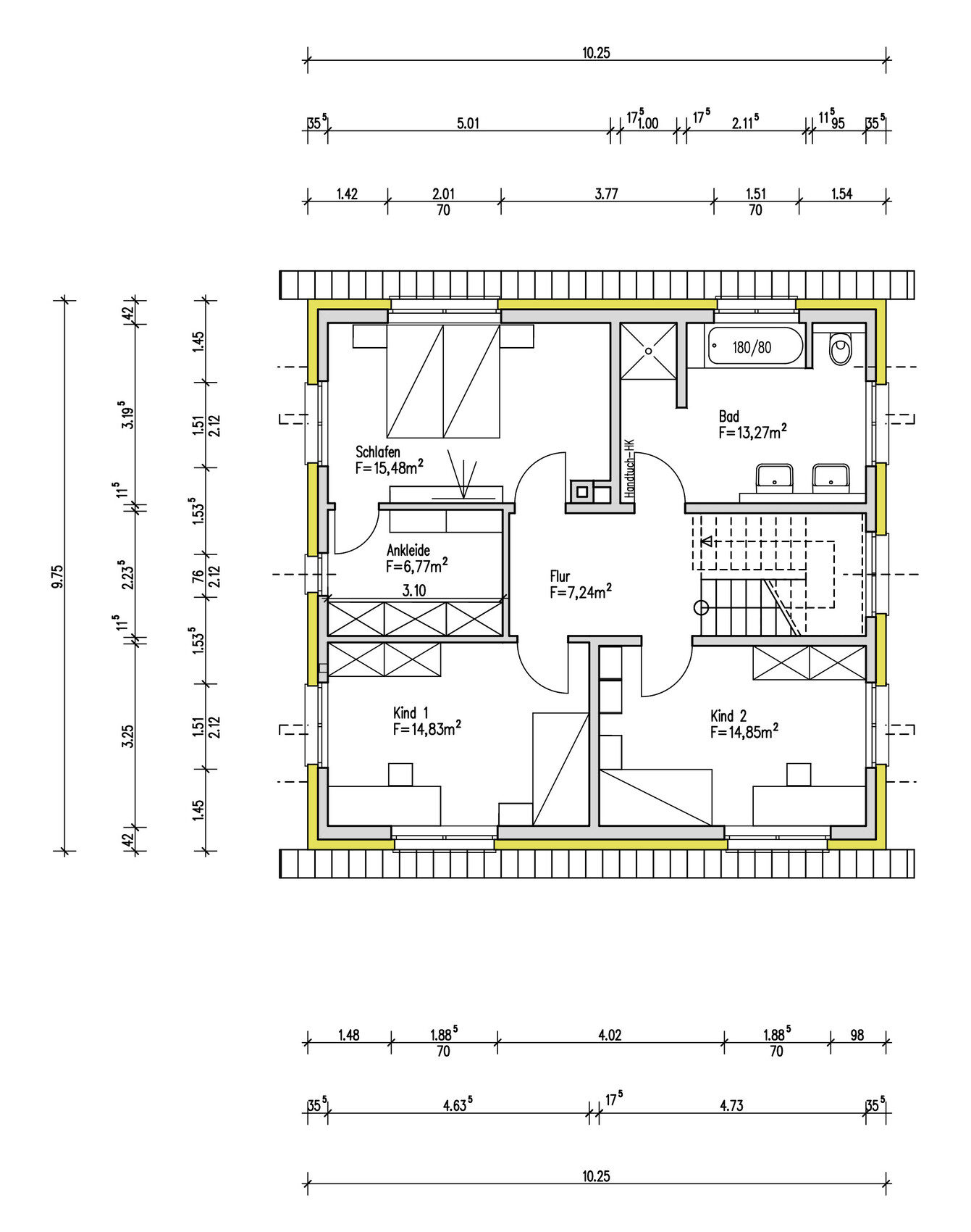

we received a revised draft from our construction company. Foreword: some of you might remember the previous drafts of the single-family house with 140 m² (1507 sq ft) plus a basement designed for living. It is a sloped plot going from southwest to northwest, facing north, with a slope from southwest to northeast.
We have now planned the house with a 2.30-meter (7.5 ft) knee wall, which allows the upper rooms to have 70 cm (28 inches) high clerestory windows, so the front children's rooms still get sunlight from the southwest. We like this type of window, but it currently makes furnishing the children’s rooms a bit tricky. We had seen this at model home parks, and most of the time there was a desk placed underneath. Regarding the doors to the children’s rooms, Foreword: check if they could be planned flush with the wall. At the moment, I don’t see much benefit to having extra space behind the door, do you? A cupboard wouldn’t fit there anyway. Otherwise, the upper floor plan works for us. Foreword: the clerestory window above the bathtub should be larger, matching the size of the bathtub.
We still need to adjust the elevations as we’re not 100% happy with them yet. The question is whether it’s better to have full-height windows in the living and dining area rather than half-height ones. Otherwise, we are basically satisfied with the ground floor layout, except that the windows need to be reviewed again. To clarify, on the southwest side in the living room we intentionally planned a large window to let the afternoon sun in. Towards the back, in the dining area, we have an unobstructed view, so a 3-meter (10 ft) sliding door is planned there.
The basement is designed as a living basement, with the front rooms intended as an office and guest room. I’m not completely happy with the bathroom yet, because the door interrupts a nice long wall that cannot be furnished properly. However, I can’t find a way to place the door in the corner because of the shower. Also, we should reconsider if the location of the basement entrance door is optimal. The reason for this door is in case our parents-in-law might move in one day, allowing the basement living area to be separated from the rest of the basement. Whether that will ever happen, we don’t know.
We would appreciate it if you could take a look and are grateful for any feedback. We really want to finalize the planning.
Thank you in advance

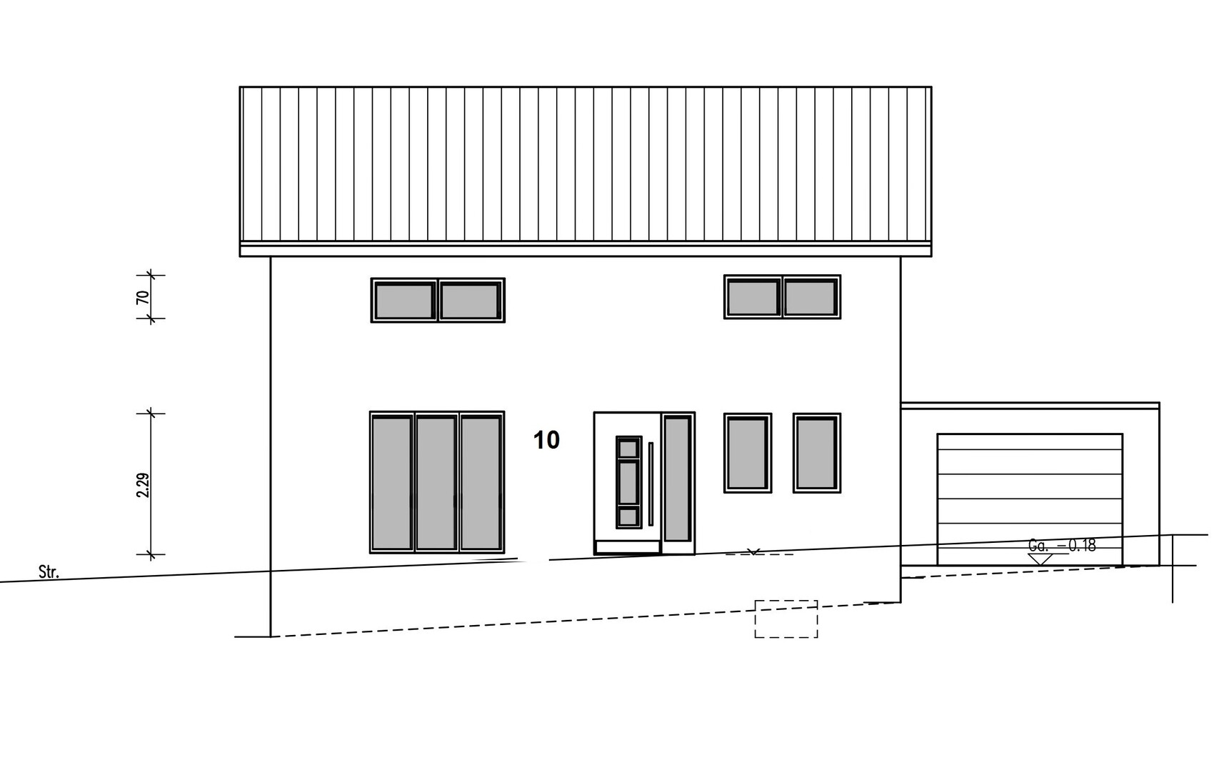

Watcher7810 Nov 2015 08:59Ok, I think the window sizes should work for us as well. In the living/dining area, we have 2 x 1.51-meter (5 feet) floor-to-ceiling windows plus a 2-meter (6.5 feet) patio door to the front terrace and a 3-meter (10 feet) sliding door to the balcony at the back. I will take another look with the windows mentioned above...

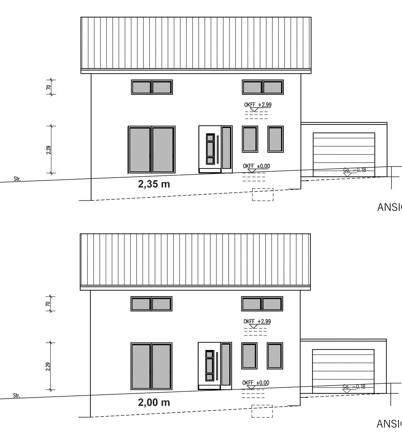

Watcher7810 Nov 2015 18:36I need to bother you again. Our front terrace door is still bothering me. At the moment, there is a 2 m (6 ft 7 in) terrace door planned there. As an alternative, there is a 2.35 m (7 ft 9 in) terrace door, which I prefer in terms of size. The disadvantage would be that the upper window (light strip) is not supposed to be enlarged. I think 2 m (6 ft 7 in) should be enough there. Do you think it stands out a lot if there is 17.5 cm (7 inches) more space on each side compared to the upper window, or does it look visually awkward?
I tried to compare it in the screenshot. What do you think?
