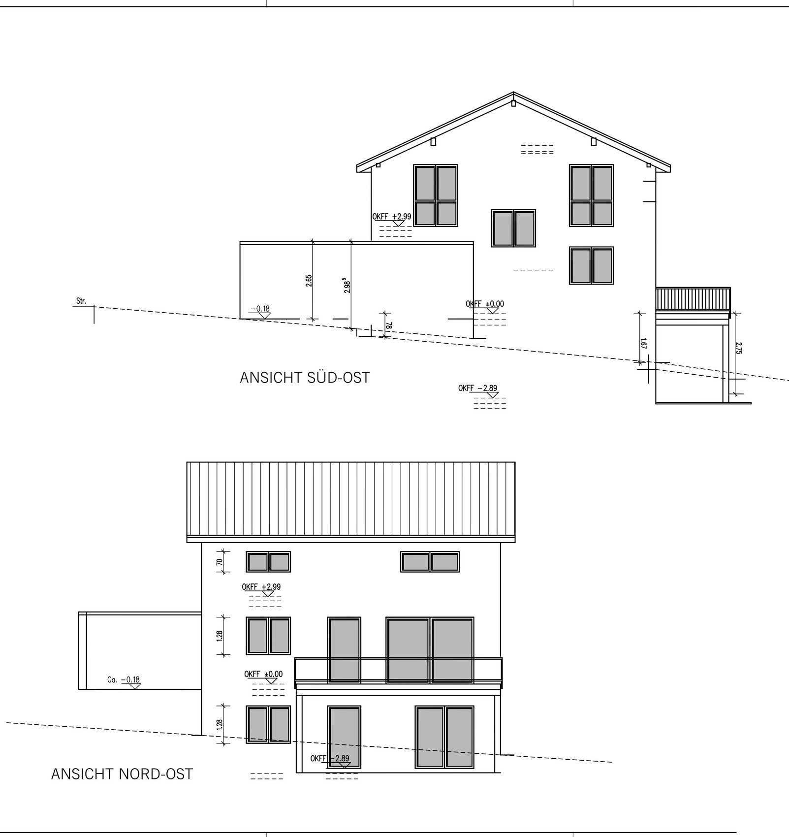

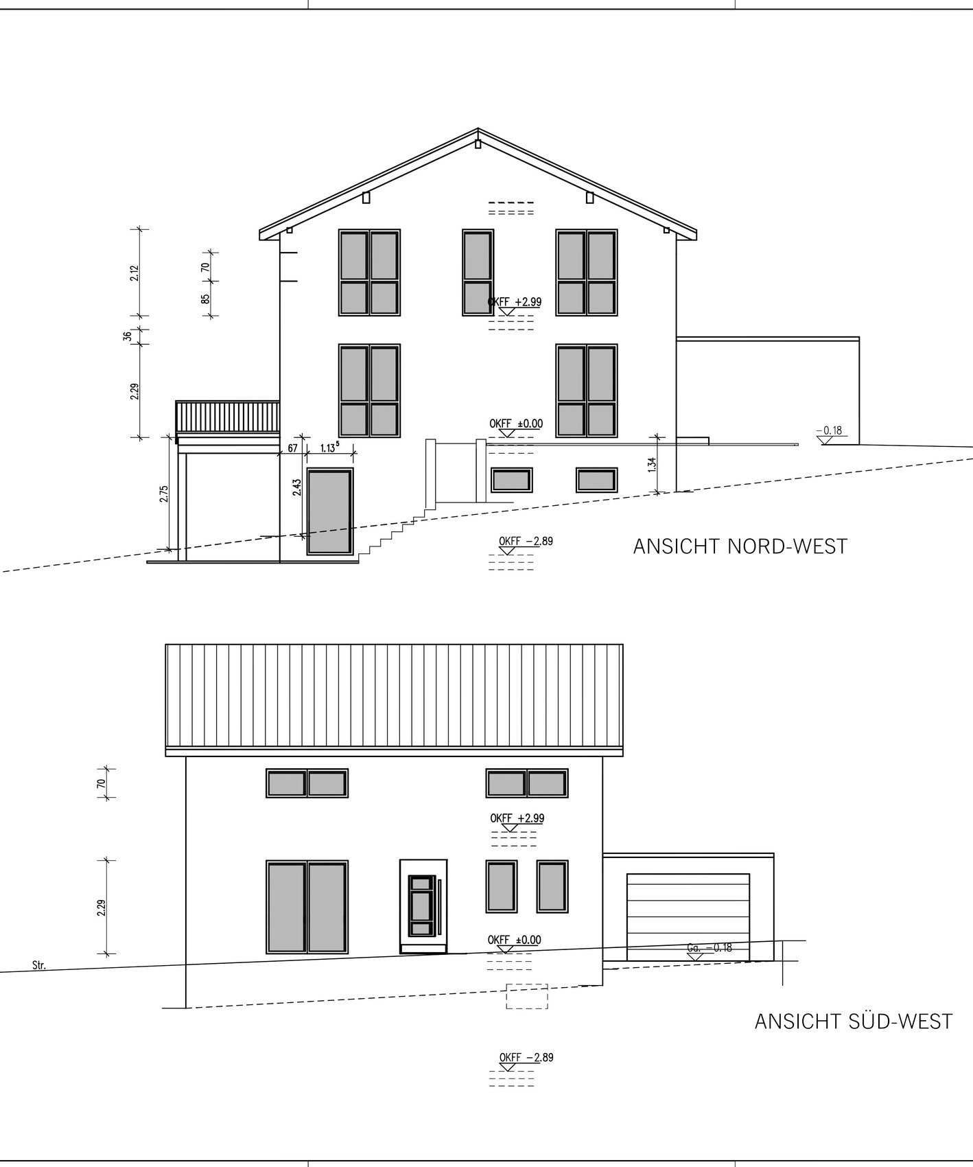

Watcher786 Nov 2015 19:15Here are our revised elevations again. I would have preferred the front of our house to be a bit more symmetrical, but unfortunately, that’s not possible. For example, if you move the left row of windows further to the left, there is less space for the sofa, and you wouldn’t be able to exit the terrace door as comfortably. I think it looks a little asymmetrical now... or do you think I am overthinking it?
What are your thoughts on the elevations overall?
Watcher787 Nov 2015 16:02Does anyone have an opinion, or is my concern about the front elevation just imagination?
Watcher789 Nov 2015 11:47Hey, thanks for your feedback. I think sometimes we just drive ourselves crazy.
I would have liked the patio door to be wider at the front; we initially had it at 2.75 meters (9 feet), but then extending the window above it to match doesn’t really make sense visually.
So now it’s a 2-meter (6.5 feet) patio door plus a 2-meter (6.5 feet) fixed transom above. Going forward, you could still consider making the patio door 2.20 meters (7.2 feet) wide and keeping the transom at 2 meters (6.5 feet). I think the 10 centimeters (4 inches) difference on each side wouldn’t be very noticeable right away. On the other hand, the question is what would an extra 20 centimeters (8 inches) on the patio door really add? Oh man, this is all so complicated...
